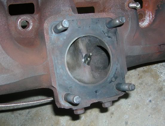

I ported my exhaust manifold & bead blasted it. I decided to run a MDC Ball Bearing CT-60, so the port work should help lower the spool.....

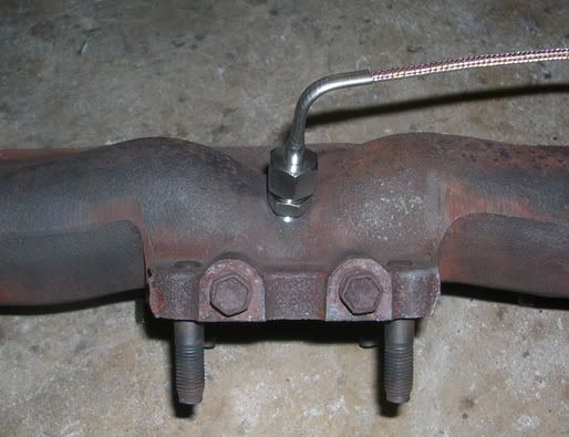

Just a suggestion (dosent look like you've tapped for EGT yet). Since you've got it out, and have modded the the "wall" already, You could easily tap the mani like I did. It works great for an over all temp instead of just going off of #6. Again, just a suggestion.
EDIT: how do you post as a thumbnail?
