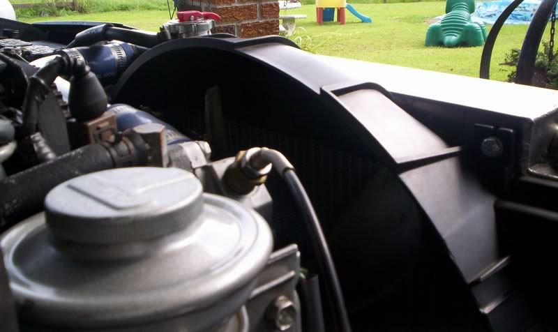

This is the clearance from the fan shroud all way round.

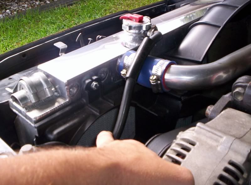

Bolt holes for the aux fan which I don't have in currently.

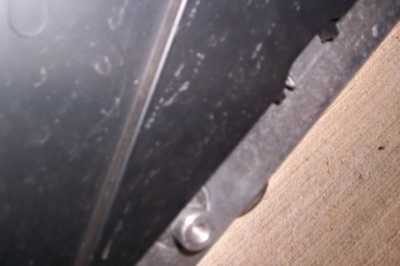

Bottom aux fan bolt hole. sorry for the qaulity cramped space
and a top pic of the radiator.

The problem is that the radiator looks to be an inch thicker then stock, so it puts the shroud too close to the fan. The only way I could see that working is with some kind of custom fan.
