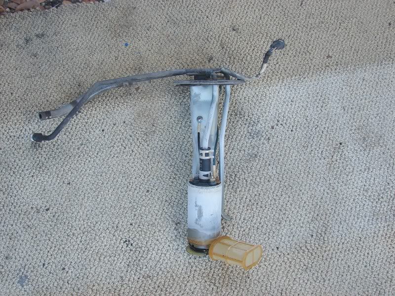

Another question! I hope this thread helps others in the future....
I got my new hanger today, and noticed something I haven't seen in any other thread/pic. What is this blue wire on the back of the hanger? From FT's pics, it looks like the short black wire on the front of the hanger connects to the black Walbro wire, and the long blue/green wire from the top of the hanger connects to the red Walbro wire, but what does this do? If nothing, is it OK to just leave it hanging there? Thanks
PS. Sliding that little metal retainer onto the fuel filter is just about the most frustrating thing I've ever undertaken.

^^^ Those would be your power wires for your fuel pump. Better hook both of them up to your new pump, or your new pump won't work. ;)
...it looks like the short black wire on the front of the hanger connects to the black Walbro wire, and the long blue/green wire from the top of the hanger connects to the red Walbro wire...
You are correct. The short blue wire is the ground, and where you connect your black wire to. The long blue wire is your +12V, and where you connect the red wire to.
I'm a bit confused...you said I was correct in saying the black Walbro wire connects to the black hanger wire on the front, but you then say the black Walbro wire connects to the short blue hanger wire on the back? I have 3 hanger wires...black, long blue, short blue, and 2 walbro wires, black and red. I understand having power and ground wires, but when its 3 versus 2 I'm at a bit of a loss.
This would help me...I've numbered the wires I have to connect, pairing them up would help!

I am pretty sure the 1 (blue 12+) wire goes to the red on the pump, then black and short blue with black box (resistor?) go to the black on the pump. If I remember they need to be spliced together.
Someone correct me if I am wrong!
GL!
Thanks very much. I figured this is what deabionni was saying, but I don't see any mention of splicing the two together in any install guides, which left me confused. Can anyone else verify this?

ForcedTorque;1073400 said:
Mine only had 2 wires inside the tank. I don't remember any resister. Can anyone explain what it is for?
Damn...I was hoping you'd know:icon_razz
Perhaps, if its not to be used, I can just tape it off and forget about it? Someone in here suggested it has to be spliced into the black hanger wire, but I know in your install (and Shaeff's I don't think mentioned it), you didn't have to do such a thing.
I'm a bit confused too. My hanger only had two wires (didn't see a black wire in your first pic), so installing my Walbro was pretty easy.
