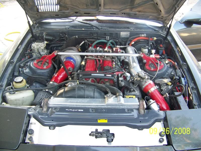

I want to share with all of you my new project for my MKIII ’91 auto supra.
Because the lack of near by Performance Shop and reliable technicians, I begin my performance shop PTR, I’m only work in week ends so it’s Slowly but surely.
Let’s begin
My supra MKIII Auto 7MGTE
Stock Engine
Stock Turbo
550 RC injectors
Walbro fuel pump
Lex AFM
S AFC II
NOS and Water injection.

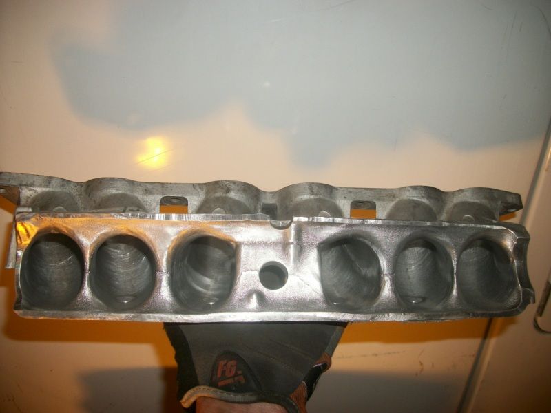

Now the interesting part of the treat :naughty: Installing a 7M FFIM
In the past, I pay to build a FFIM, so its time to do it my self, but of couse will be better :evil2:
The diferent from the old set up:
The new set up , dont need an alternator bracket :naughty: or remove the AC
let begin!
Remove Intercooler piping of 2.5"
Remove the out let piping of the turbo, and the down pipe
Let;s begin the building :icon_bigg
Some parts of the procces:
Remove Upper plenum
Taking some measures
Cuting procces!
Because the Q45 TB falge for me is expensive ( $35 + tax + shipping) I think its better if I builded :naughty: the Q45 TB flange
Upper manifold
After clened!
So far so good!
Lets see the clearance with the alternator
By the way, I’m also working in the rebuild of a Friend 7M engine, so lest try the FFIM in his engine :evil2:
Have good clereance and a good room for the alternator belt ajustment, and the more important, with out aditional bracket :naughty:

Looking good. Im just about to have my FFIM welded up.
I cut it way lower to fit a 4" tube, yours looks a bit smaller?
But you didnt have the hassle to fit a new bottom to the runner and that saves a whole lot both time and a lot of grinding.
Is the q45 boost "proof"? I have a 75mm TB from ebay, think I can remember sethron saying that they leak a bunch around the axle =(

that was my first supra :D with the old set up, in that one I use a alternator bracket.
The thing I have yet to figure out is how to connect the trans line-pressure cable to the TB, any ideas? TB to pedal cable a camry V6?
suprafredde
Actualy its a lot of job, but I think the its better from my point of view :p.
1.no need aditional bracket
2. no need to modify the fuel line to the cold injector
3. no need to perform a good inlet to the runners
4. have more spce from the manifold to the fuel rail
yep the pipe its 3.5" :)
because the 3" it was to small to fit in the upper runner and the 4" was to big :S
So dont have many options :S .
For the trans line-pressure cable to the TB, I put in a wot position, Don't remember well, but suppose that don’t affect the trany because its a mechanical valve, and also because i perform a shimm mode in the valve body and suppose its better have all the oil pressure for a fast respond.
Later I upload a pic :)
thats why i dont perform the FFIM before :D

arknotts;1828627 said:
I can attest to this. Mine started leaking past the throttle plate and shaft seals so much to raise my warm idle to 1400 rpm. Sprayed the inside down with some dry moly lube and it helped quite a bit.
Bla thats no good. Ill pressure test my tb before welding the flange on then.
I removed my CSI after reading a few threads here.
I allready have a alt lowering bracket and wanted to make sure nothing hits the hood.
Locking the cable at full pressure isnt something I want. No more comfy shifts at low throttle :nono:
I have also shimmed my accumulators and high stall TQ.
3.5" inst bad at all and I think you are the first one Ive seen to reuse the lower plenum part :bigthumb:
