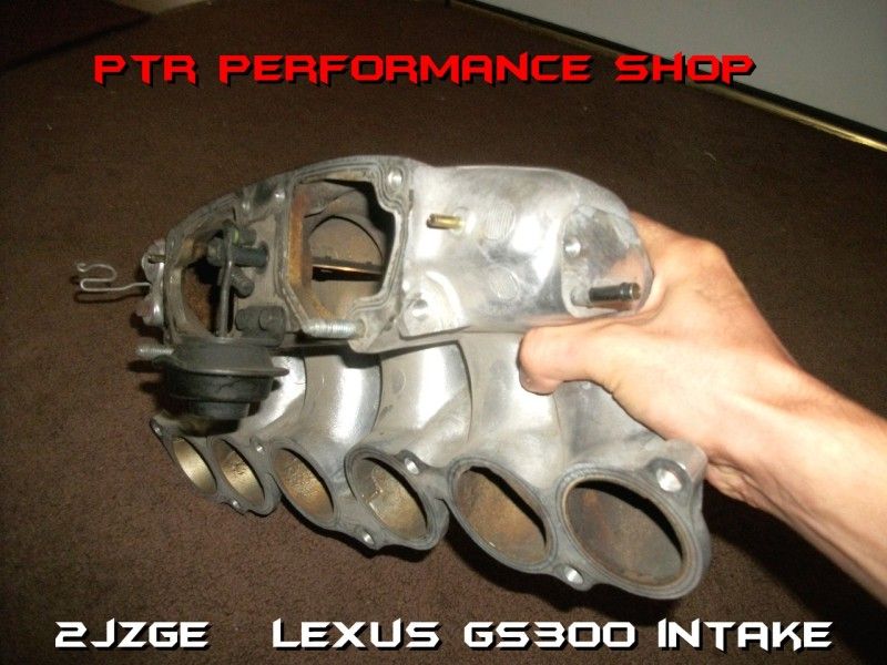

suprakidd;1830365 said:
would you be able to do the as thing if i sent you my 2jzge intake?
Yes of course, actually I’ll perform in few more weeks, a lexus GS300 2JZGTE Aristo Swap, so I’ll have the opportunity to see in the 2JZGE what to do, to perform the same kind of job :D

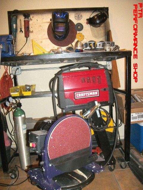

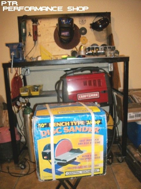

Finally, today arrive the disc sander :biglaugh:, I hope this weekend have some time to continue with the FFIM fabrication :evil2:

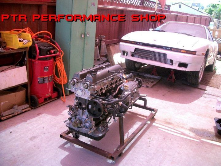

But I’m working in other supra projects ( 7M engine rebuild and a GS300 2JGTE aristo swap ) that’s why my supra project its on hold.
7M rebuild :naughty:
Lexus gs300 Aristo Swap +:evil2:
But I hope next week I’ll continue :evil2:

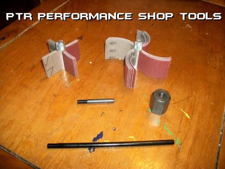

And because of the delay, I order other tools per perform a polishing to the internal runners of the intake’s, to improve the air flow
So at the end will be a excellent job jejejejej, without the need to relocate alternator or ac system

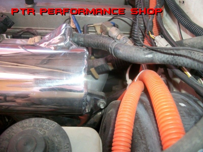

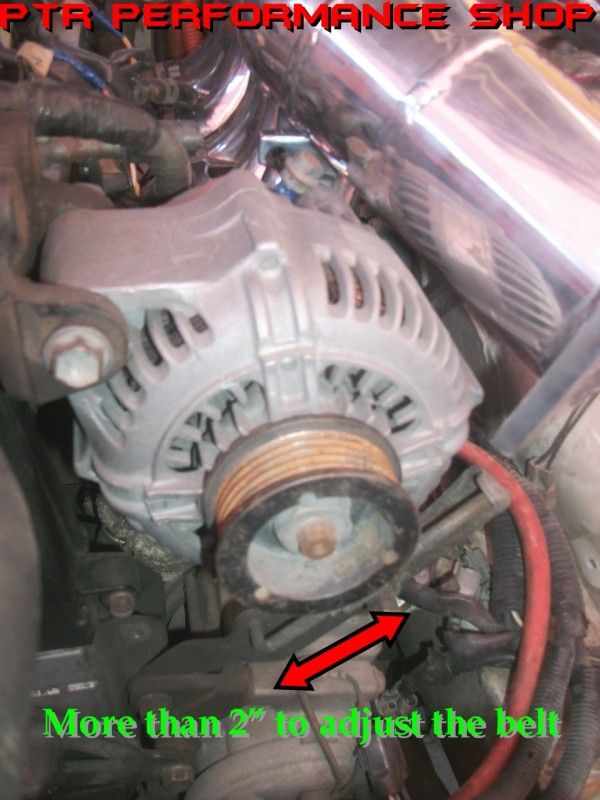

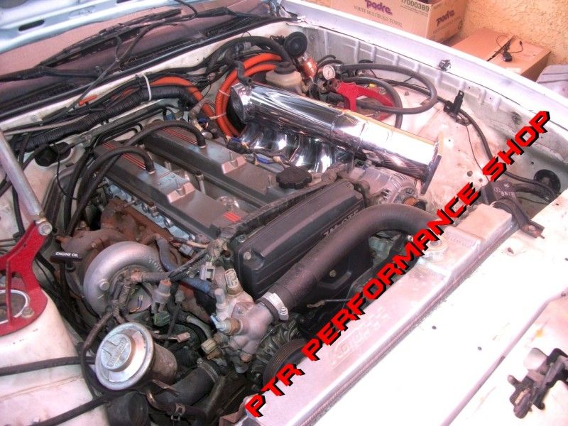

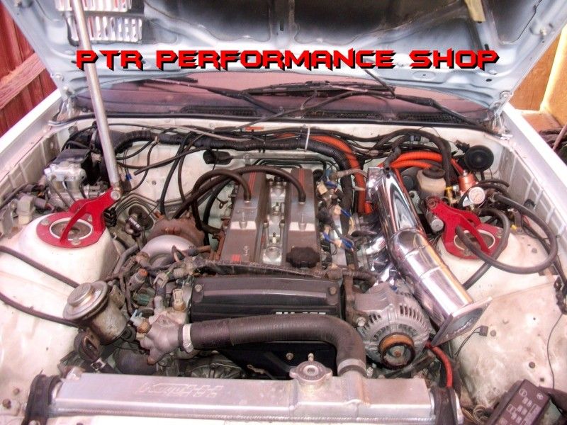

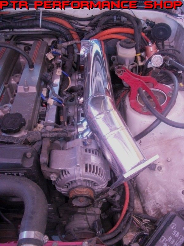

I install the ffim for the 7m :naughty:
Have a good clearance for the alternator upper connector :biglaugh: , and have more than 2 “ for belt adjustment, so I can said, Good Job :icon_bigg.
It's time to order the material for the IC piping :evil2:

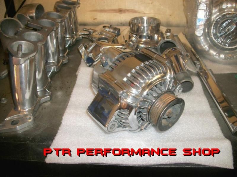

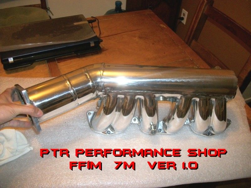

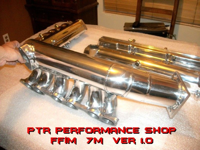

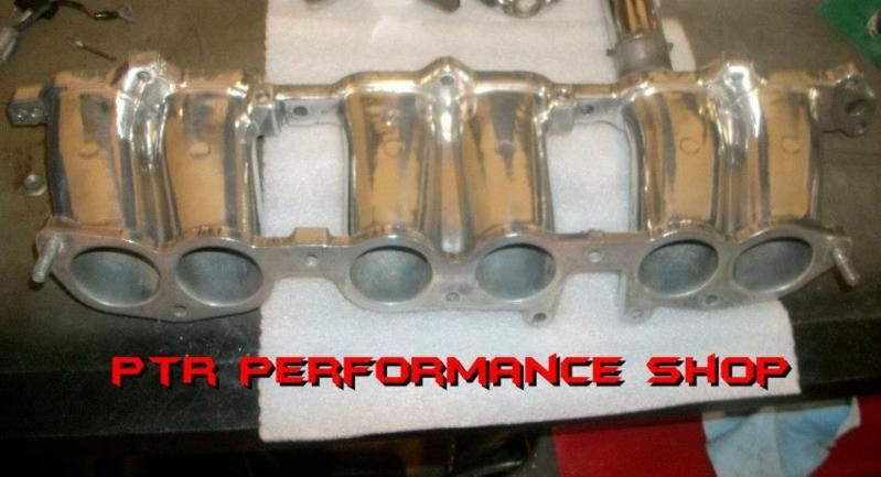

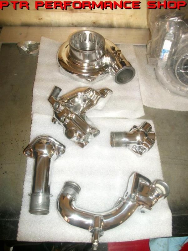

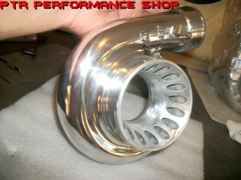

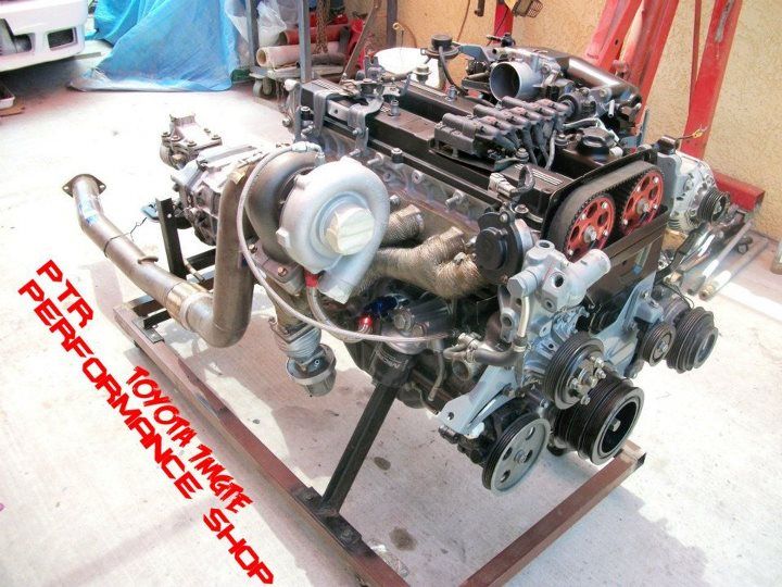

some updates :D
I finish polishing some parts :evil2:
Garret 35R, time to sawp for the stock C26 :biglaugh:
Lower intake
Some parts of the 2JZ and the 7M :naughty:
an the alternator :icon_bigg
so its time for the intake installation and order the material for the IC piping :)
