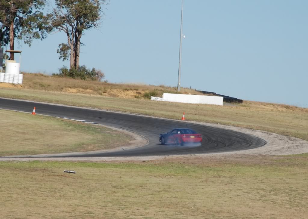

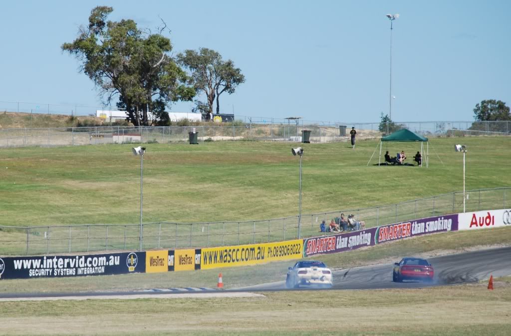

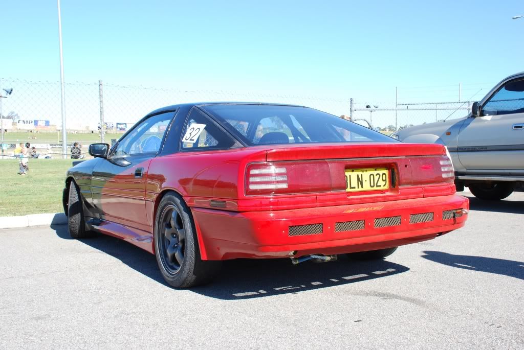

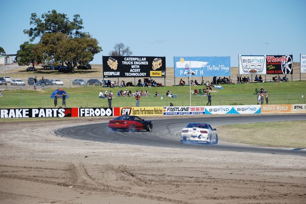

well dont have any vids but only a couple of pics my mate took
the big turbo isnt drift friendly but made the most of what i got.
was happy to stay off the walls and stay out the sand pits and the mighty 7m didnt miss a beat after sitting on 3rd gear limiter the whole day.
its 1 of the fasted tracks in australia to drift and the best drifters are lapping it in 3rd and 4th the whole time
if any better pics emerge - ill post them up, but as for now heres what i got so far

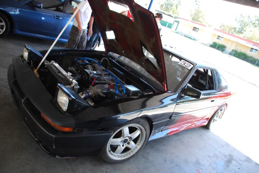

sorry dude, i struggle to get my mates down to watch let alone record anything
found a couple morepics that a photographer uploaded though unless your sick of pics
big ups to spectre of toymods for taking these
