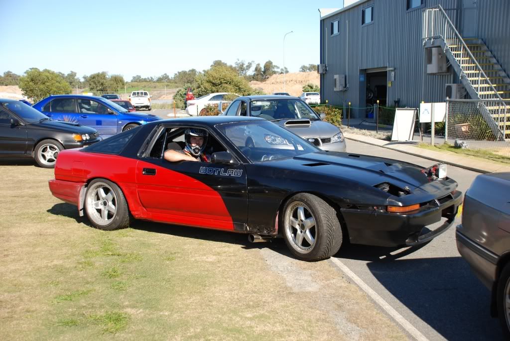

this is the state as which its at now.
im yet to hit the track with the new seat setup or with the new brake setup.
i had to take drastic measures to the floor since being 6"2, a helmet and a roll cage meant my head couldnt sit upright without touching the roll cage.
im very happy with the way it all turnout out though.
been looking at ordering a set of hoosier radials (245/295) before i hit the track next which would completely transform the car for sprint/time attack events
