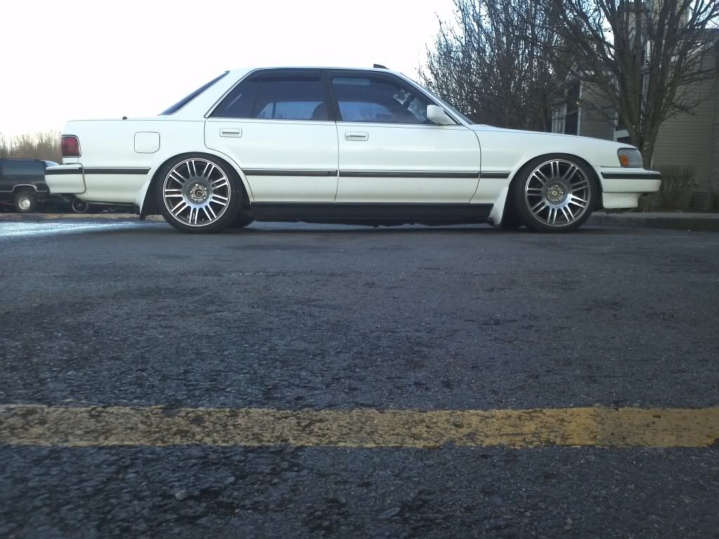

Just made a deal and will be picking up a running 7m this weekend.
It is getting pulled from this:
