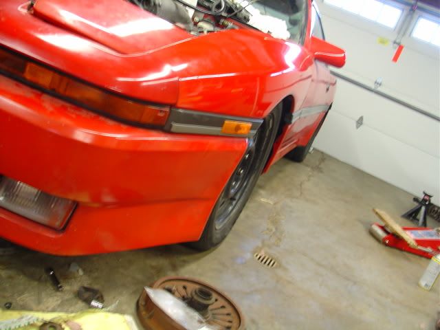

I lowered the car after it took 4 fricken months to get my springs back from the powder-coater!
It's tuckin a bit in the front and when the rears settle it'll be low there to hahaha

I need to set the perch on the D/S rear lower and also pull the D/S front shock and put the boot on there because I forgot...
But I have to lift the damn car by the pinch welds. My jack isn't low pro enough to get to the frame rails

Ask and you shall receive! It looks a lot lower in person... But I legit have to jack the car by the pinch welds now >.<

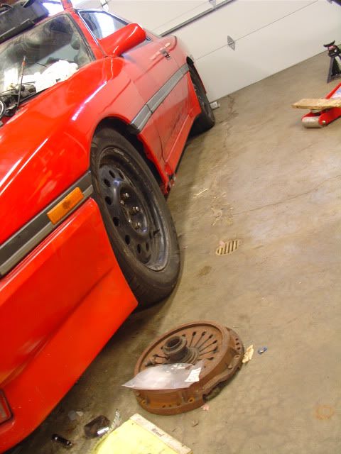

I raised up the front a little bit I hate the slammed look for my car haha
