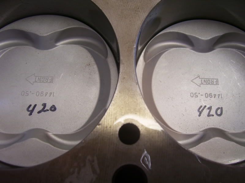

I call the probe piston an "un-finished" piston. The tops need to be profiled and de-burred. I an emery cloth wheel in a die grinder to remove the sharp edge, then I bead blast the top of the pistons.
Here is a pic of so probes I installed in a motor. You can see the sharp edges are gone as well as all the tooling swirl marks left behind by probe.
I have some +.060 wiseco pistons in stock if you need some. Just give me a pm.
