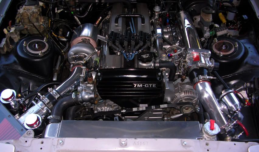

Anybody take notice the shipping costs:aigo: :aigo: :aigo: ?!?!?!? RIDICULOUS! My Ct-26 is probably heavier and costs ten dollars to ship with insurance across a few states
Edit: NVM, its shipping all the way from japan......but still, its already expensive as it is.
Here's a picture of the actuall product, notice the alt. bracket as well? ;)
Looking at these guy's website I noticed that they make an aftermarket TB in sizes from like 70-90mm's that will accept the stock TPS sensor, pretty nice to have along with the manifold, but they are a pricey piece too, but I judge the power gains to be worth it.
