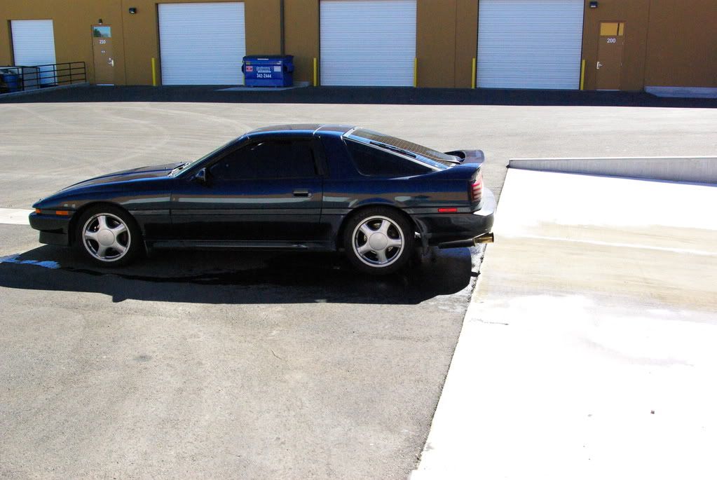

The rears are perfect without spacers... unless you like the look of your tires/wheels sticking out where they shouldn't be.
The fronts could use a spacer but the outer edge of the wheel sits right about where the original wheel sat.
Running the MkIV TT rims in the front you MAY have to adjust your turn stops to prevent a slight scrape on the inner edge of the rim at full lock. This has been shown to occur on some cars but not all.

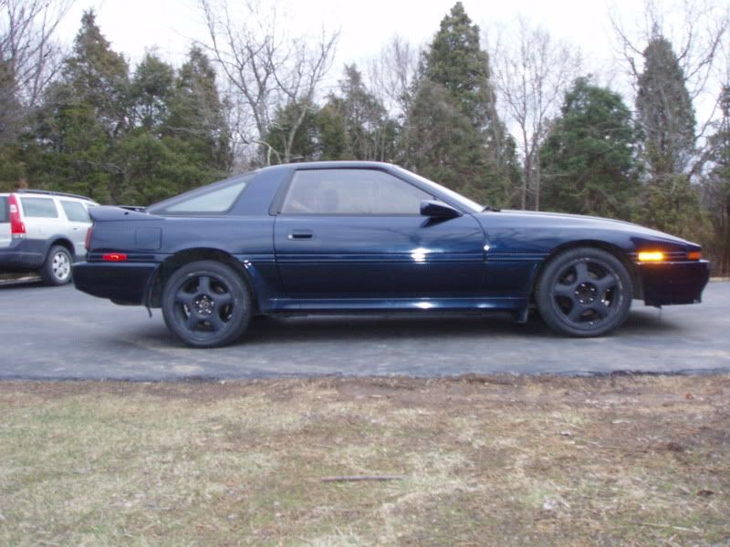

figure I would post, even though I dont have a great quality picture and dont even own the wheels anymore (some asshole stole them....and I didnt have wheel locks on them....:3d_frown: maybe im the asshole?)
I liked them alot, chrome 98tt wheels... but I have something else in store that should be interesting..... soon as I get my gremlins kicked out of the engine bay.

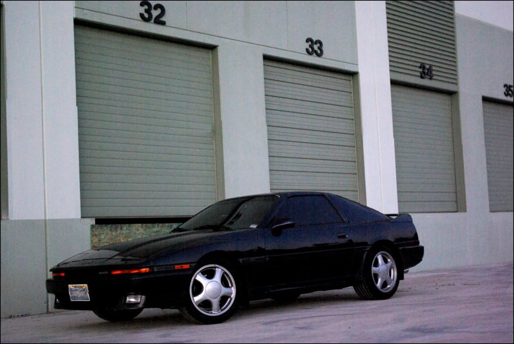

Wheel spacers upfront.

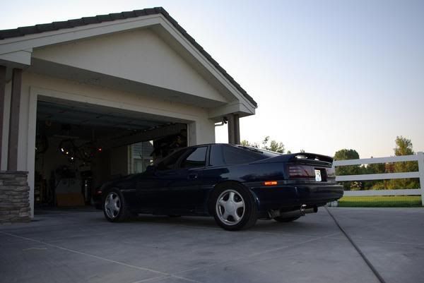

I was running 255/40 on the front, 275/40 on the rear of MKIV TT rims. No spacers. I only had to adjust the steering stops a tiny bit to prevent rim scrape. Lowered on Eibach Pro Kit and Koni Yellows.
No spacers.
