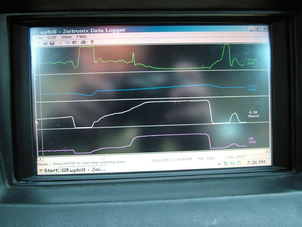

See how the graphs let you tune? You can scroll back or forward once you stop logging and use the info to adjust all the different rpm points of your afc. As you move the cursor on the graph, it gives you the number of each graph wherever you put the cursor line.

Oh yeah, UNLIKE a dyno, I can log data under different conditions too. Like going uphill or at the track. The dyno tells you what the car did on the dyno, not in real life situations. Also, your intercooler and cooling system works differently when you are driving then it would on a dyno. I would rather tune for driveability and engine safety then max power anyway.

^Excellent, but why do we keep giving logical valid points when we have no idea what were talking about.
He'd much rather have some pretty leds to point and say "look what I can do", as there's no way for him to evaluate what it is telling him, in relation to all the other information he needs to consider.
bigaaron Do you have a post/more info about that display? Any more pictures that aren't so close? That's nice :bigthumb:
edit: I found more pictures on your photobucket - Very Nice. Where is the cpu? What size screen? Where did you get it? How did you wire it in? Did you get a larger alternator? Any more info would be great.
