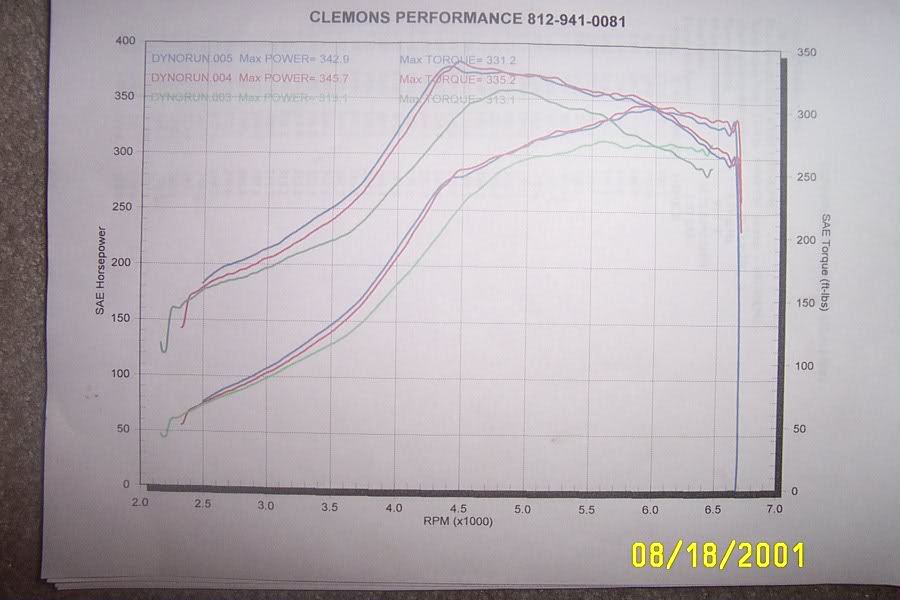

BTW: what PSI are you running on that chart?

I was at 13.5-14. The lower number (green) was with my cutout closed using the stock catback.
Based on your measurements here is how yours compares to mine.

Looks to me on your dyno sheet that your reaching full boost about 5200 or so. I hit mine at about 4400. It was 3150 with the stock CT in 4th.
Maybe someone can chime in about the effects of the different size wheels in terms of lag. I am sure I could run alot more boost if I turned it up. If you don't have wastegate issues, could it be the smaller cold size wheel maxing out maybe?

Going by my boost guage, and my EVC, Im really NOT reaching full boost until 6000+ rpm... Look at my dyno, you'll see my hp actually planes off at 6000rpm...
And I SERIOUSLY doubt my turbo has reached it's max potential at 15psi... If that's the best it can do: FOR SALE! ONE MYSTERY TURBO! MAKE OFFER!

If I go with a 58, will the hp/tq start dropping off as it peaks to red line? See Dan's dyno sheet? I do NOT want that... See mine? I DO want that... I want a table top torque curve and hp pull to red line...
On my last supra, I had that same dyno curve as Dan, it would peak and I could feel her loosing power... I had a CT26 60-1 w/ 10' clip... How big is the AR on a CT26?
