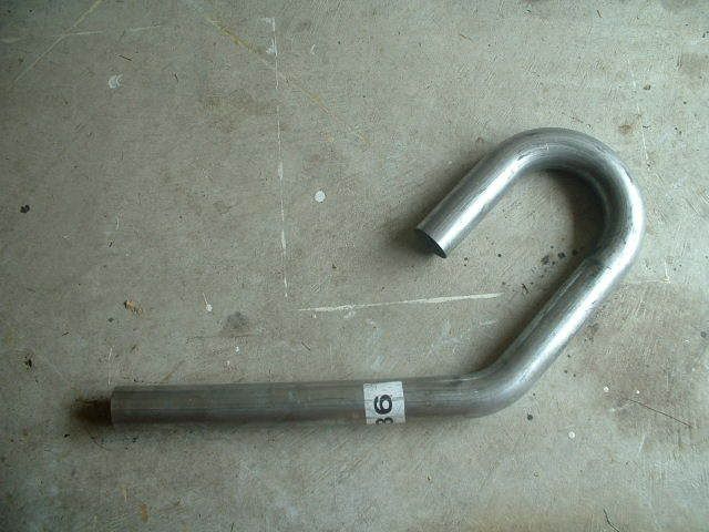

OK, more info I remembered.
The Mandrel bend was bought from ebay. The seller is performance-curve. I just put 'mandrel' in the ebay search and it comes up. They also sell stainless, mine is steel, the cost right now is $26.99 + $15 shipping. I just checked.
The Magnaflow was picked up from ebay too, I can't remember the sellers name, I did this project 8-9 months ago. I just searched ebay now and the best I found is $93 shipped. That is still a good price.
Here's a pic of the bend.

yep. I'm doing the same thing on my lincoln. I ordered 10 2.25 inch mandrel u bends on ebay for 80 bucks shipped ;)
