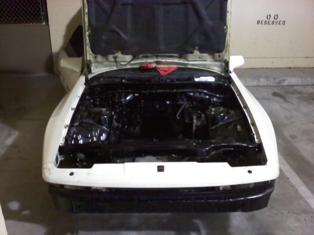

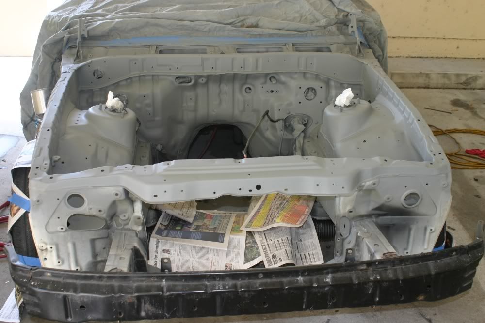

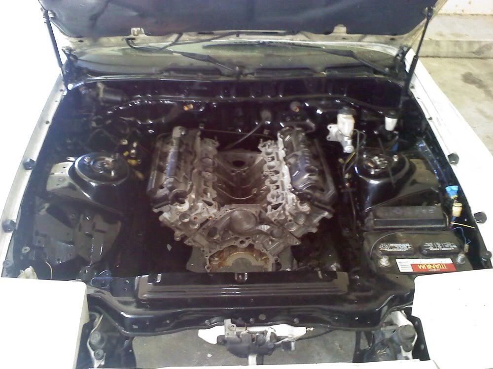

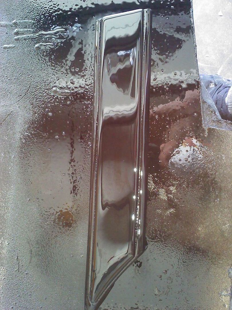

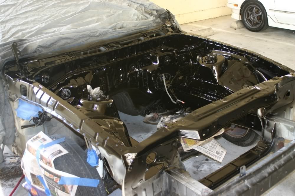

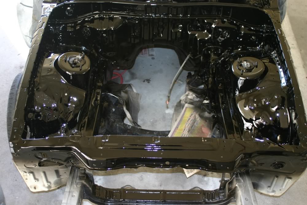

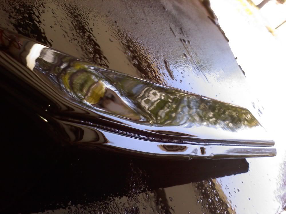

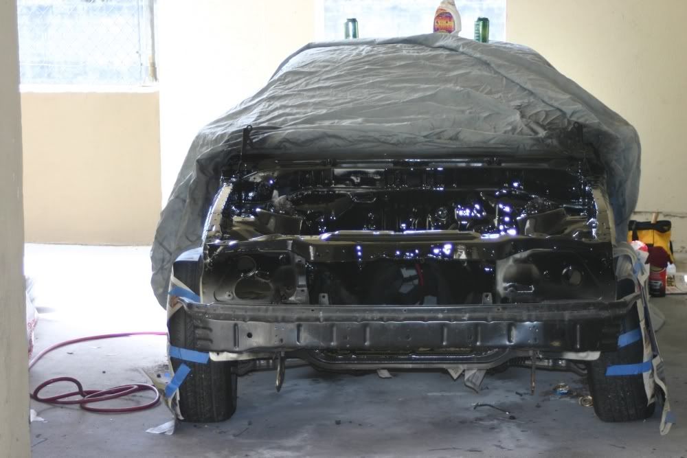

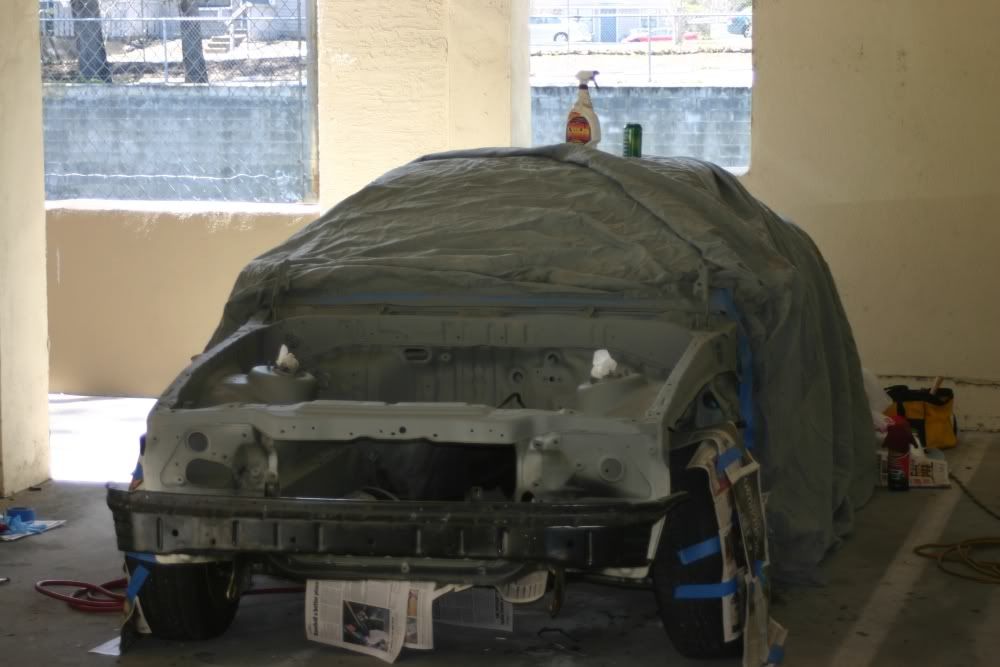

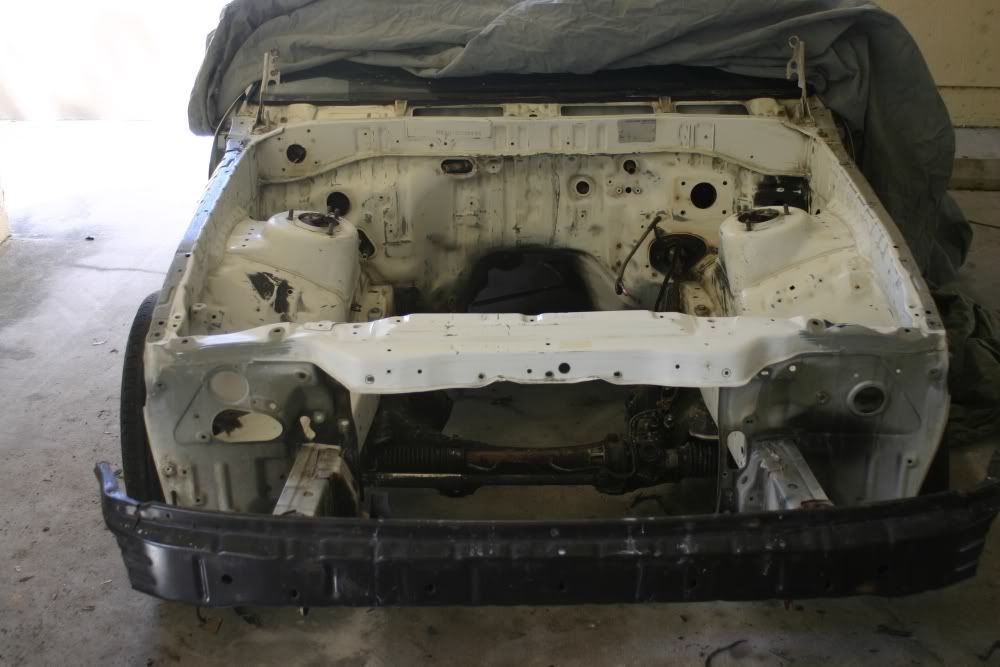

Okay this is my frist time ever shooting paint. Im practicing, but this was my last piece I did. Old pre 89 molding.
I chose NSX Berlina Black. Its really dark. So I should starting painting the engine bay sunday.
RedPhoenix
Kill it with fire!
Sep 23, 2009
222
Tampa, FL

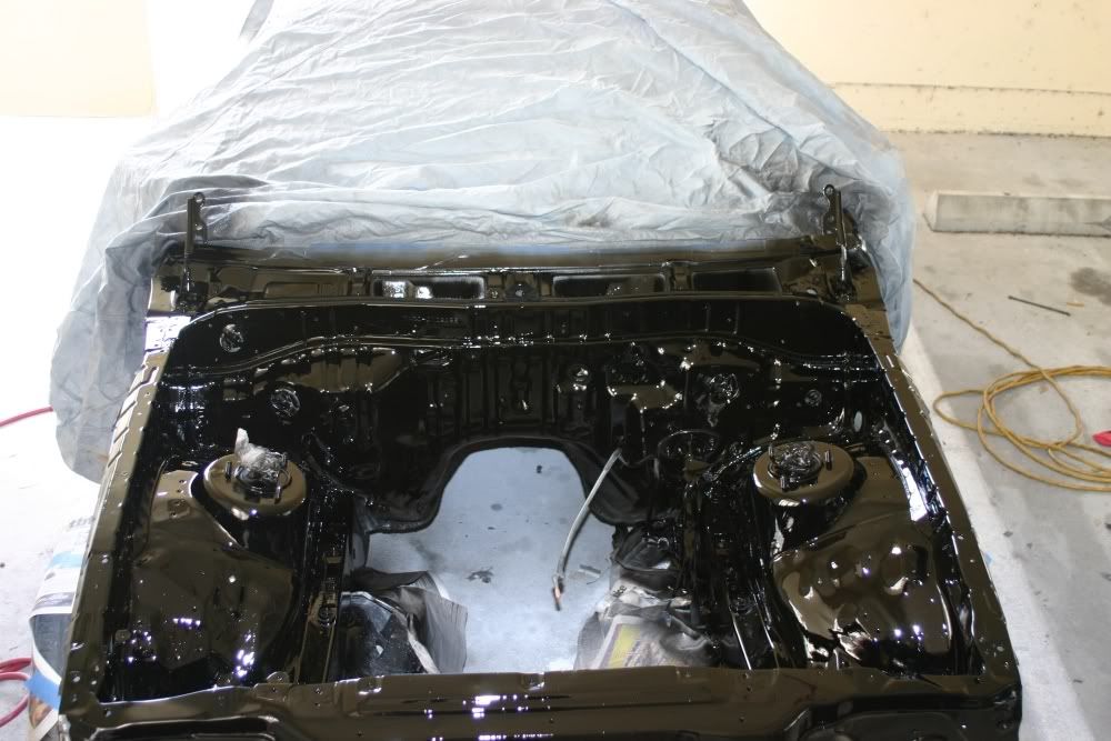

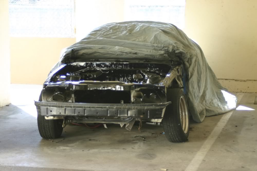

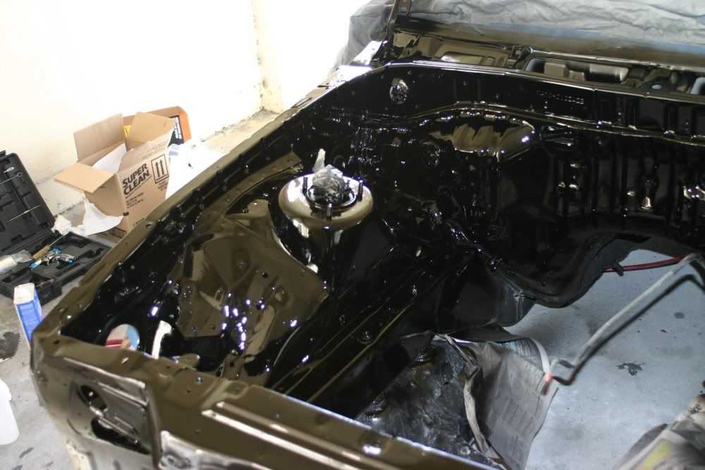

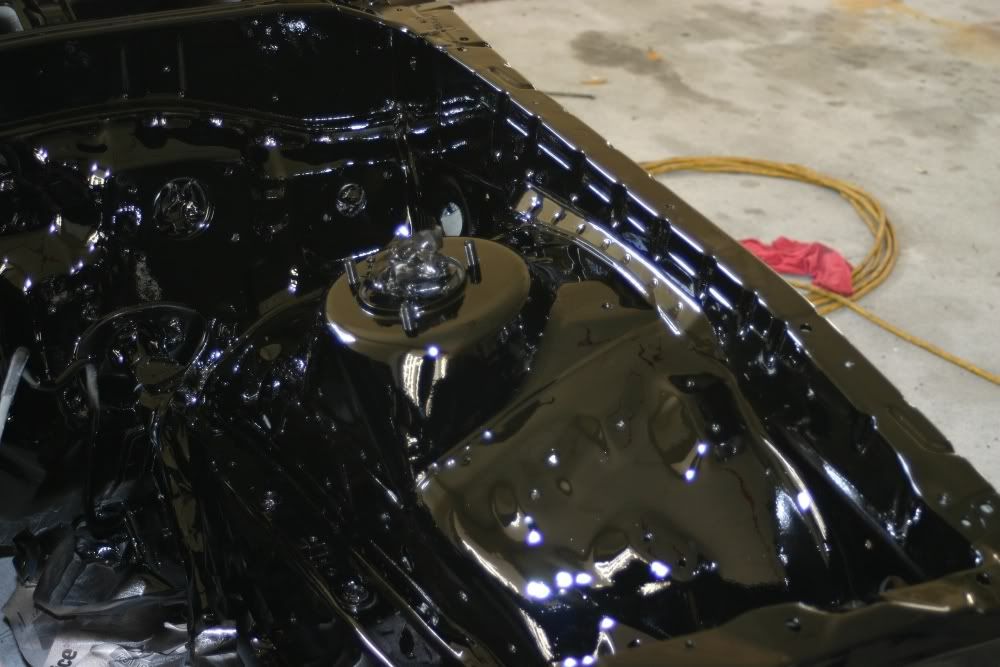

Alright here we go. Like I said, I am new at this, but 2nd time shooting paint and this is what I could accomplish. I think its more than enough for a DD beater haha. I finished last night taking everything apart around 2am. Man, it looks 2 hours longer than I thought! Some crud got on the passenger side by the shock tower. After it dries and I wetsand it, if it looks like garbage there, I will touch it up with my smaller gun.

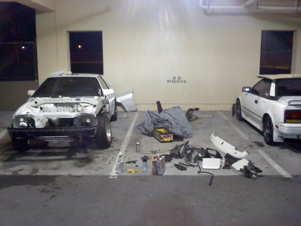

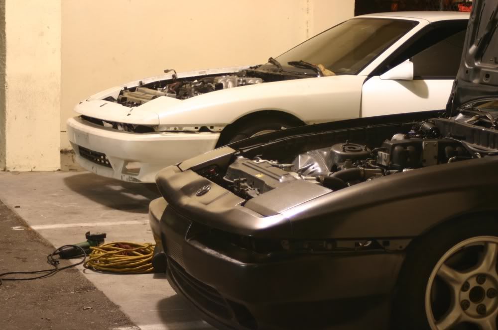

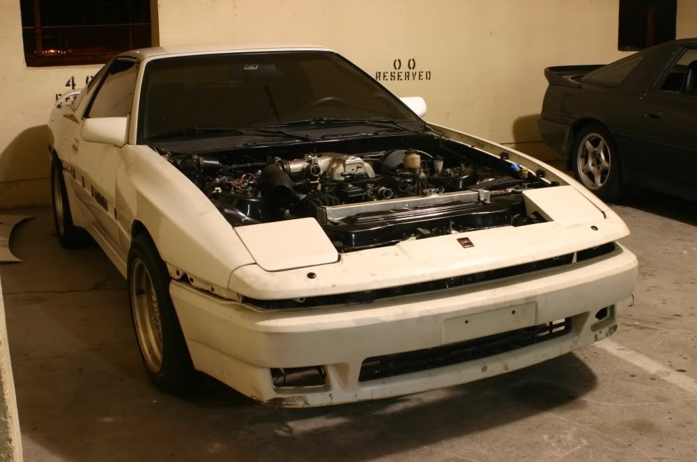

Another pic before I go out of town. Put some parts back on. Just sitting on basically. I wont crank down the bolts just yet.
RedPhoenix
Kill it with fire!
Sep 23, 2009
222
Tampa, FL

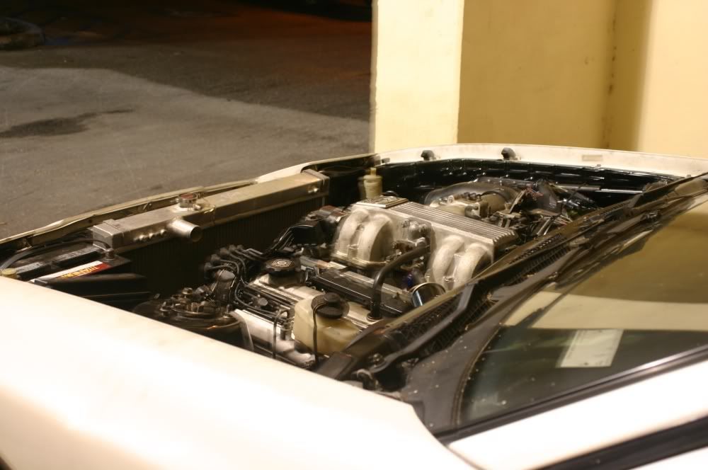

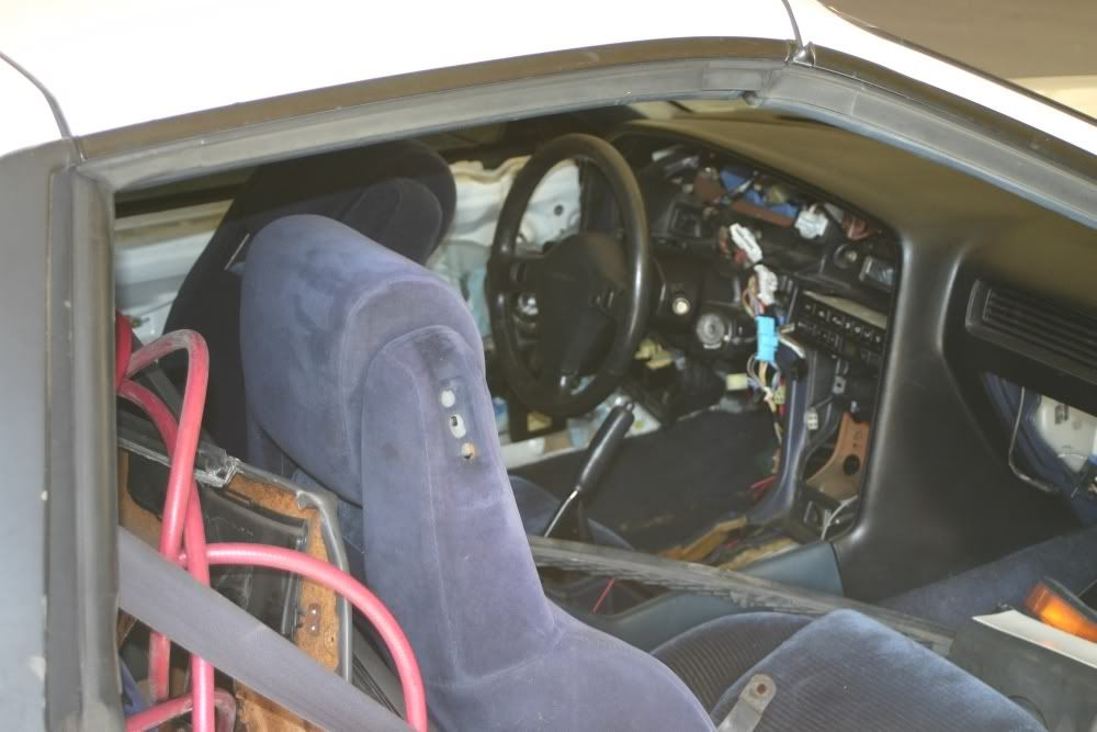

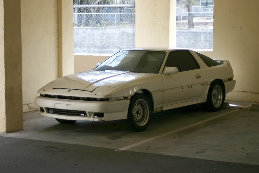

Nothing really new. Put the panels back on the car temporarily. I would say 8 bolts and a few zipties are holding the fender/hood/bumpers on at the moment. The bolts I took off were just so nasty.... I cant put them back on. Like I said, it may be my daily beater, but I cannot put back old and busted shit haha. I ordered 100 black flanged bolts (M6x1.0 with a 10mm head) for $10, cant say no to that. The interior is pretty taken apart at the moment... Everything that was in the engine bay is in the car along with my last junkyard run. This week I will be putting everything back together, hopefully.

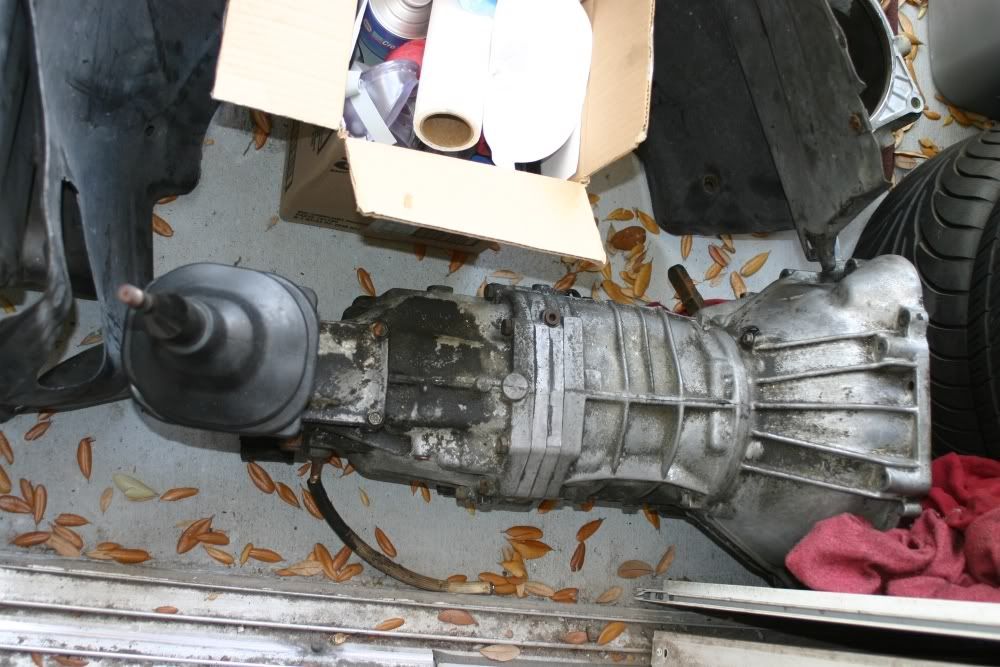

Also not like you guys have not seen one, but I got a W58 for $100... along with the cheap engine, its pretty budget. Supposed to have 110K miles... regardless, it dry shifts into gear better than the W58 in my SC400. Pretty dirty, but I will clean it up.

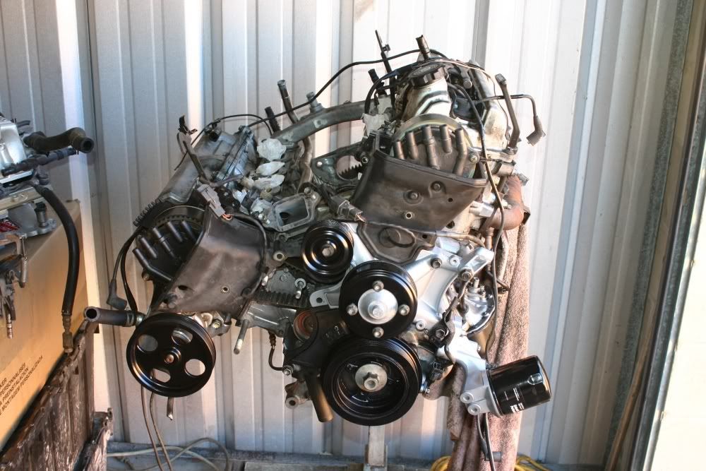

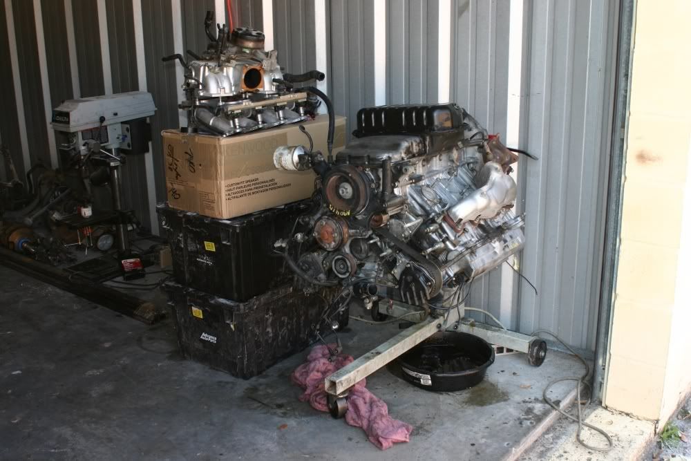

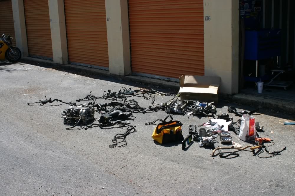

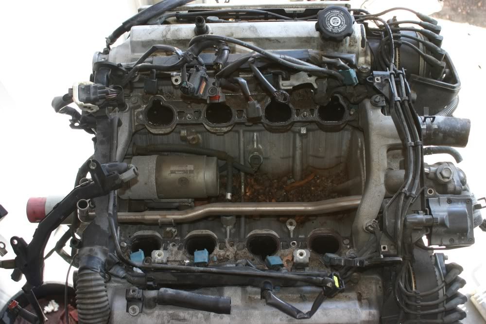

My photobucket maxed out so I havent posted anything recently...

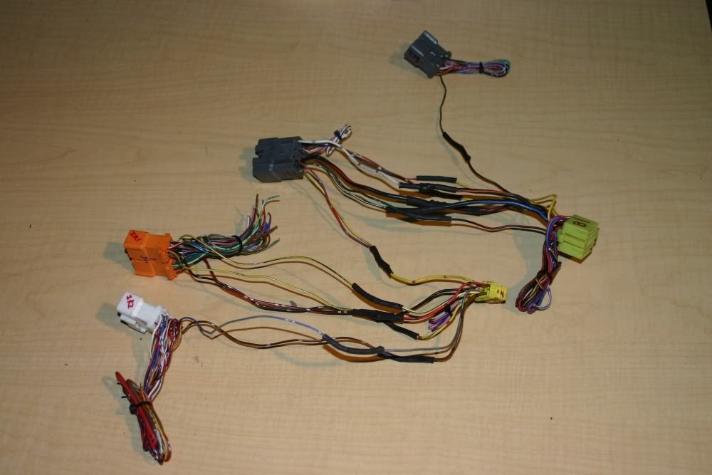

Made my patch harness for the wiring...
Still need to do fusebox side.

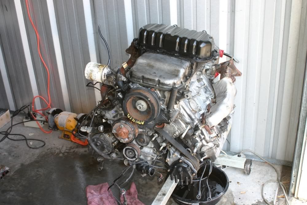

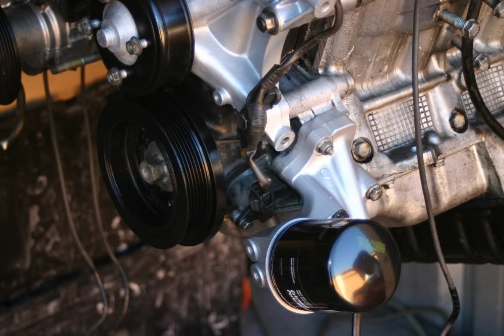

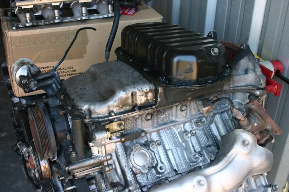

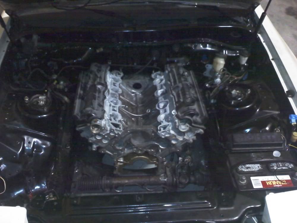

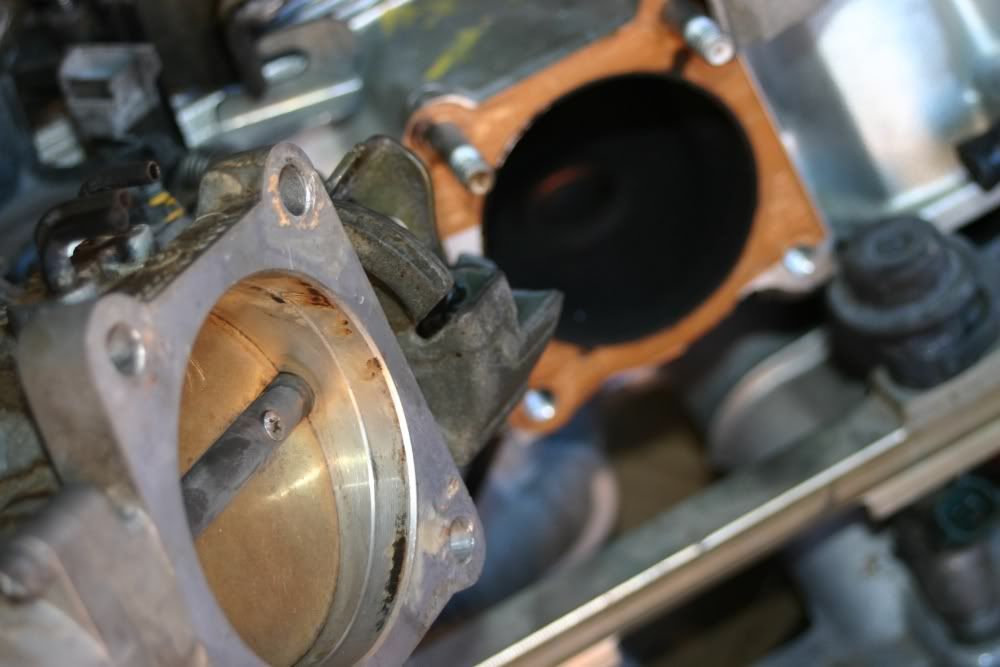

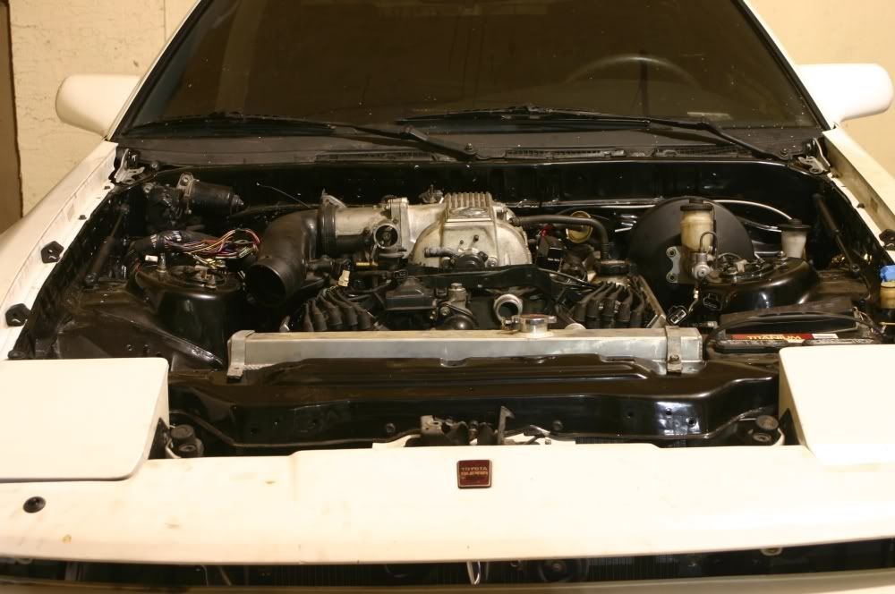

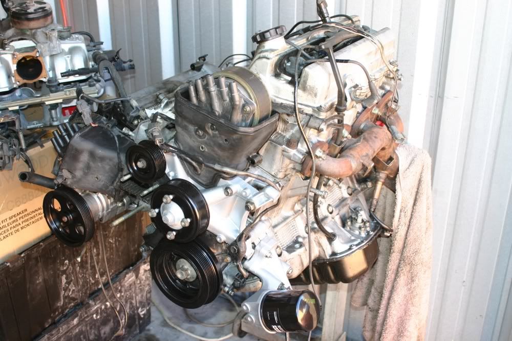

Also here is some progression of the engine as far as cleaning it up goes... Also converting from 1995 to 1992 electronics... Makes the EGR removal cake and I also have all the 1992 parts (ECU, MAF, etc)

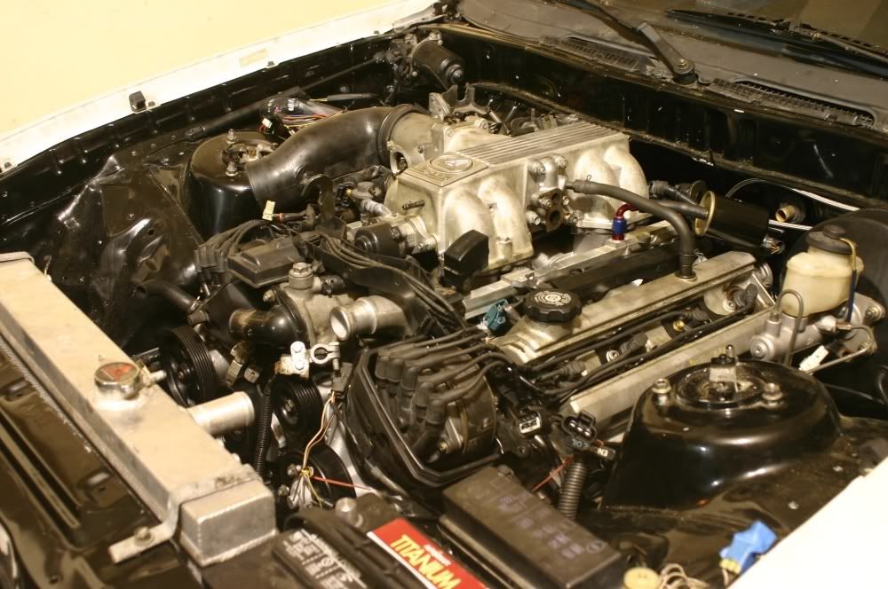

Well a bit of an update...

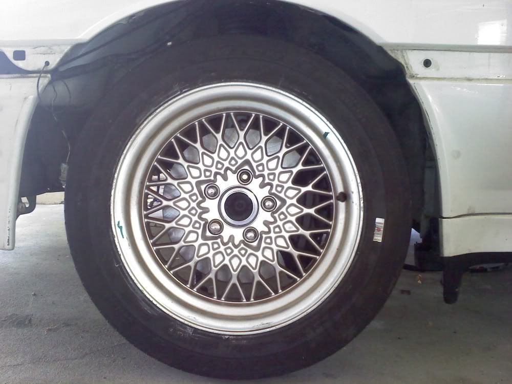

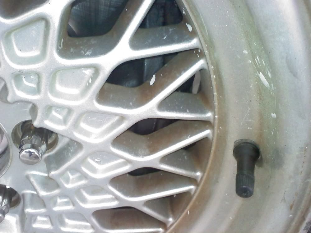

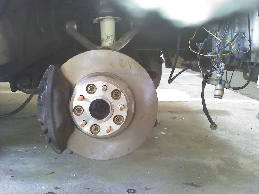

I finished all the patch harnesses for the wiring. The engine is nearly complete and ready to aside from a few small things not imperative for it to run. I installed my LS400 brake setup finally, with a 25mm spacer. It has about 1mm of clearance, I got super lucky. Although during this I discovered the driver side SC spindle was involved in an accident and severely bent, no wonder why I kept getting camber issues on that side.
Regardless here are some pics of the LS400 Calipers/12.5" Rotors behind a mesh wheel. Better pics to come, I took them from my cell.

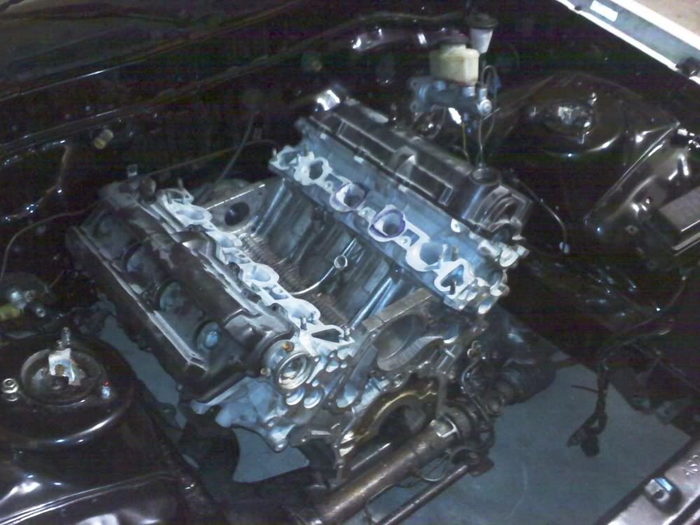

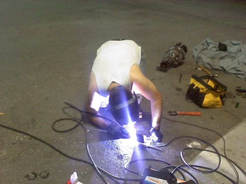

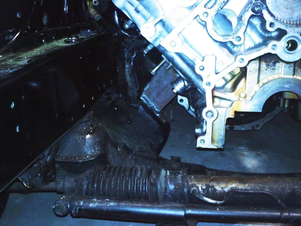

Some crude, strong and very effective solid mounts. Angle grinder and a 115v miller tig welder made them. Yes these were made in my apt complex :)
RedPhoenix
Kill it with fire!
Sep 23, 2009
222
Tampa, FL

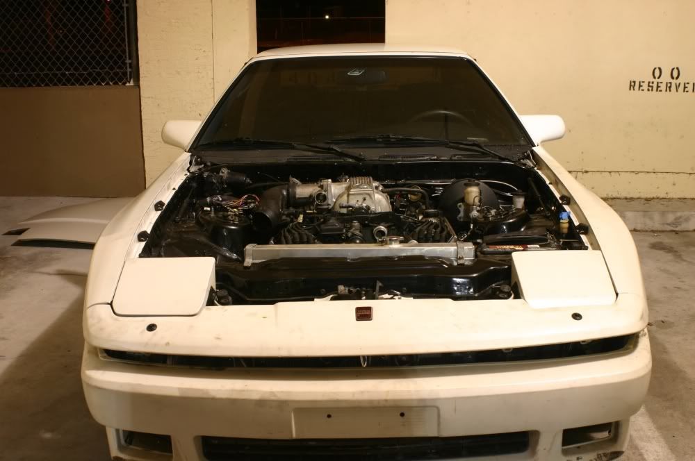

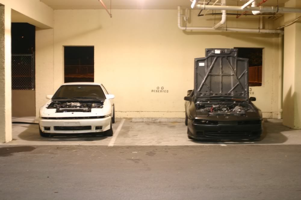

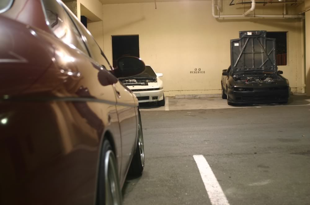

Here are some pics of tonight festivity!
Needs a lot of loose ends tied it, but that 1uzfe finally sits inside the bay perfectly!
