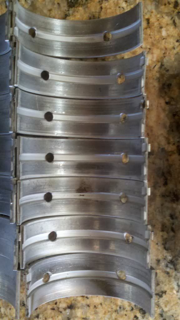

I found out that alot of people over tighten there drive belts causeing the crank snout to be pulled and desort the oil wedge at the frist main bareing some times causeing it to fail

Yep take a look at the first bearing.

Not sure what that's got to do with anything lol, but every 7M I have taken apart was showing copper on the upper half of the front main bearing right at that spot.
