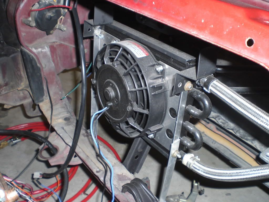

garebear1319;1439661 said:The only problem i see with the set up is corrosion over time metal to metal contact usually results in such a thing faster then just metal alone, and espcially since they are soft metals. But i mean i have mine right in front of the condensor so it goes rad, ac cond, oil cooler, intercooler and have had no problems with air flow and still get really good cooling. Good luck with this and LOL to the redneck hot tub.
IJ.;1439488 said:
IJ.;1439827 said:I use Mazda RX7 Radiator mounts, they're m6x1 studs on each end with rubber bonded between.
adampecush;1439954 said:doesn't the oil hose result in the grounding of the cooler though? Or are you using push-lok hose?
IJ.;1440233 said:Push-lock for sure
My car has the 2 Thermofans>IC>Oil Cooler>AC Condensor>2 Trans Coolers>PWR Rad> 2 Thermofans on a Falcon shroud.
