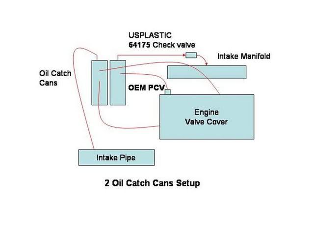

The check valve idea seems like the best solution to me. This photo shows 2 catch cans. Why not just use one? Edit: I guess this diagram is not for Supra?
Are the two breathers on the top of the valve covers the only vents for the entire crankcase/PCV system on a 7M? Or is there a crankcase vent/breather somewhere down below?
