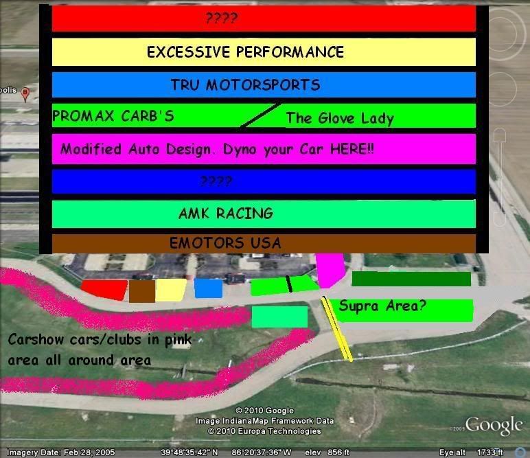

If thats the big freakin hill we were on last year, no.
Flat is better.
smokedmustang;1555490 said:
You guys like this place???

i believe the hill we were on last year was to the left of where we may be this year..... hill is in pink i think...
but i remember last year there was a bit of traffic coming and going on the road below the pink area.... will us being at the spot you designated be in the way ?
