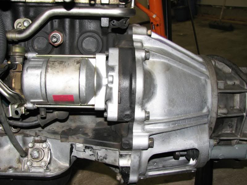

viperkillertt said:
I have a big problem also, what on earth do i use for a replacement starter. The starters in the stores are not threaded so i cant use them. I have tried a 90 starter and talked to napa about the 1994 n/a supra starter. They are not threaded. What works????
You have to use a starter from a 91-92 Supra, Cressida or a MKIV one works as well.
Okay, the MKIV and the MKIII 91-92 dont fit. THey don't have the threads for the bolts to connect to. Also they look different from the propeller shaft angle. See from the picture from Napa's website, they holes are smooth. None of the stores around here have them in stock, so i cant have them just pull them from the back room.
1991 Toyota supra turbo starter.
1994 non turbo and turbo supra starter.
Strange, I have a Cressida, I have had a 91 Supra, now a 92 , with a 1JZ 7m, as well as a 2JZ, and I had a threaded started in all of them. ( yes, I have been around)
I wouldn't trust Napa's photos since they are for Illustration only.
Either way, its good you were able to rebuilt it.

cruzinbill said:
if your talking bout a 1j starter u can just use a 2j one. both na or tt they both fit and work fine. also a starter thru ol' autozone is $127
Can we confirm this, I need to replace my starter and since the Supra is my daily right now finding time for it to be down is kinda difficult.
So the MKIV starter does work, any/all years??
i wish it could have been confirmed before i spent a week trying to figure it out. From what i dig up, they were not threaded. People have shown some that were, so i am seriously confused. The rebuilder shop had no cross match for the denso number on my 1jz starter. I wish someone had pictures of a MKIV out of the car, the ones i found didnt have threads on the housing, and required a nut and bolt.
