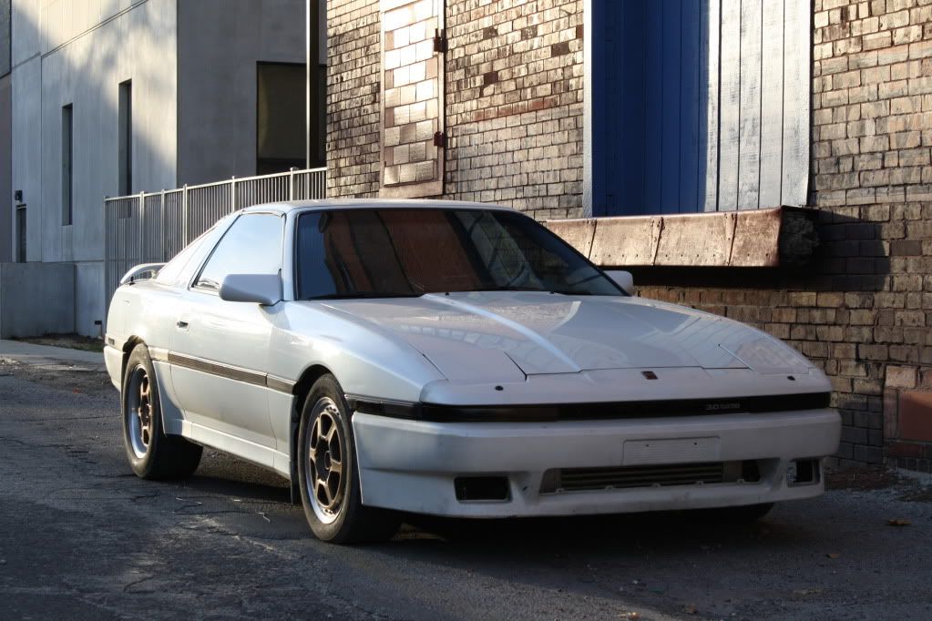

I also picked up a set of 1st gen 16" VOLK GTP's for the car
. I was getting tired of the completely stock appearance.

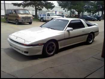

Here's the car up on our lift trying to track down a few misc leaks.

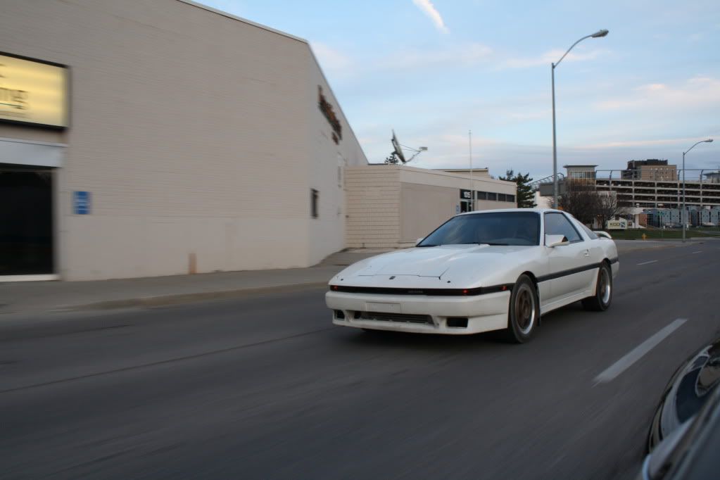

Another picture of the car right after I got the windows tinted.
I went ahead and upgraded to a Mishimoto Aluminum Radiator and a Set of flexalites shortly after.

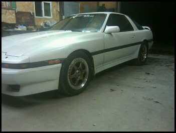

Here's pictures of my wheels after I painted them bronze.
I went with a 215/45/16 firehawk on the front and a 245/45/16 Nitto 555r. The car still doesn't hook up on the street. I have full intentions on buying either slicks or MT Street's.

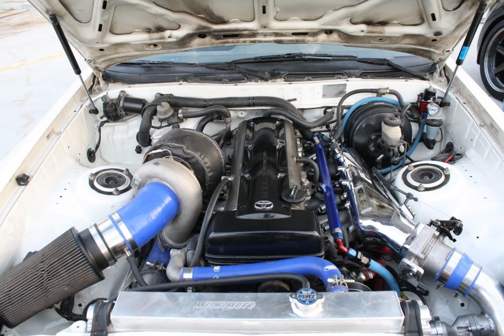

Here's the best picture I have of the engine right now:

I was really torn on what to do with the engine bay. I hate doing body work so this was my compromise. I primed the spots that were down to bare metal then I removed the battery tray since it wasn't needed anymore.
Here's a picture right after paint.
Partially assembled. I decided to rotate my fuse box so I could fit my greddy style intake manifold.
Engines finally back in the car!

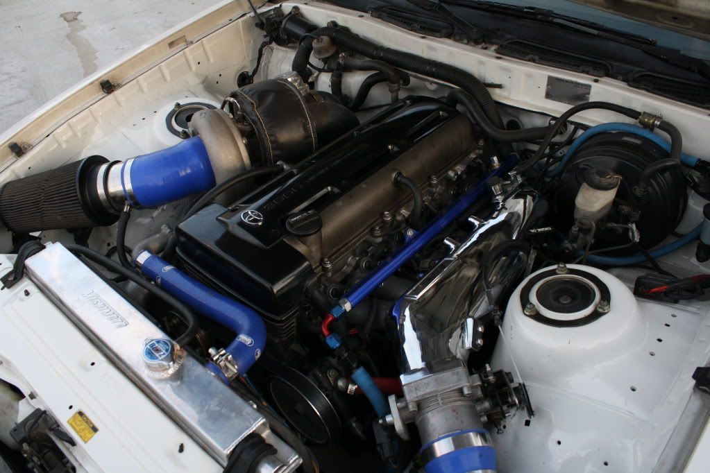

Here's the way the engine bay sits i'm still waiting on some parts. This turbo is just temperary I hope. I'm in a formal dispute with whitemike. I've pretty much all hope on getting my items. He owes me a gt4294 also an intercooler pipe. This one will due for now.
Fuel systems done. I tucked the A1000 fuel pump up inside the bumper to look stealth
