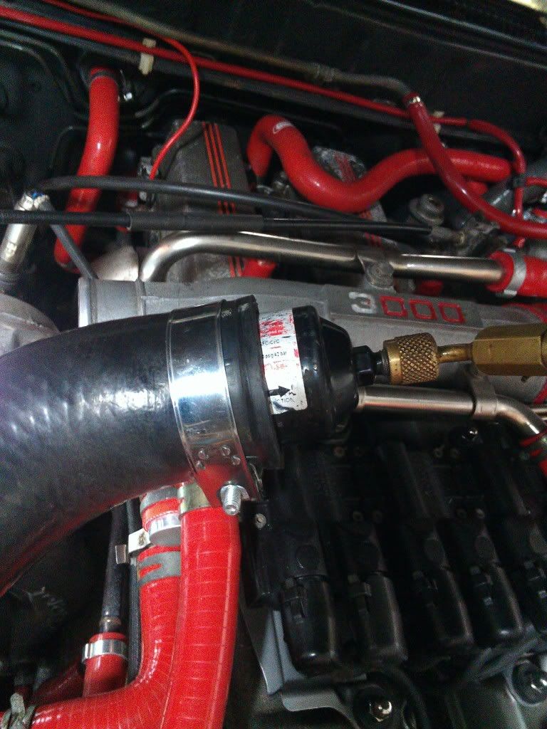

Yea, sure thing, I was going to remove the 57mm Hose (where the bov is located) and put the bung in there, and then pressurize from the coldside of the turbo.

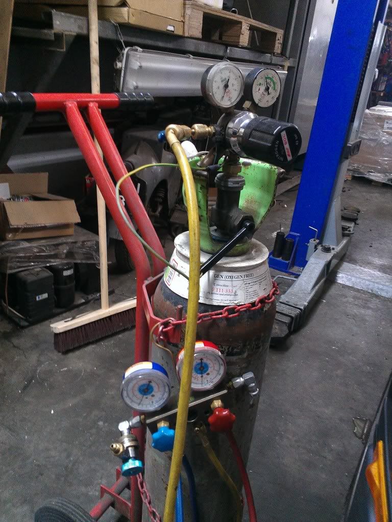

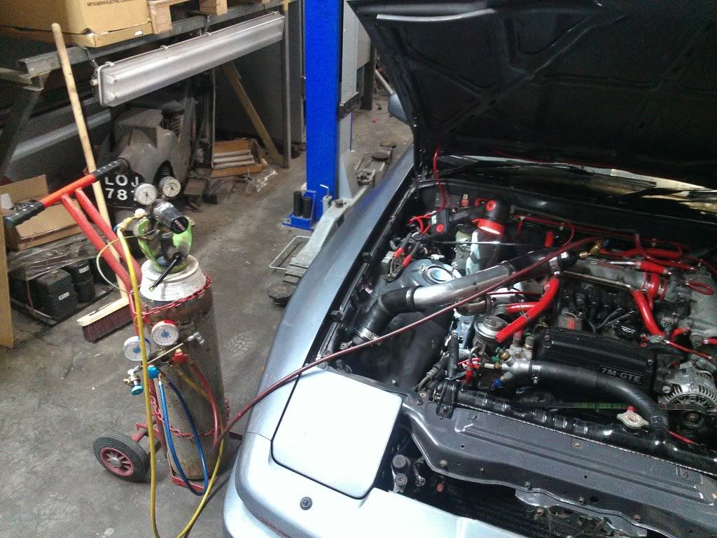

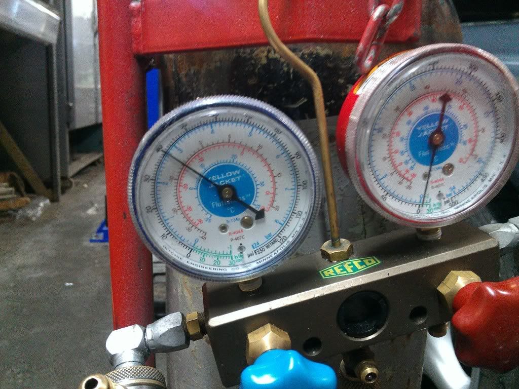

So managed to get get into the workshop this morning for a few hours to find a boost leak, nice being a Refrigeration Engineer, as I have access to certain equipment.
I used a small liquid line refrigeration drier to form a plug/bung with 1/4" fitting and then clamped it down.
I left that hose connected, just adjusted the angle:

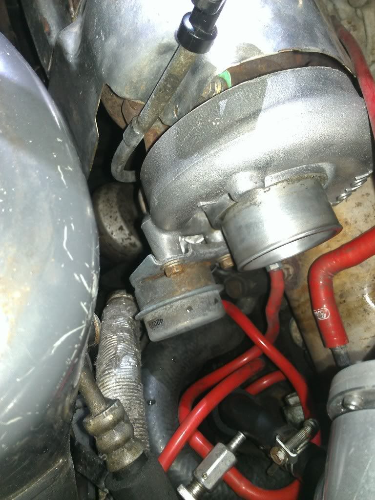

Blanked off this end (that connects to the outlet of the turbo)
Gave it the beans:

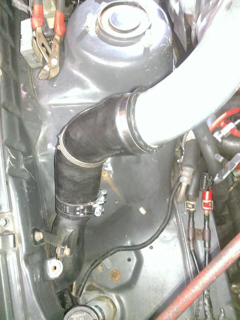

But... I couldn't put the nitro in fast enough! I didn't manage to get a photo, but did take a video of it, its the lower aluminium elbow that is pissing out.

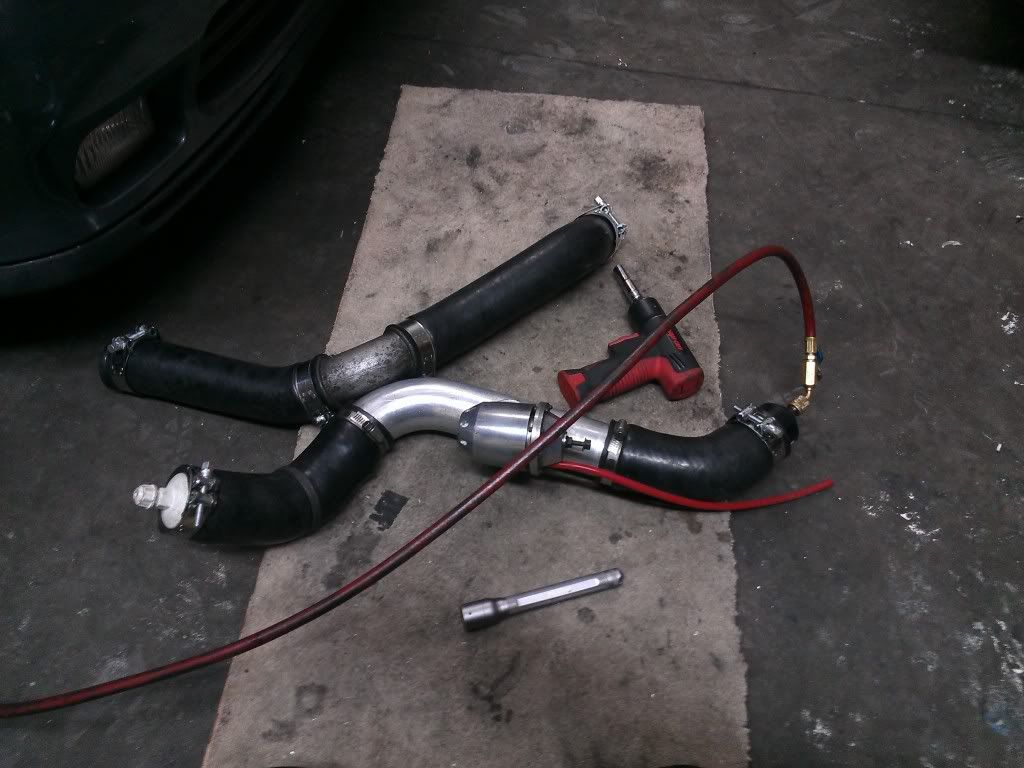

I tried separate sections of pipe with the same head pressure:
They all held great. So going to buy an after-market inter-cooler in the next few days.
