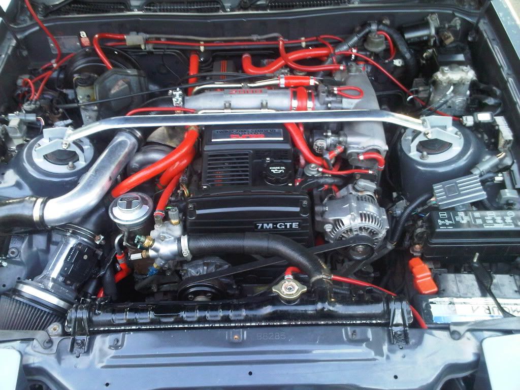

How the engine from a glance looks now:

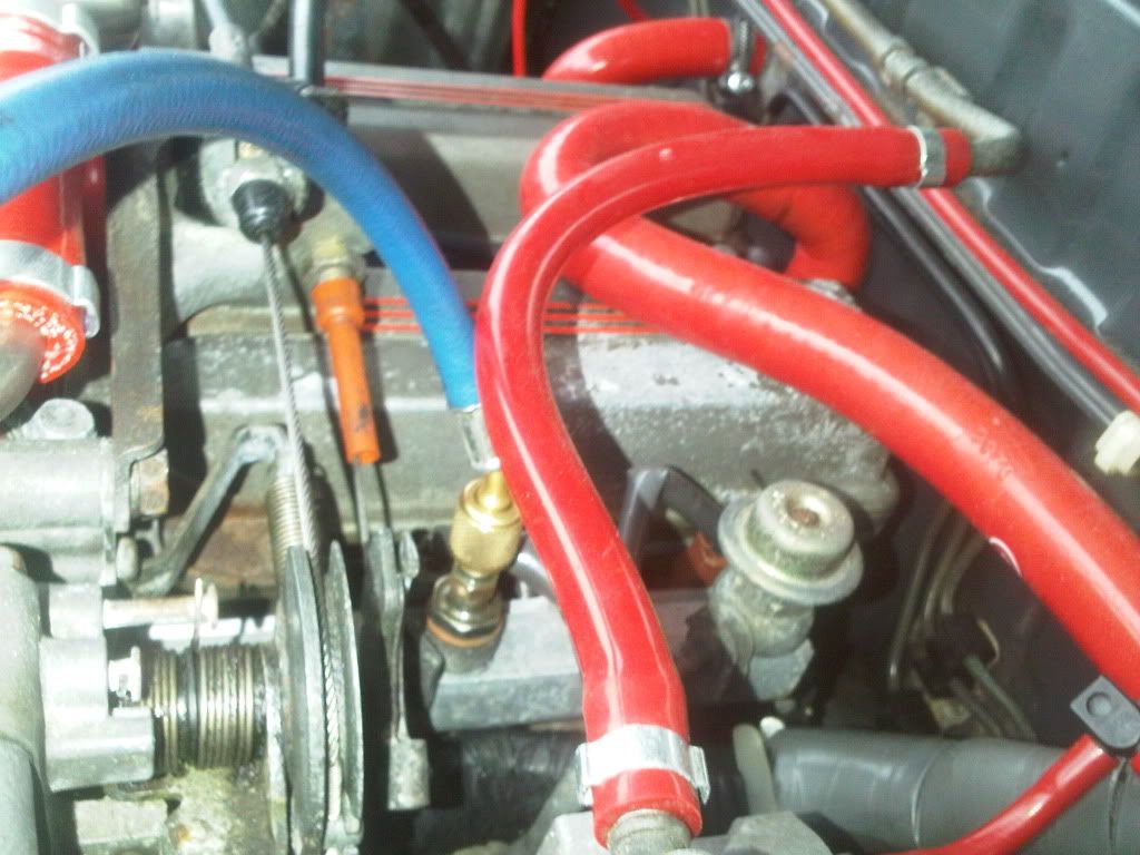

Installed a Schrader valve: (fuel Results yielded with in TSRM)

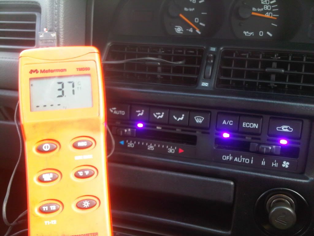

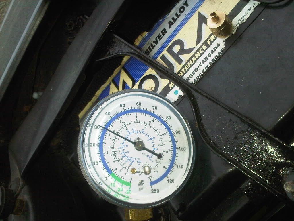

Sorted out the A/C whilst I was at it.

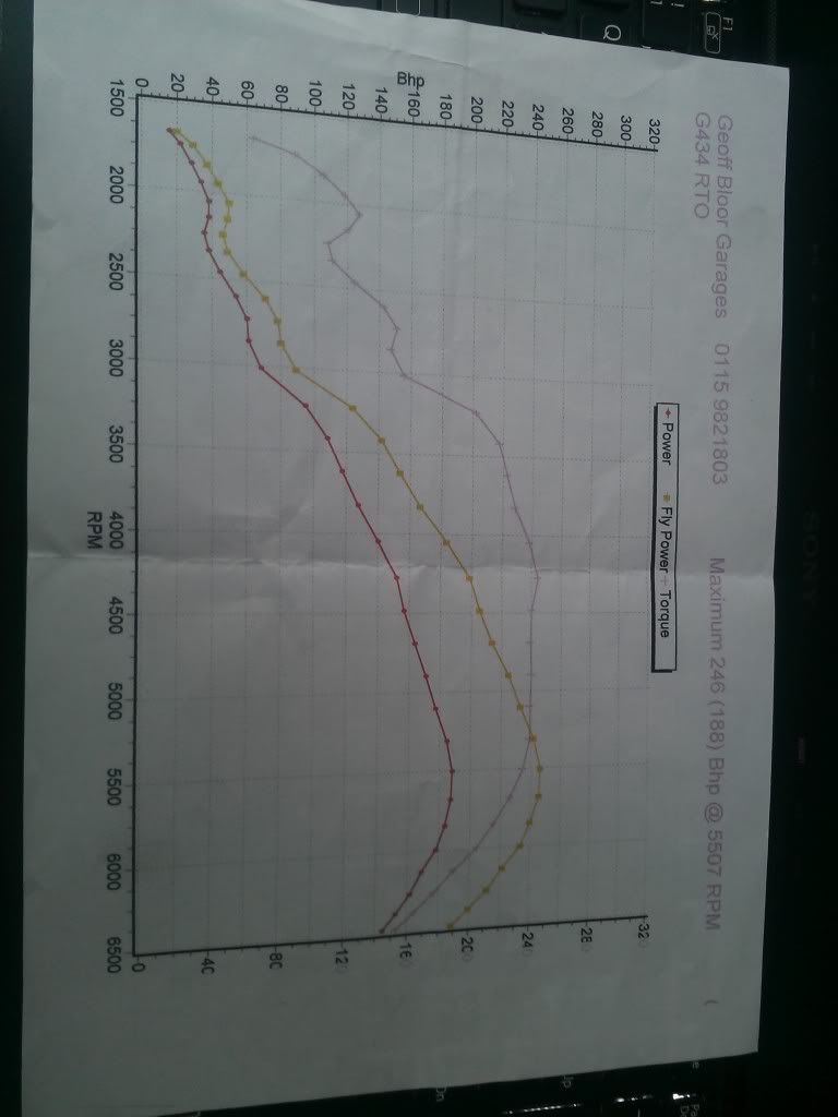

This engine has never run right from day one, and has been ongoing for the past 2 years. It was taken into a "tuning shop" and put down 246hp with 244 Lb-Tq (Not wheel power @ 8 P.S.I) I had been told that it was running fine but soon as a road test was done, it had the same fault. It was later returned and yet he couldn't find the fault, He told me to put the cat back on as the o2 sensor was unable to read correctly, and that the EGR must be put back on, however being a JDM version it never had EGR and still had the same fault with the cats in place + I am 99% certain that both items aren't used at WOT?
Dyno print out... Just before it left the shop, he did mention that fuelling was all over the place, this was only after I had to get answers on why he had told me the car was running "Perfect" on two separate occasions.

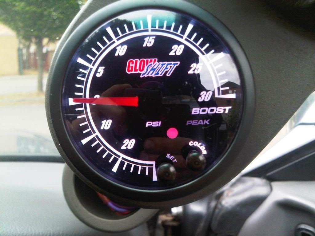

Wouldn't it be present all the time if it was a boost leak issue? The car will pull to 140mhp from a stand still with the boost gauge pinned at 10 p.s.i
Said gauge:
Matt.
