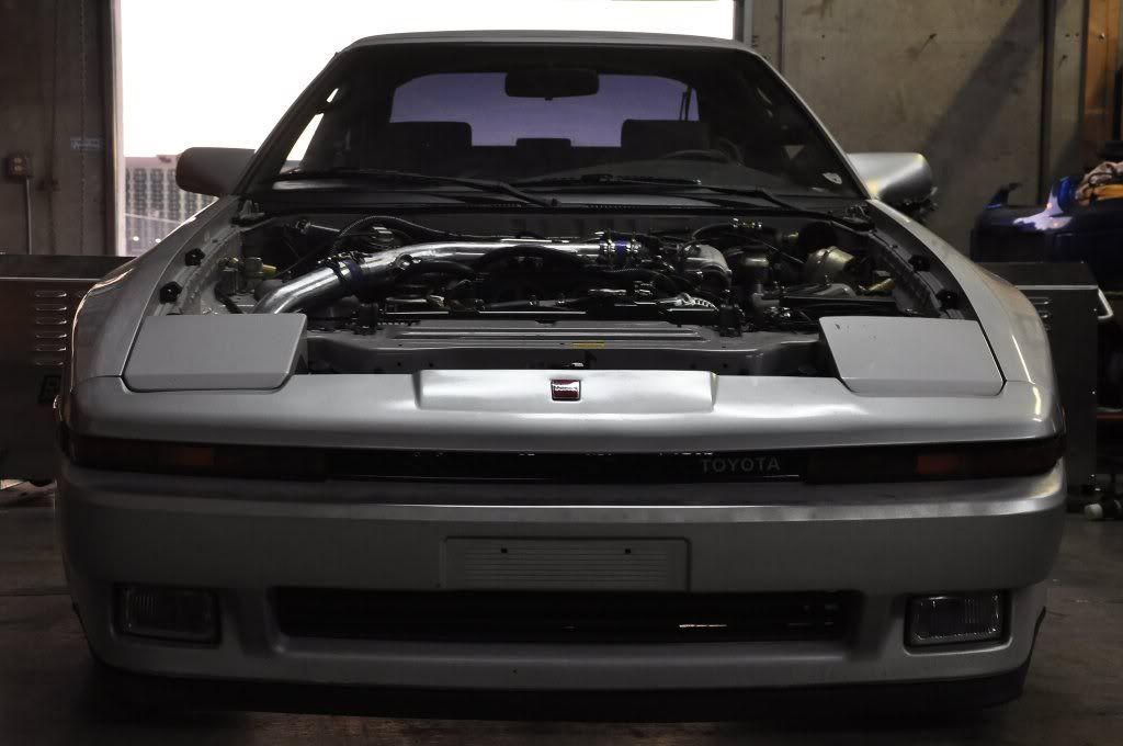

New power!!!! 404HP 405ft lbs @ the wheels CT26 on 17.5lbs

Thanks, Heading to work and going to throw the car up on the dyno after we get a few other cars tuned. We have 3 cars to tune today including mine so hopefully should do some better numbers.
Fuel pressure is holding now so should be good for 400 unless I run out of injector. Fuel pressure is set at 60PSI base and holding now so should have some room and need to pull fuel hopefully.

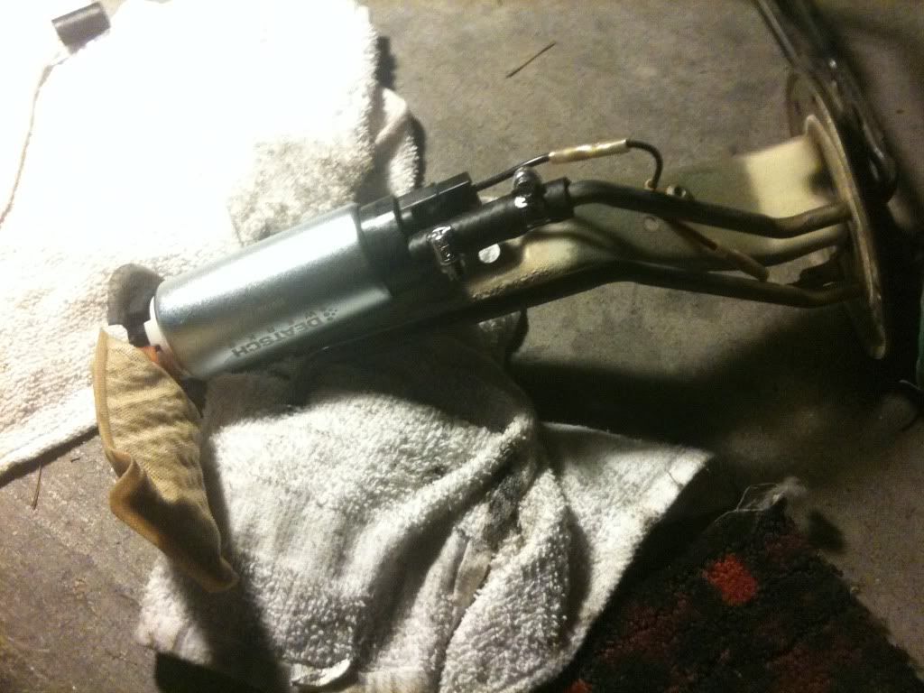

New DW300-1 pump installed.

Fueling issue is figured out. weak wiring and not enough flow from the single walbro. New wiring installed and Deatschwerks 300lph pump installed!
Dyno'ing within a few hours
