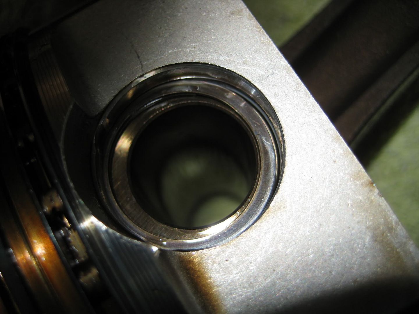

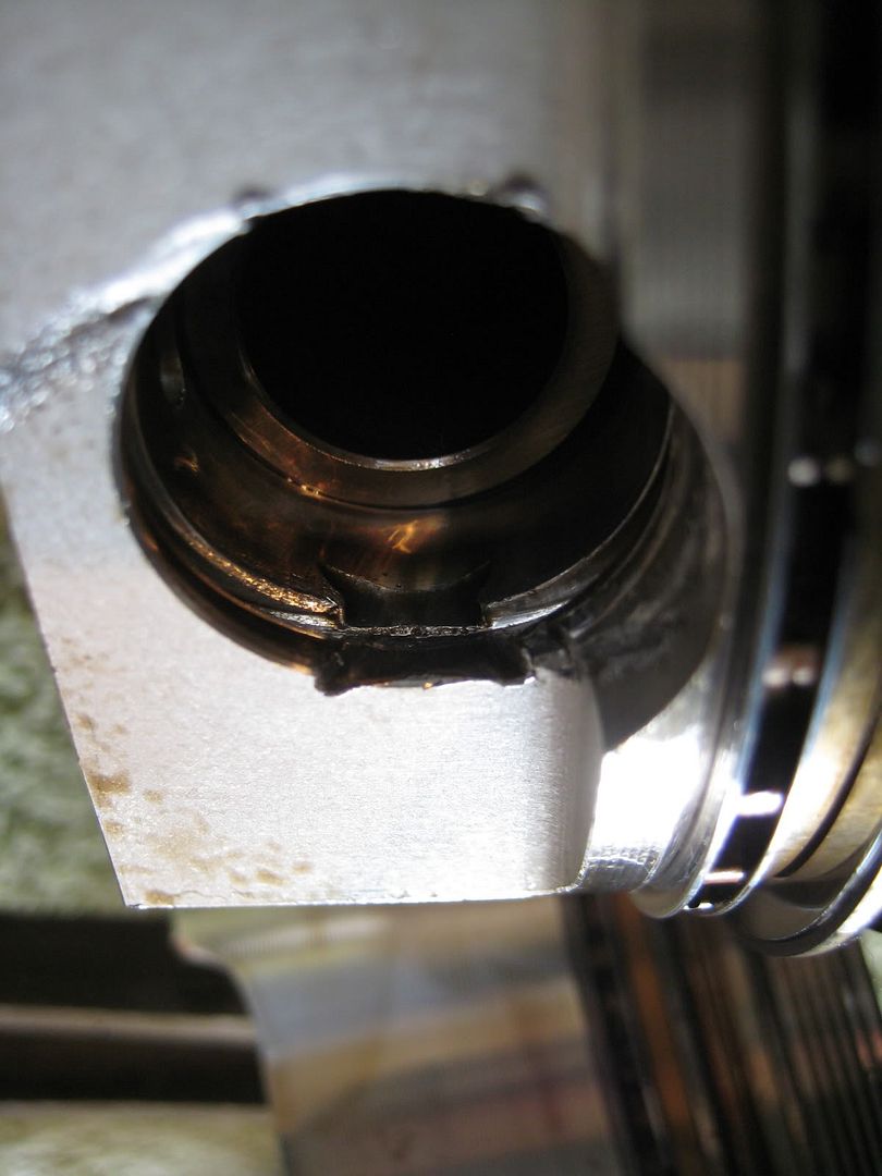

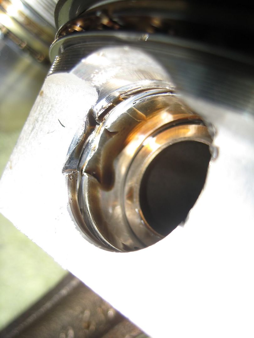

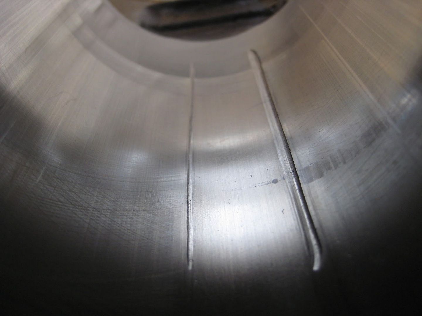

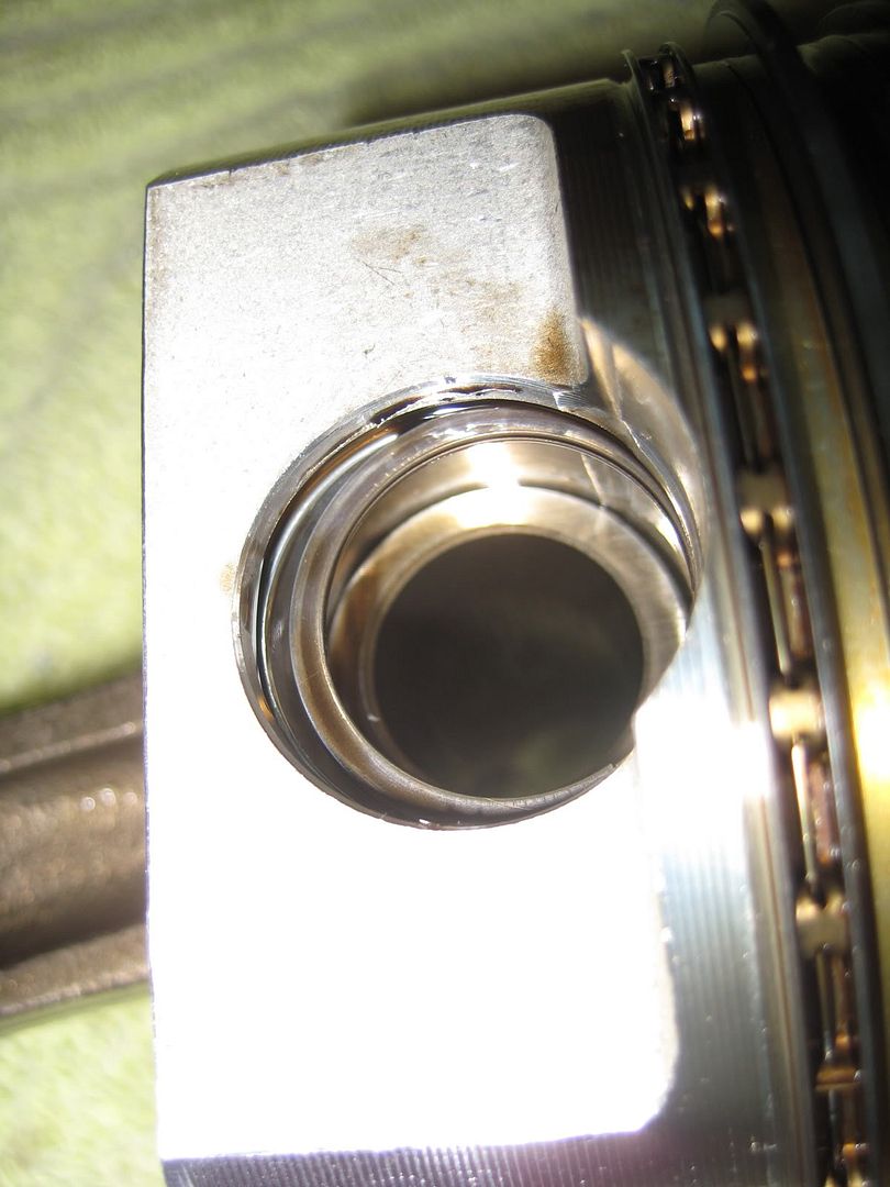

Wow well I was pretty surprised to find what I did. All the spiral locks that managed to stay in were VERY loose... Either they are too small, the groove was machined too big, or the groove managed to wear out and allow the locks to loosen up. I don't remember them being like this at all when I installed them, but because I expanded them before putting them in maybe the tension on them made them seem tight when they werent. Im surprised any of the others stayed in, and that all of these stayed in as long as they did. I am going to stay away from Probes on my next build... Heres some pics and a video (hope SOPA doesn't incarcerate me for the music in the background).
[video]www.youtube.com/watch?v=dLLiOY6HGk0[/video]
I think the vid shows it all.... EVERY clip that was left was like this.

Can you measure the grove on the pistons not damaged? I would see if it matches with spec and if you can be refunded. Maybe the spiral locks lost their tension? Crazy.
