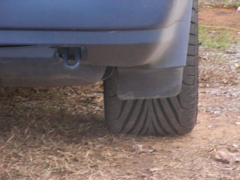

First of all, I bought two new Goodyear Eagle F1 for maximum traction out of a street tire.

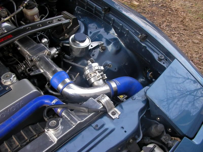

I also redid all of my wiring mess that was in my engine bay. Not many of you have ever seen the mess, because I avoided it with my camera. You can however see how clean it is now that I've moved it all up under my fender well. It looks so much better to me.........:love:
