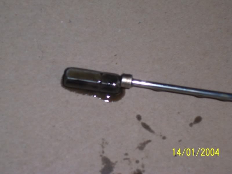

Picked out of sump from exhaust side rear oil drain
OK, so now you have blown my minddddddddd. First of all what the heck is that thing and how did it get down there?
Second, what is the diameter of that magnet on the end there? I definitely have an obstruction on the way down the hole about 6" into the hole. I don't see how I could fit that magnet down there unless it is smaller than it looks. Do tell!!!!!
Thats a allen key tool used to remove factory head studs
Magnet is about 3mm

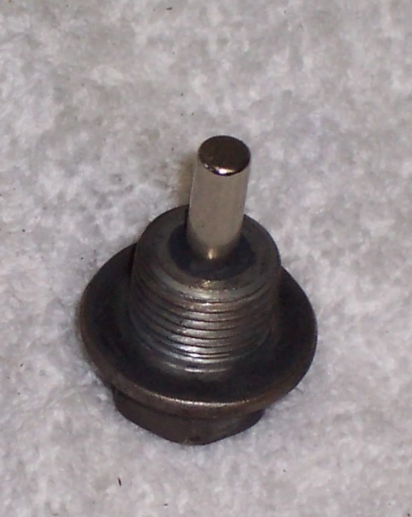

Heres a easy fix for bolt in sump
Change oil & remove bolt from magnet
MA70's 19mm Head sump bung is a 18mm x 1.25 thread I brought a magnetic sump plugs on trademe (Ebay) and made it fit the 7m bung used the magnets force to hold in place and a nead it type steel expoxy to secure in place
Any other toyota sump has the 12mm x 1.25 just not 7m/5m/1S
