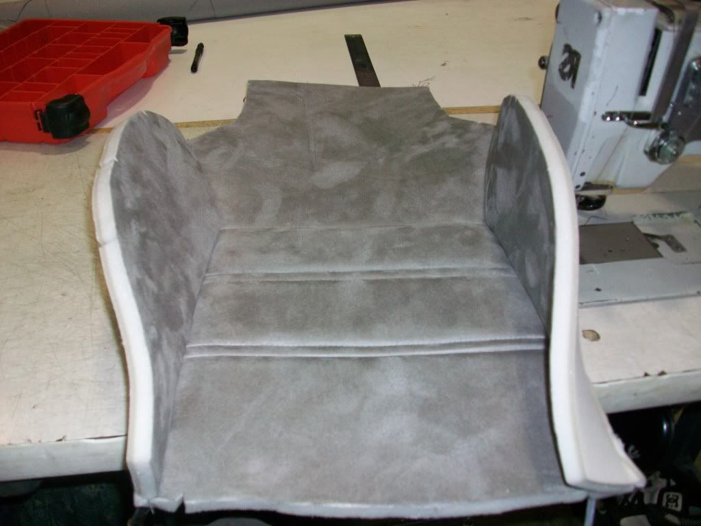

ya im from dayton ohio. but im open to do work around sept when i am done with school. Ive made patterns of all the parts to the seats but to mark the seam lines is a no go. im using a 1/2 seam allowance and really you wouldnt stay at that because of the curves and conners.

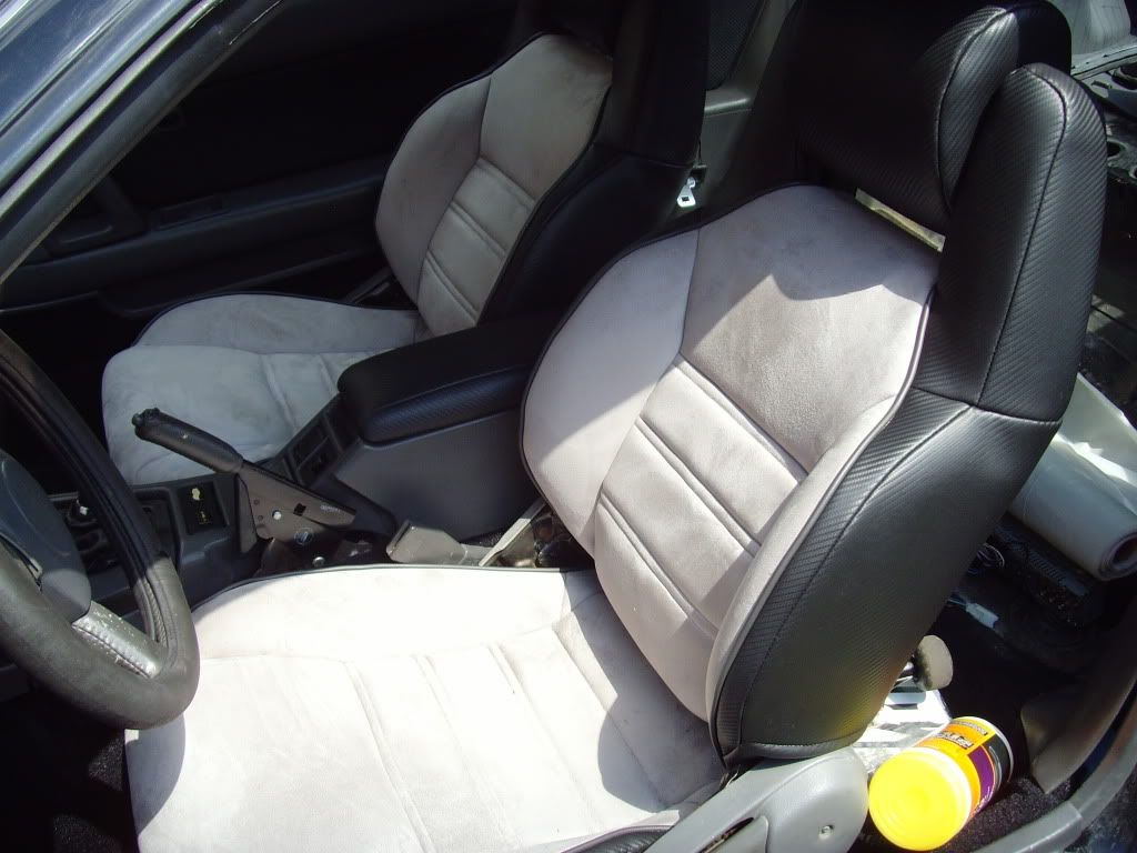

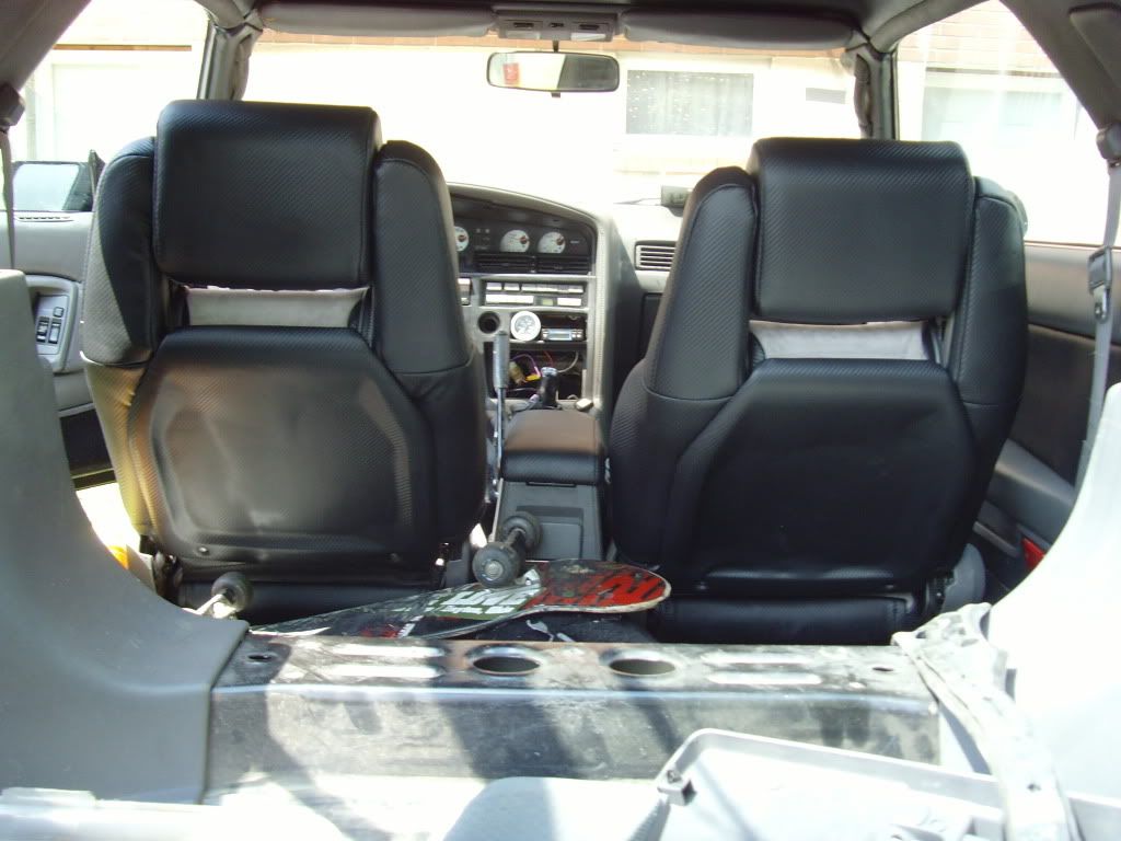

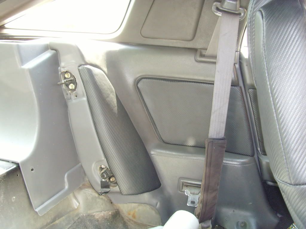

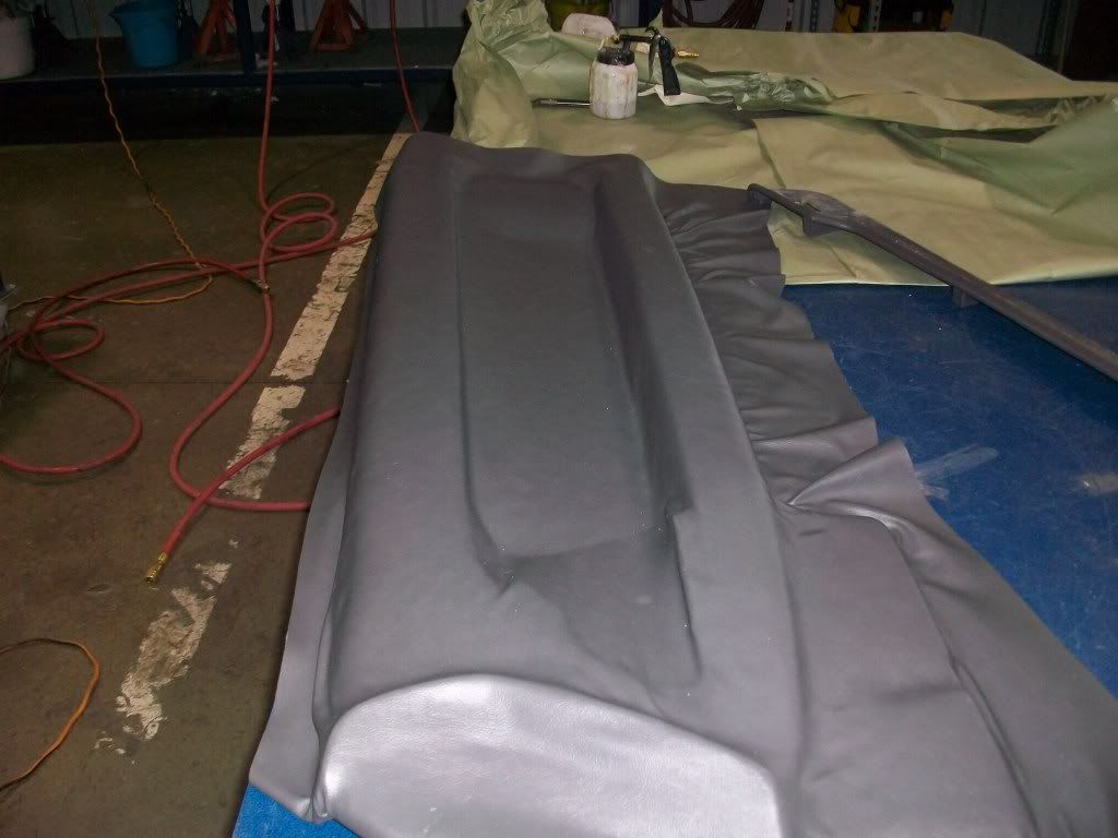

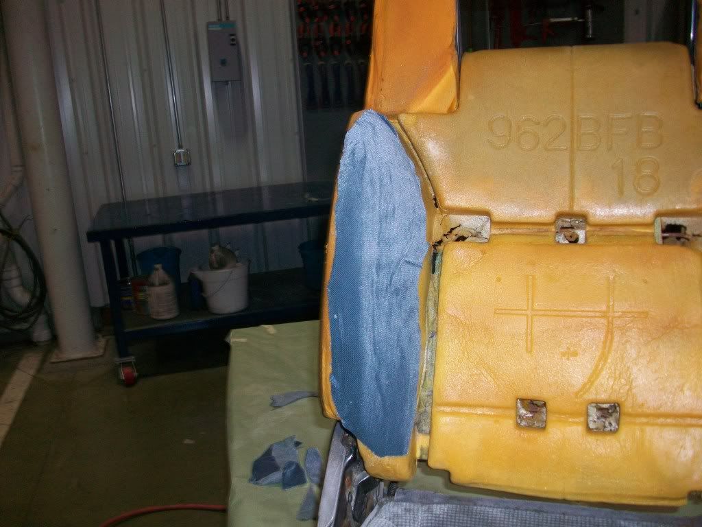

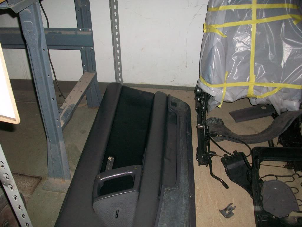

all sanded down
added some 1/8" foam
main/ hard parts covered up
cf insert on

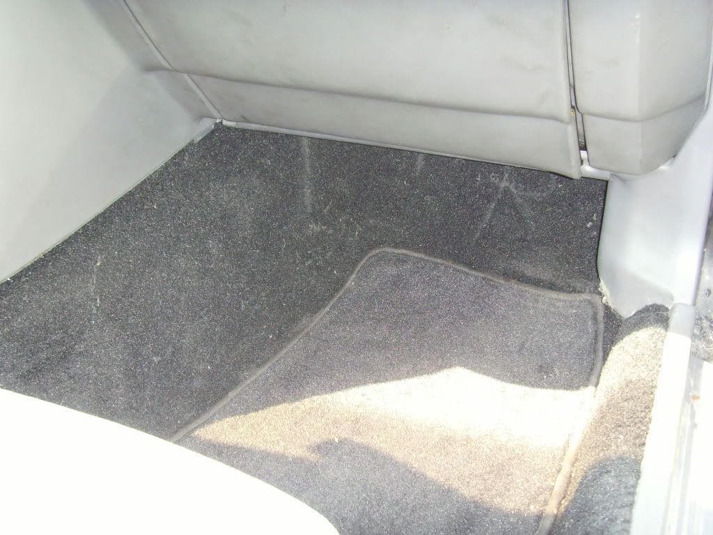

pretty much done waiting to lay my carpet down then covering the bottom section with carpet
driver seat :)

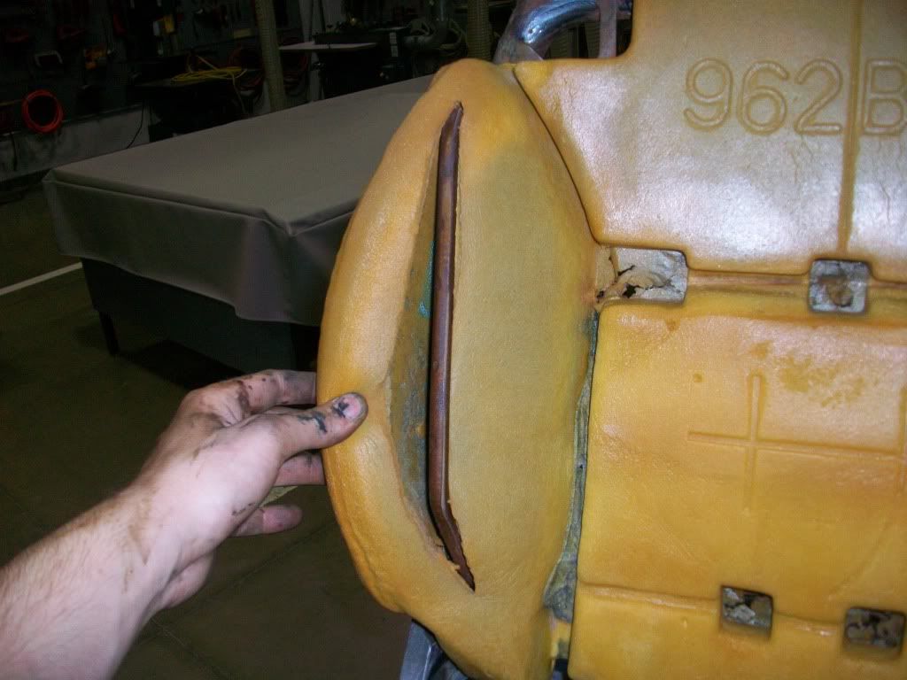

foams ripped:(
foam repaired:)
the back rests plate
the back rests boxing!!

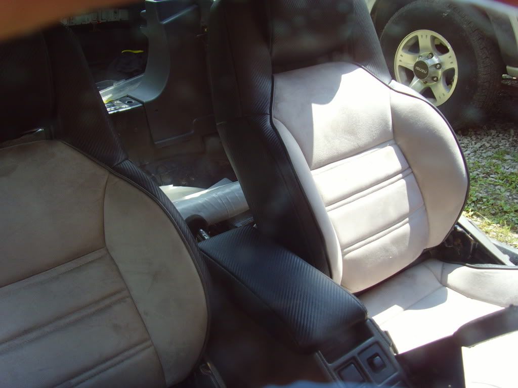

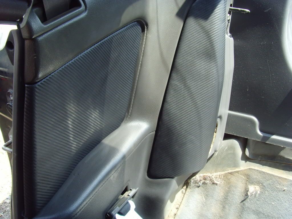

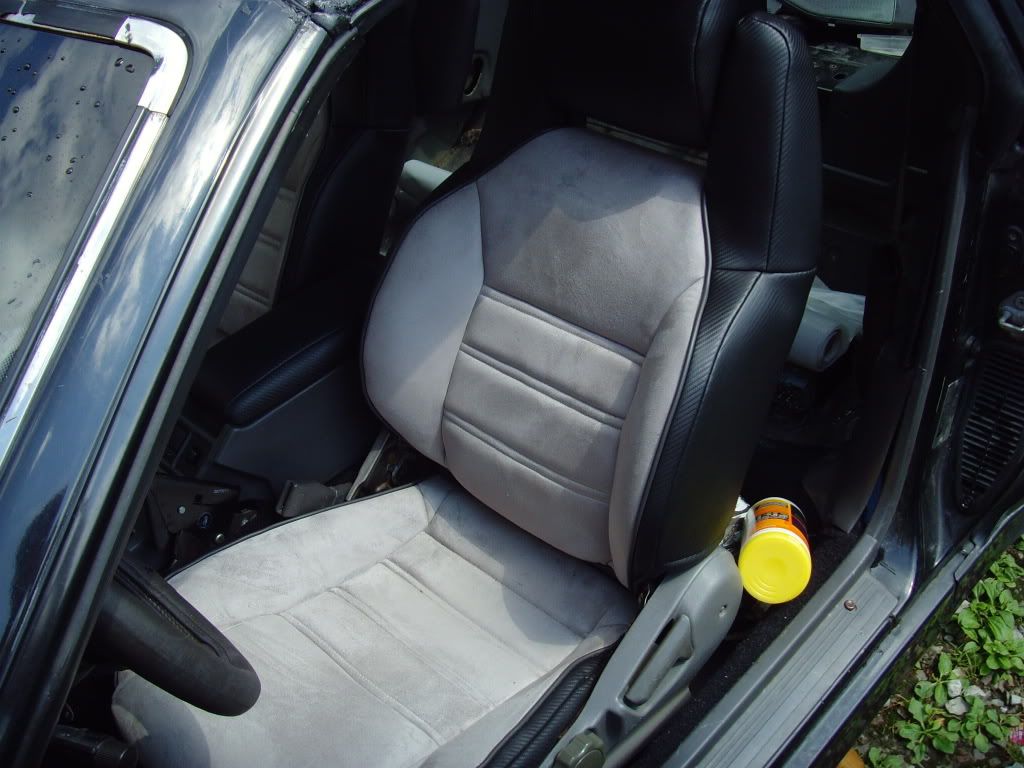

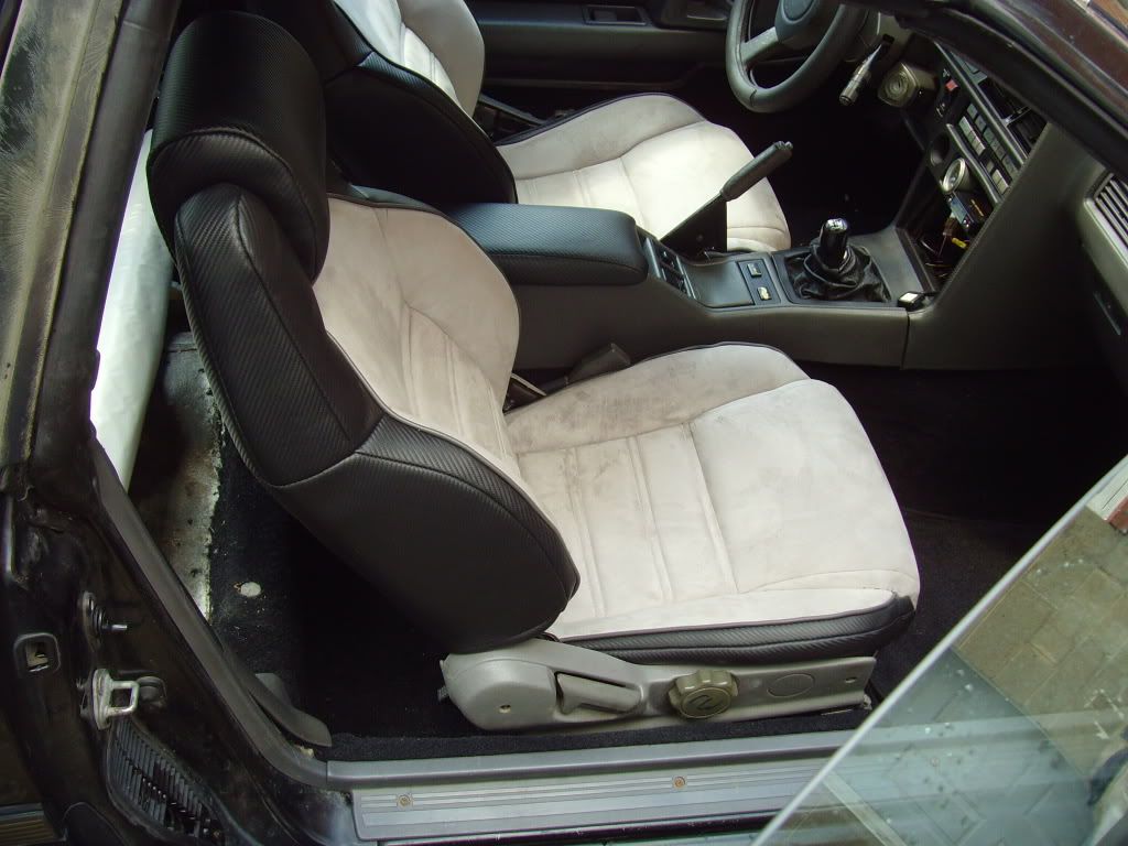

just got a new camera so heres the final resaults .. hope you like.

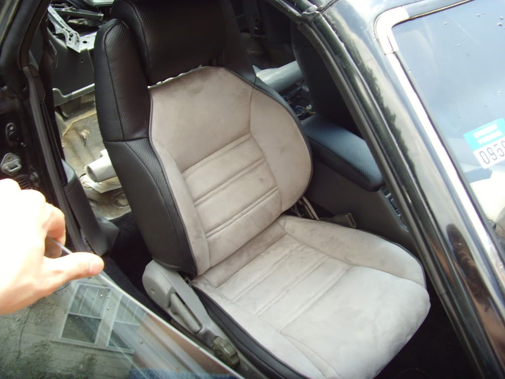

ALSO I got all new traga seals there all properly in but at the front A pillars they dont meet up right and the driver side is still leaking a tiny bit?
heres some pics so you can see what im talking bout.. so if you have any ideas please help i dont want my new seats to go to shit after the time and money i put into it
driver side where its still leaking
and pass side where its good and dosent leak ..but still dosnt line up ?
Looks like some damage to part of either the Targa or the a pillar. I love the seat work. How do I go about getting some of those? Also looks like you need one of Empera's ebrake lever boots.

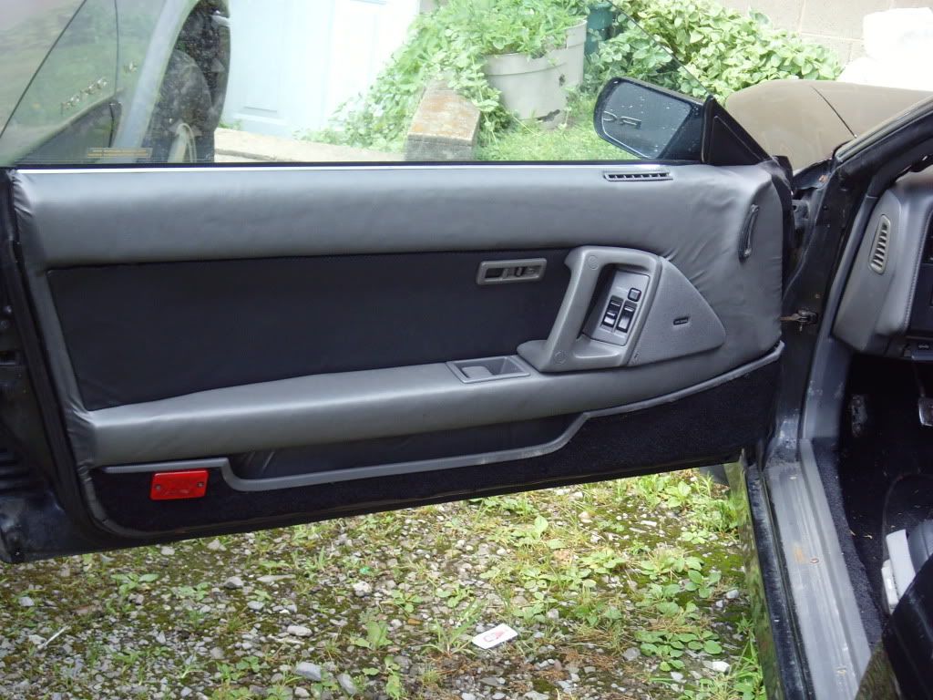

I love the sides and headrests, and the fronts are pretty nice. I would love to see the rear seats done in your style. The doors look great.
ya the a pillar molding is starting to pull away but ive heard about some sort of shims on the targ bolts where you can adjust the way the targa sets?
I had to trim my new targa seals with scissors. I trimmed only the part on the targa itself. Once cut, my seals matched up pretty well. Better than what you are showing in your pictures. I wonder if you have the original targa top that came with your car?
There are two places that could be leaking on the DS. First is on the targa itself. If you don't tear down and seal it like the step-by-step instructions posted on SM, it will leak (I had to do mine twice). Second place is behind the seal over the windshield. On the DS, there is a dam that catches water and debris behind the seal, above the corner of the windshield. Over the years, it rusted badly on my car. After I had it cleaned out and the dam removed, it leaked. So I grabbed the RTV and sealed it up.
