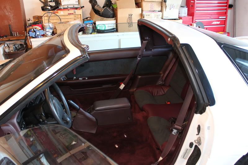

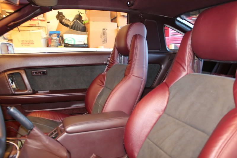

Interior...

looks very good Adam. I can't tell if it's a charcoal grey or black color with the flash?
I've never been a big fan of Toyota's burgundy but I like what you've done with it.
Did you get your CT rebuilt? Oh, I just noticed the "turbo install to come" at the bottom of your post, I guess I'll just wait and see what your up too:)

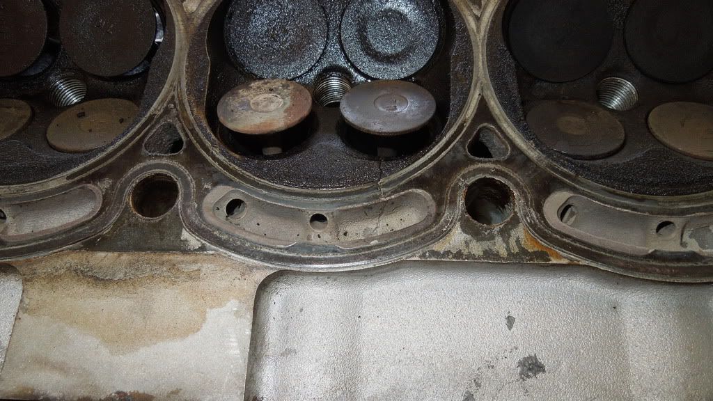

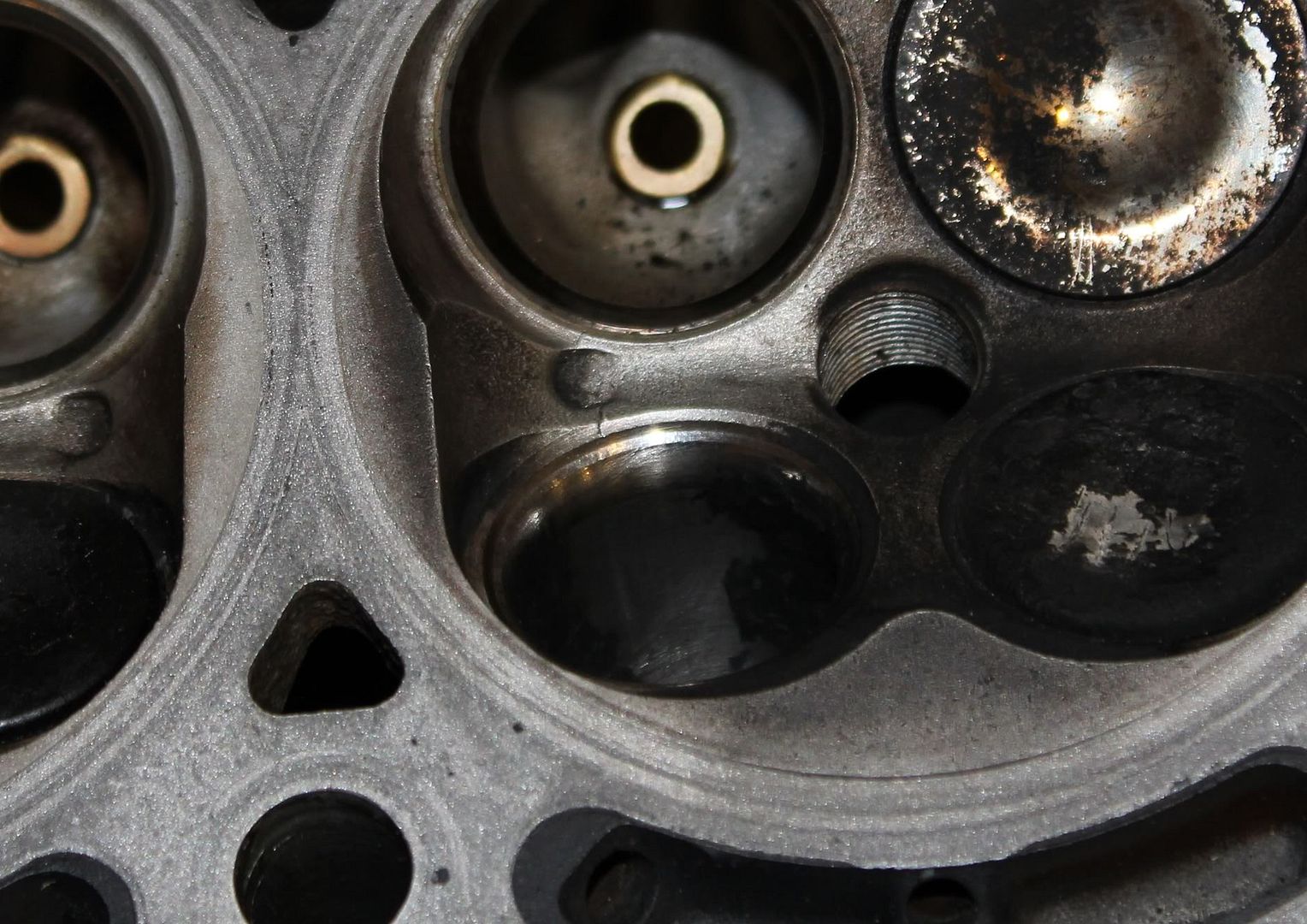

Last summer, I sold my dd so I drove the car for a few months with a shiny new turbo. It was pushing oil out the intake so, I did a compression test. 1-5 :) 6 :(
#6:
#3:
Expensive replacement head:

So, after buying a cracked "built" head, I finally tracked down a head free of combustion chamber cracks. Off to the shop for cleaning and a valve job, then I'll try my hand at porting. (Casting #3 on this head)
As far as the block is concerned, thankfully the worst cylinder cleaned up at .040" over. FYI, if a spark plug ever lets go on you (this was a champion plug back before I knew better) it will fuck everything up (trashed the head surfaces and gouged the cylinder wall). Thanks to the previous build, the mains are all within .0001", so no line hone necessary. Here's the build list for the engine:
