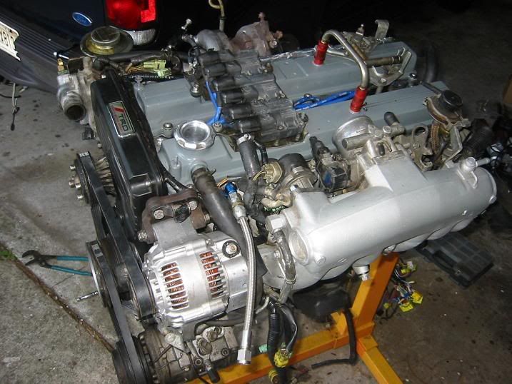

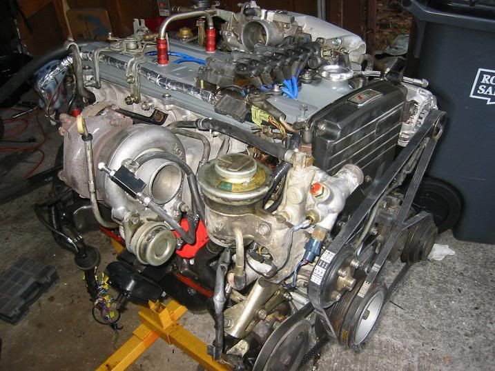

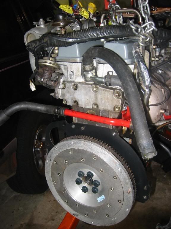

Well, I pretty much completed the engine now, and now it's time to mate it to the tranny. Unfortunately, that'll have to wait till after the weekend. :icon_mad:
Here's how it looks as it is now;
One thing kinda sucks, though- I just found out that my remote oil adapter - the part that goes on the side of the block- sticks out too far- right into the pipe area coming off the compressor. So now I have to find a different setup.
Anyone else had this problem before?

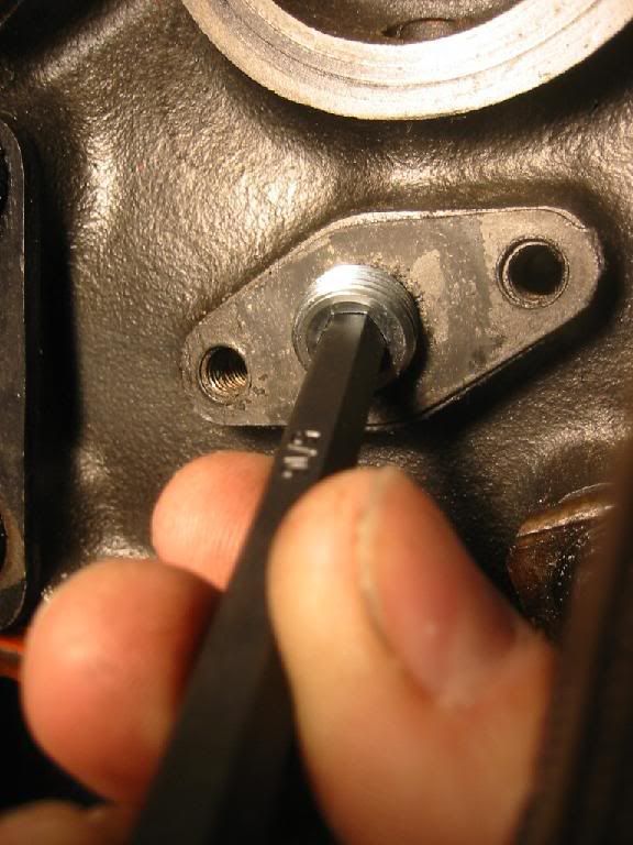

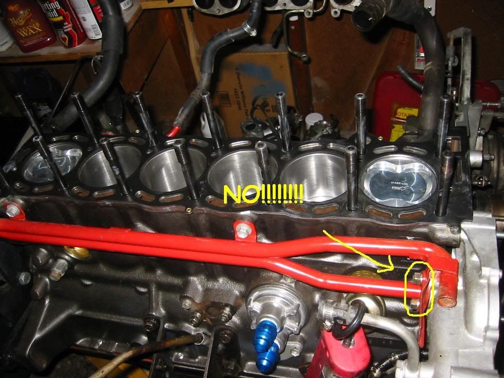

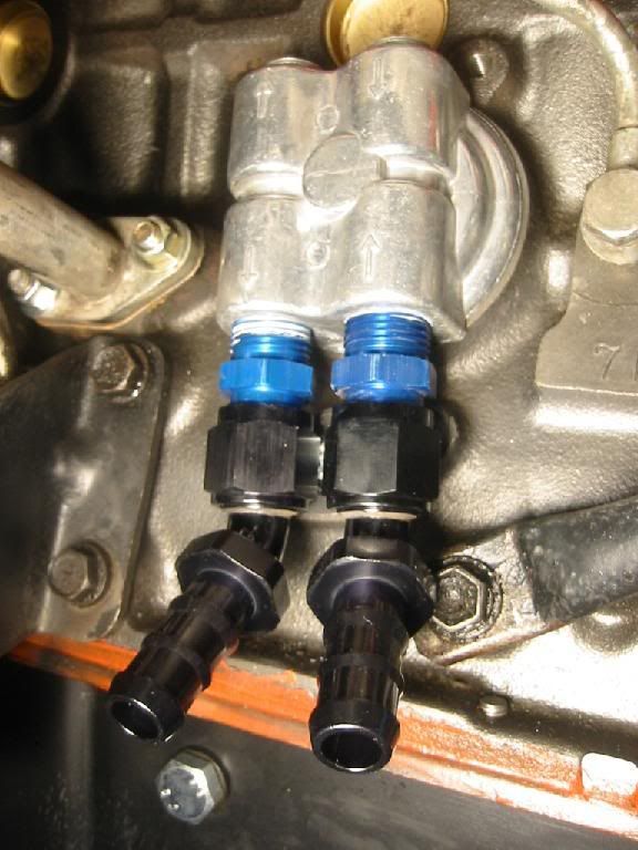

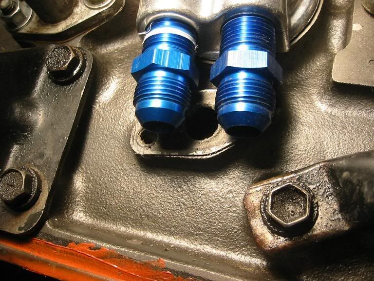

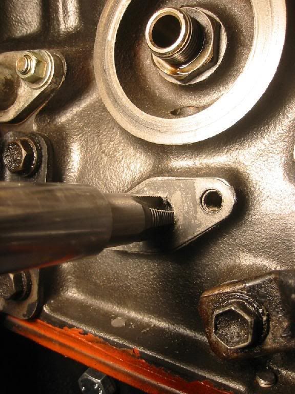

As I mentioned, the remote adapter was going to interfere with the turbo's outlet pipe, so I picked up a new adapter which had flush outlets. Problem was, these new outlets would be interfering with the blockoff plate below the oil filter location! So, I had to tap it;
As you can see, this won't work if the blockoff plate and both bolts are there.
Holding up the 3/8 pipe plug, you can see it's a pretty close fit as is.
I didn't even have to drill, just used the npt tap. What about metal shavings?!
I first stuffed a piece of plastic baggy in the hole to block any debris from going down into the motor. Then after I tapped, I pushed in a small magnet and cleaned as much as I could. then I pulled the baggy out, and any remaining grit, etc. with it, then wiped the hole out, back to front. Worked pretty well.
Now, it fits just fine. :icon_bigg

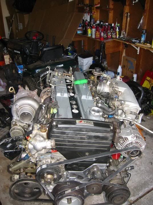

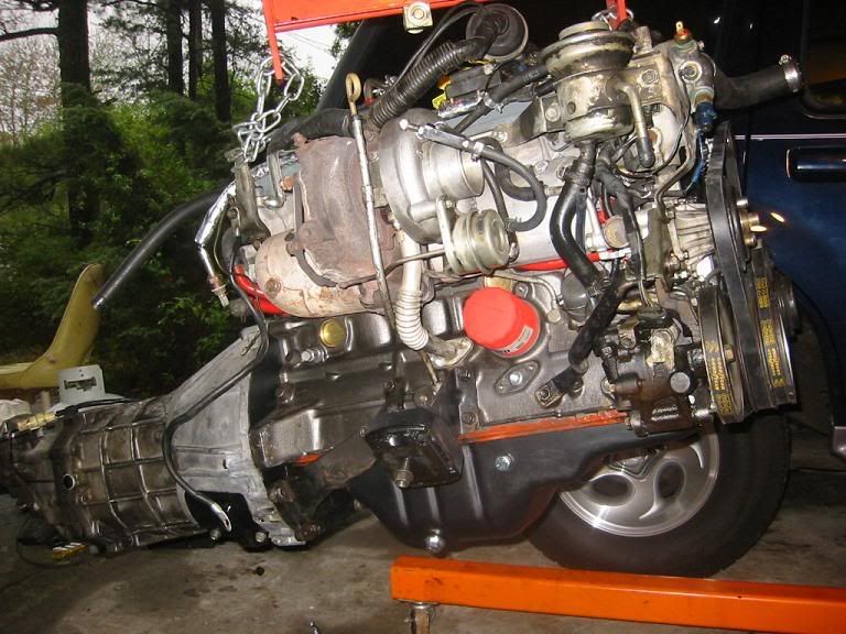

And here's a complete drivetrain ready to go in tomorrow(Sunday). It's supposed to be nice, so here's to no more delays!
:naughty:
If you'll notice, I have the oil filter directly on the filter boss right now. I'm thinking of keeping it this way for the break-in since it'll only have this oil in it for a hundred miles or so. I figured this would help to keep any contaminants out of the cooling circuit. Then engine won't be run hard during this phase, just some load on it to set the piston rings, then another oil change. Anyone think this is a particularly good or bad idea??

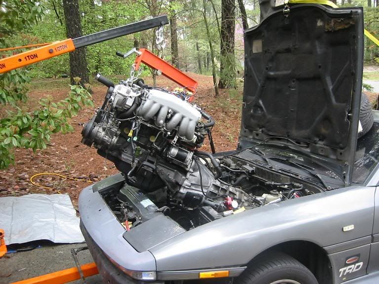

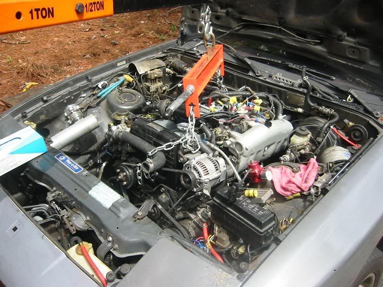

I started off by degreasing the engine compartment, and began shoehorning the drivetrain in:
Then I started hooking everything up.

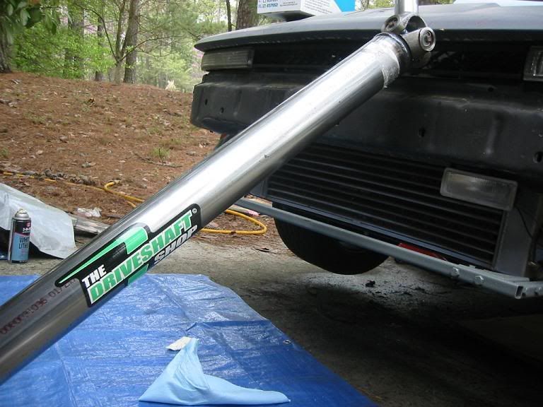

I clearcoated the driveshaft in the hopes that it wont get all corroded too soon. By midafternoon, I had just about everything connected except the shifter and the ecu, so I started to add all the fluids to the car. Well, I filled up the radiator, then took off the heater core hose at the back passenger side, to get as much coolant in the block as possible to reduce burp time.

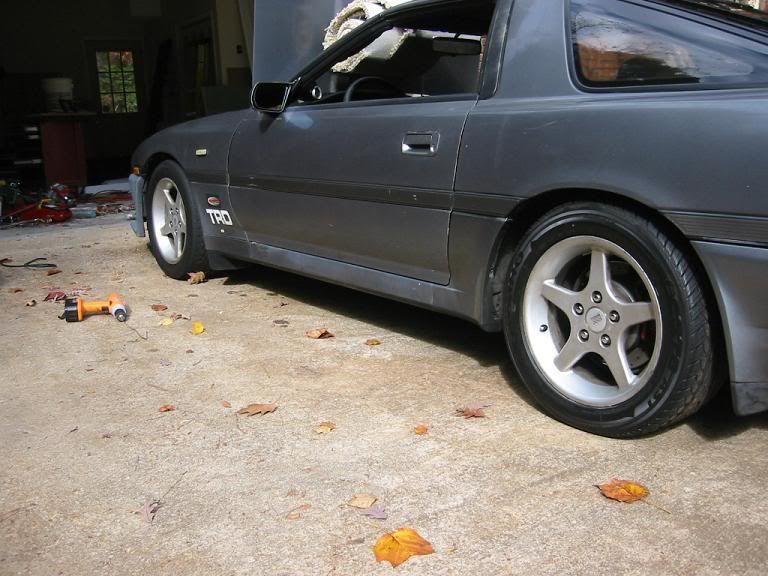

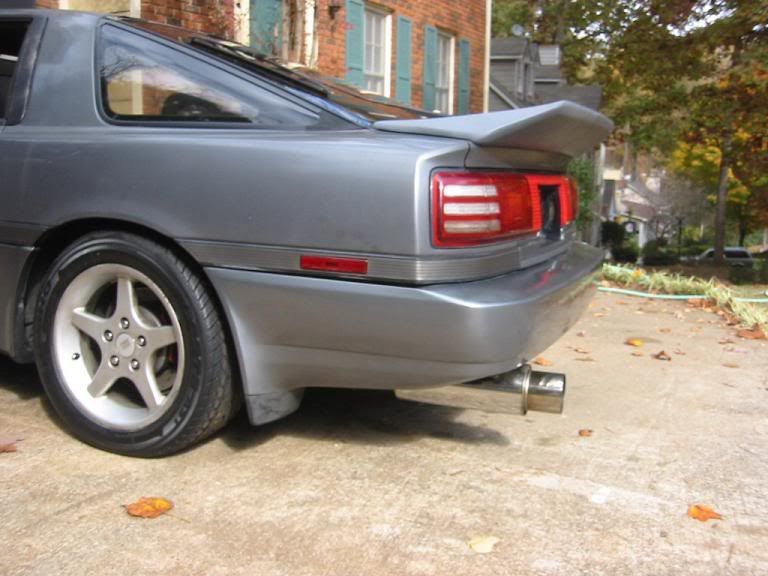

I finally got tired of the crappy sideskirts and rear bumper on the car, and have decided to go a bit more OEM with the final look. Bottom line- I wan't my car to ultimately look like a slightly modded car, not an all-out racer.
I guess I'm getting old.:nono:
I'm keeping the rear spoiler and front bumper, but that's sporty enough. I will go with 18" staggered wheels in the Spring, but prolly something like a BBS LM look- again, sporty, but restrained. Thanks to Tubbie for hooking me up with OEM mudflaps, perfect passenger door panel and a decent rear bumper. :biglaugh:

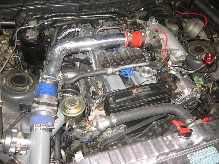

The motor as it sits now:
