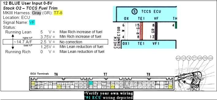

1. Every time I start the car when it is cold the afr's are steady around 14.8-15.0 when the car gets warmed up they will start jumping around all across the board and if the computer is trying to correct. I know that until the car is warm the computer will correct with the TCCS.
UPDATE 4/18: Alright just as every one has been telling me I had to check my vf voltage so I did. This was very simple in the diagnostic port just put the positive end of a volt meter in the vf1 pin and ground the other where you like. I noticed that sometimes the car would show 2.35v, which means no correction. Other times it would start running rough and go straight to 5v, which means the TCCS is seeing a lean condition and trying to correct by making things richer. I raised the fuel pressure and went in on the afm screw a little, but nothing seems to help. I have heard that and the lex/550 mod idle is always going to be lean.
