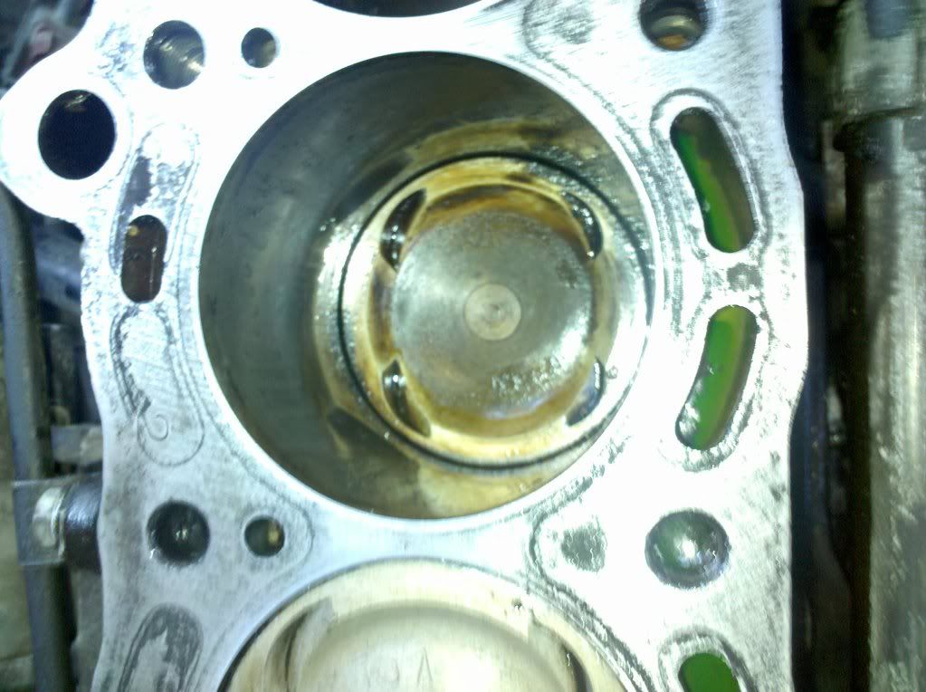

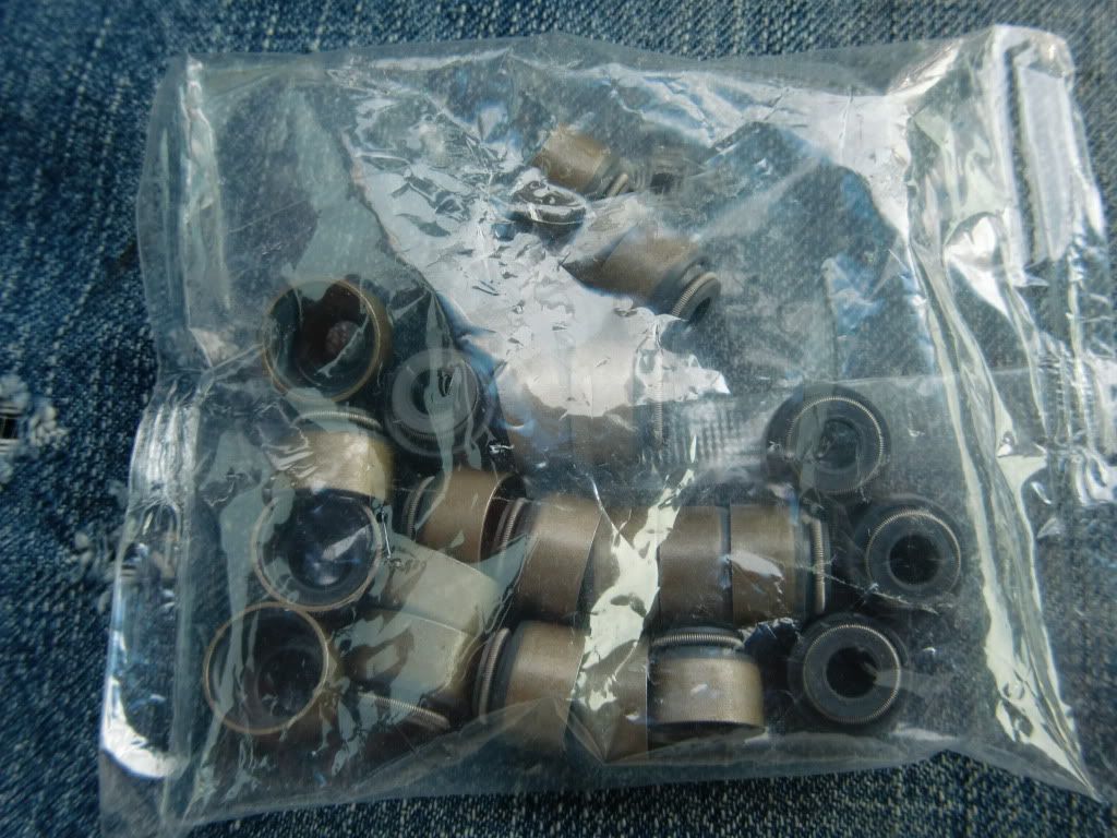

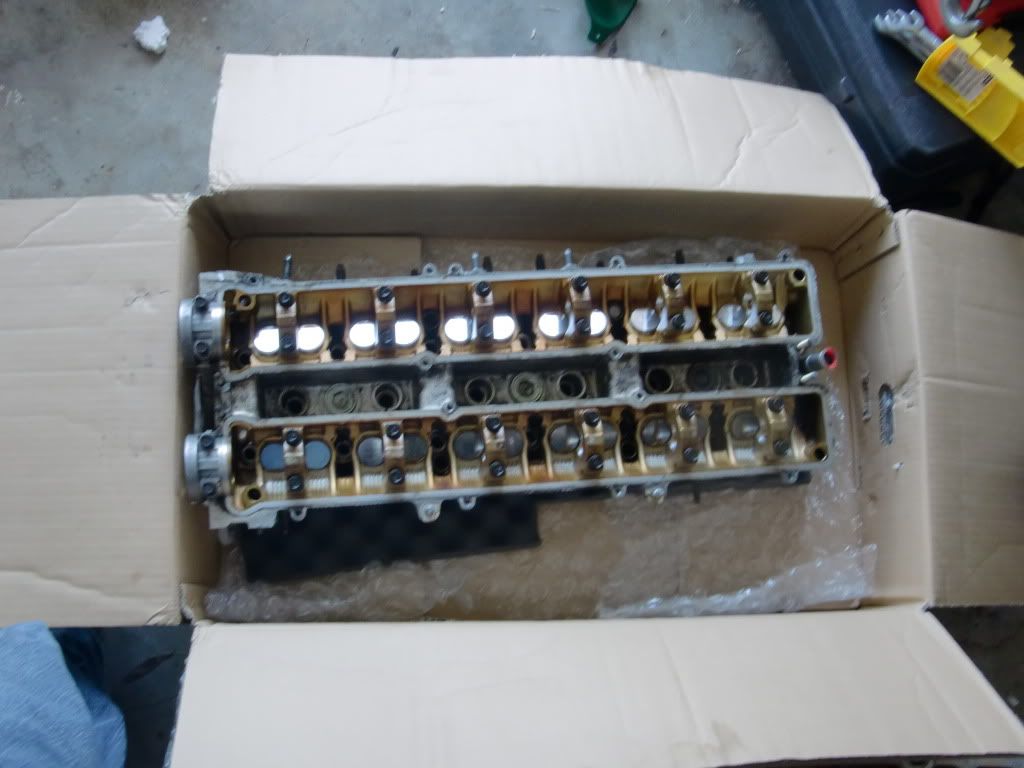

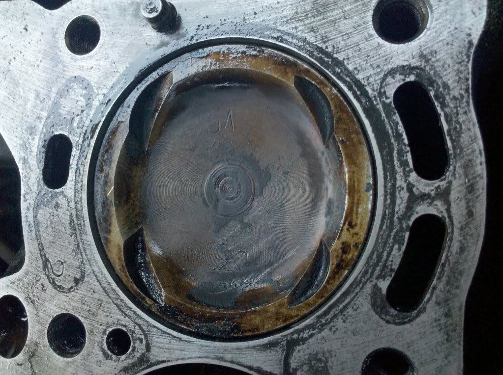

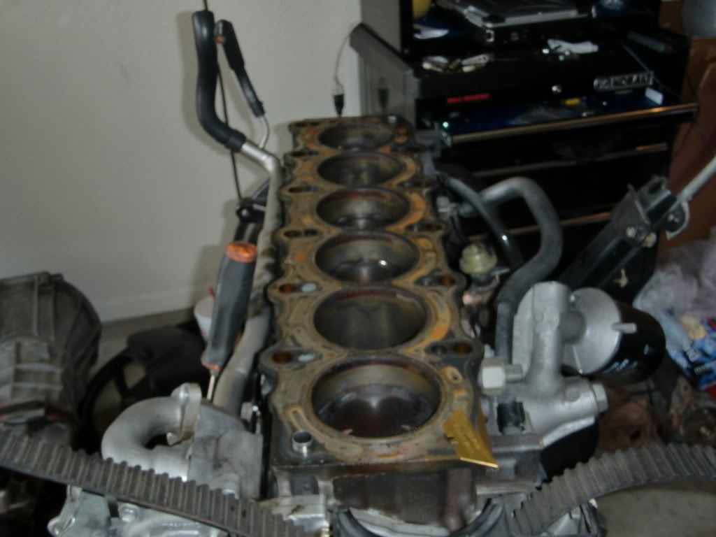

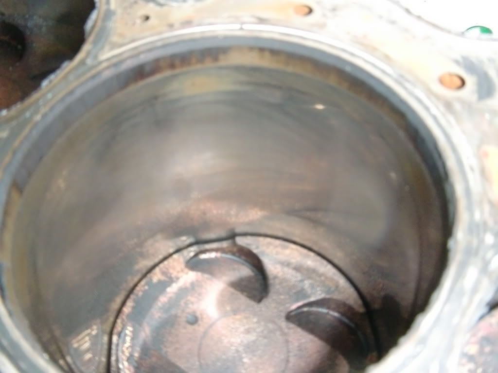

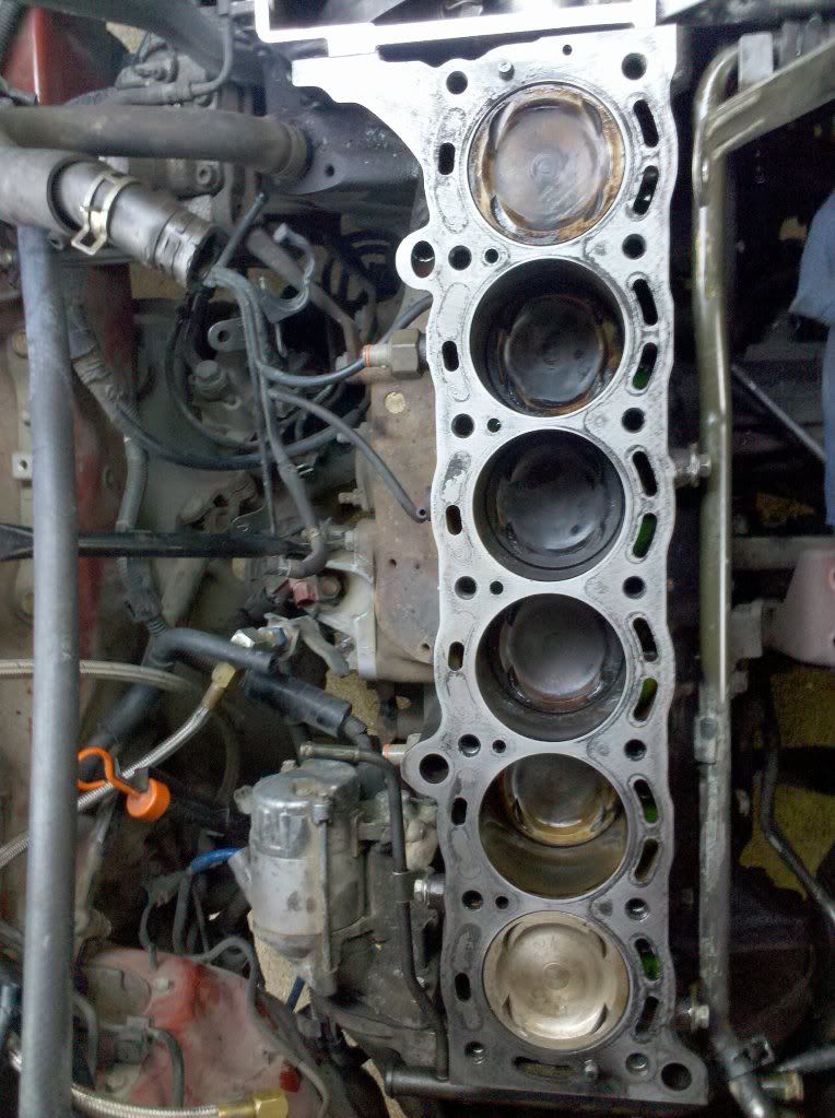

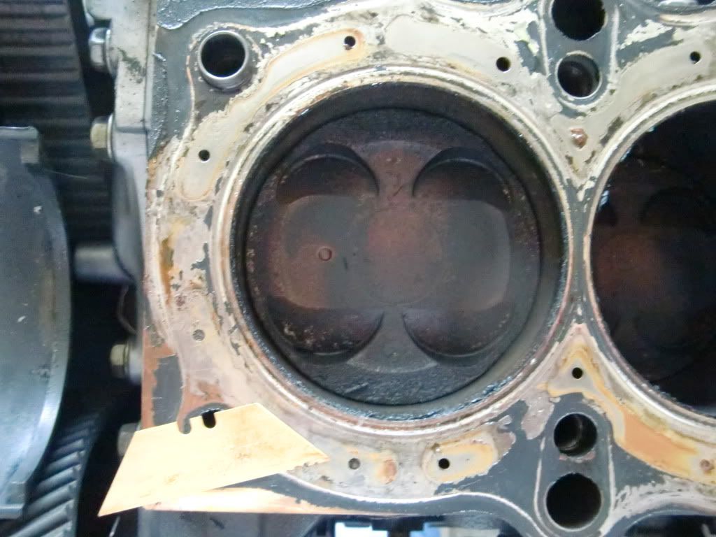

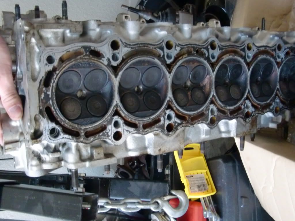

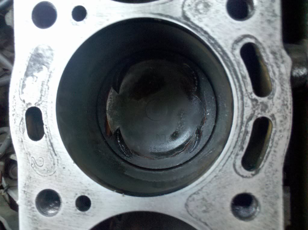

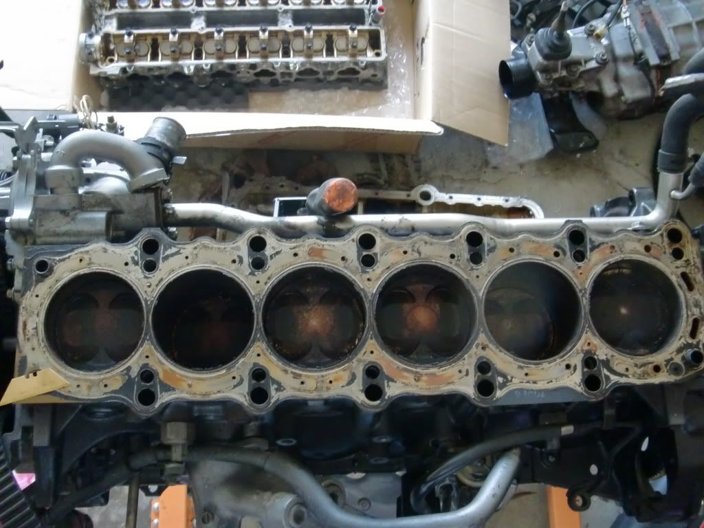

Head is off! It actually needed a 12mm tripple hex.It is at the machine shop for a check, valve job and cleaning, Should have it back in a couple days. I should have cleaned the deck before I did the oil pan swap now I gotta be extra careful, I got some rubber/plastic scrubber bits to remove the old material... one outta six of the spark plugs was a different heat rating.. thought that was weird and the water jackets on the block seem pretty clogged with rust deposits. Gonna need a healthy flush before the koyo rad goes in! Also there were some rubber pieces stuck in 2 of the coolant jackets, I got one out but one fell in, have no Idea what those are from. Here is some pics... Tell me what you think of the engine...good shape? or rehone/re-ring?
---------- Post added at 11:24 PM ---------- Previous post was at 11:22 PM ----------
Head
boxed
ready to go
valve seals
More soon!!

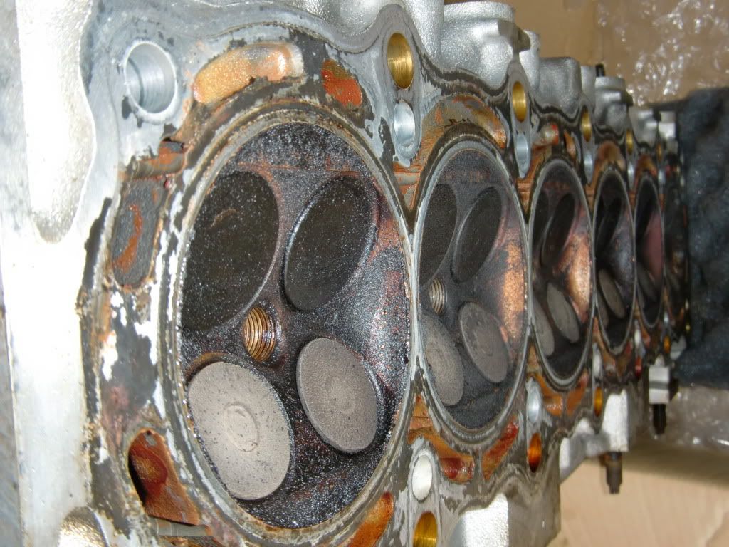

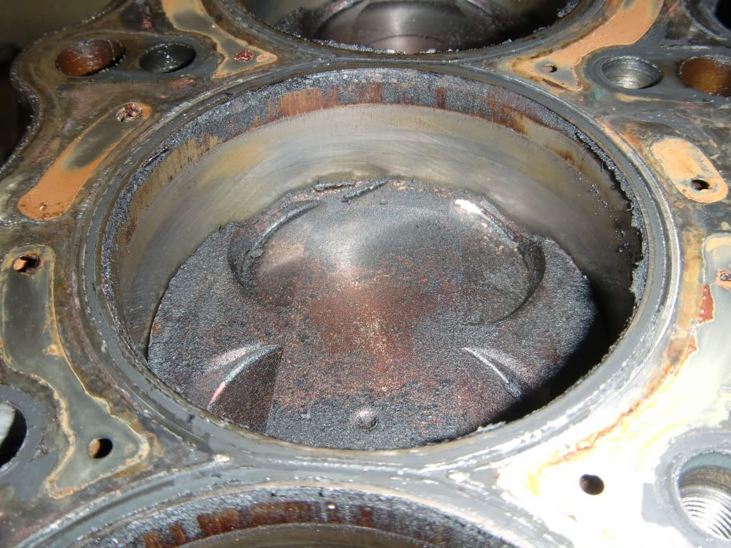

Head is back.. full valve job and Res him cleaned up and perfectly flat. Block cleaned and checks out. Headgasket and head is on... sitting on studs not bolted, going to torque tomorrow.
Cleaned vs dirty
