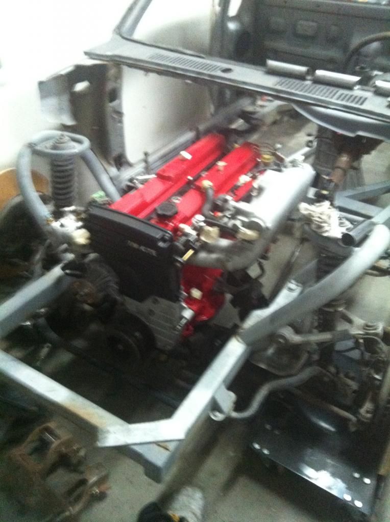

so a little time this weekend to get a little done ...

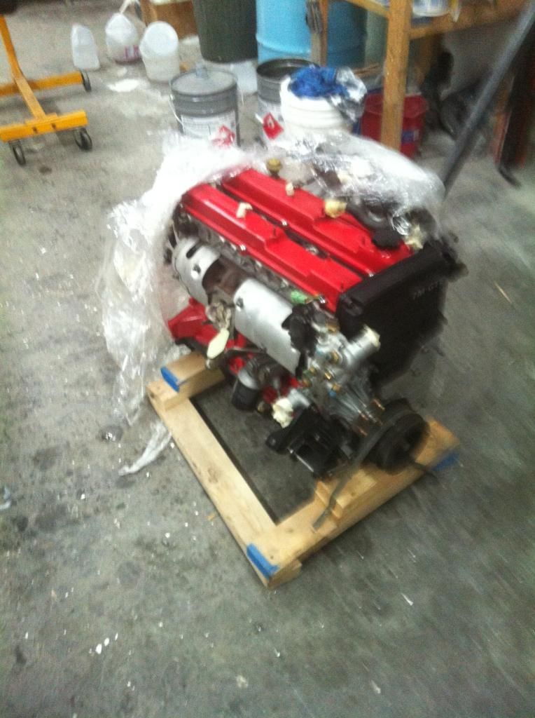

I'm bracing the front shock towers and building the front "tube" section , so I needed to get my real engine in , which I still need to add some things to , so I can make sure all my clearances will work
so out of it covered shrink wrapped casing it comes
and into place

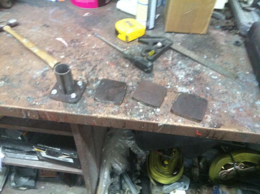

I have also started on the brackets for the supports
