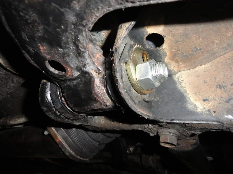

Front lower control arm withe new bushings and hardware
blitz nurspec

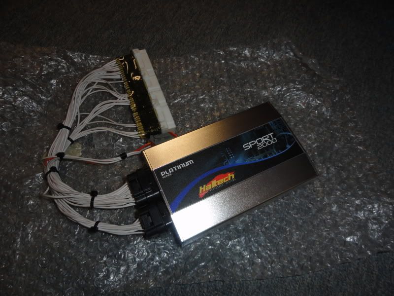

found some pics.

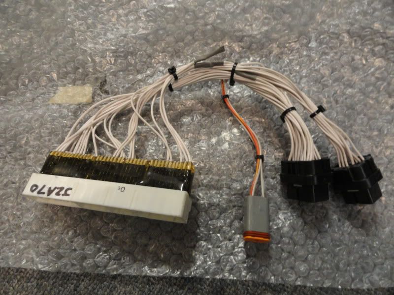

BIC PnP harness for Haltech PS2000.
Just need injectors, ST front sway bar and BIC Endlinks. Anyone got any for sale? heh.

Looks really nice Chris!
Wierd how we have prettydamn similar builds goin on lol
How much did that jumper harness run you if you dont mind?

Thanks! Tell u the truth. I forget. Bought it a few months ago. I think around 2-300. I think I got the last one he said. There wasn't enough demand so they stopped making them.

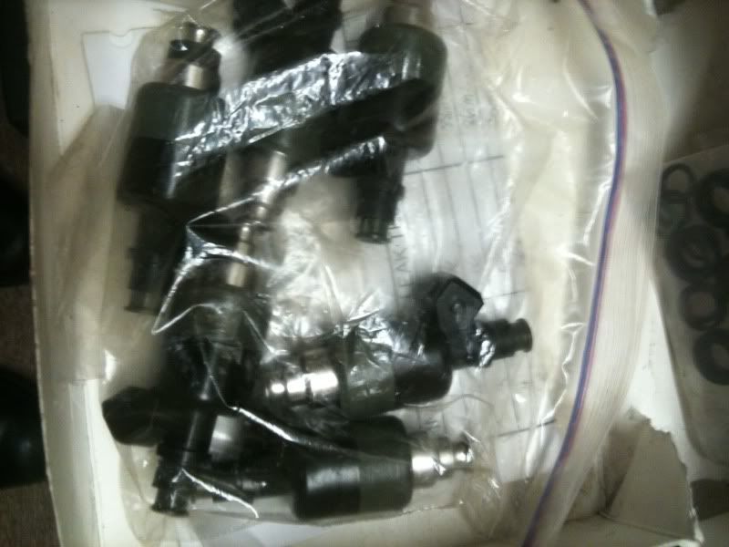

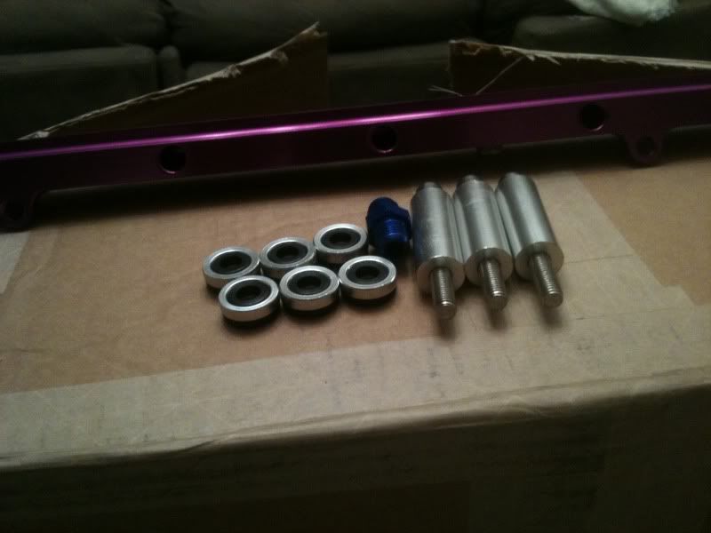

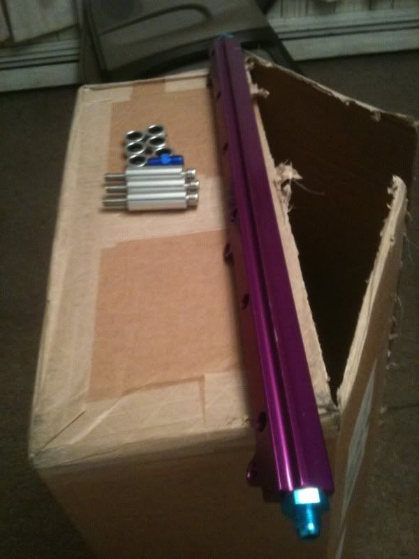

little update...

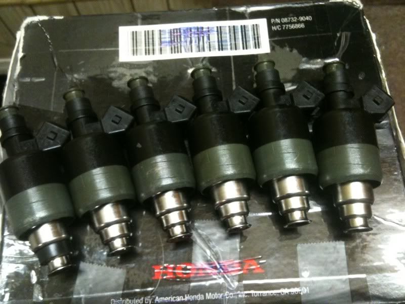

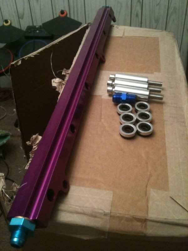

I was going to get some 800cc Sard that would drop in to the stock rail from RHDJapan. Of course as it always happens, we find a better deal and we make compromise. I'm buying a set of top feed 780cc PTE injectors off emp. pics later. I was looking around for a deal on a top feed rail. Finally found one ebay which just came in the mail today.
sorry for the shitty cellphone pics.
As for the engine, I started to put it back together. Replaced the front and main seals. Installed the oil pump. While putting the crank sensor gear on, stupid me stripped the crank pulley bolt.:nono: Luckily I didn't strip the crank, which would suck! Ordered a new one from DM which also came in today. I also finally ordered up a front Suspension Technique sway bar from Grimsta. All I really need now are end links. Anyone know if I can use the stock front end links on the back...just as a temporary option. My stock rear ones kinda snapped by hand when taking off the rear sway bar! :biglaugh: I plan to get the adjustable end links from Randy at BIC. That's really all for now. Cramming for an exam I have coming up in the next two weeks. Really hoping i pass! Wish me luck! gonna need it!:1zhelp:
