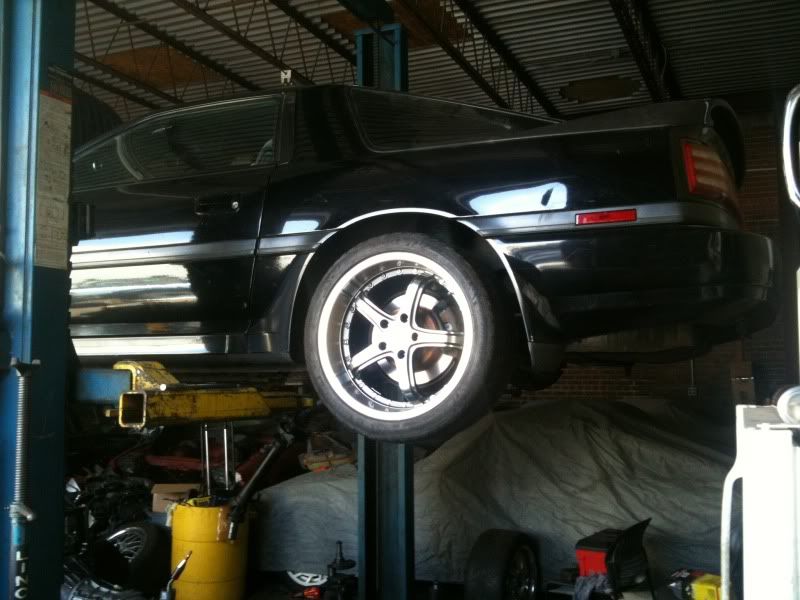

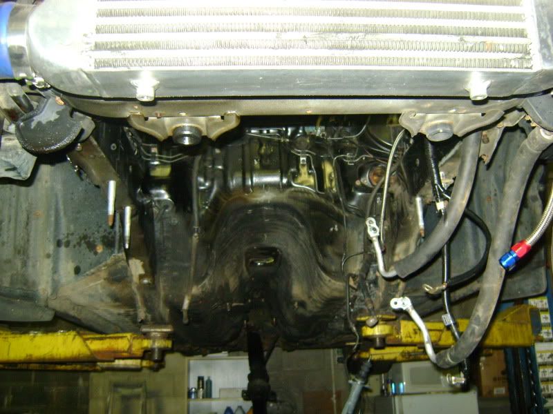

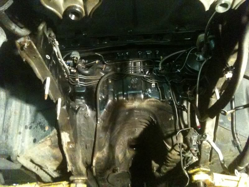

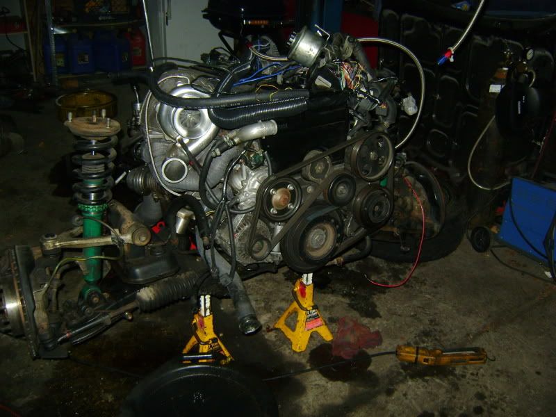

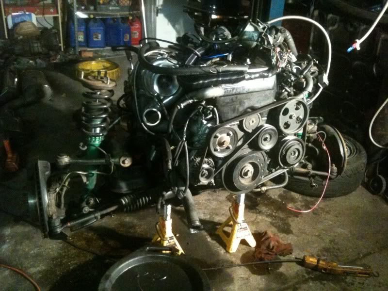

Here are some pics. Sorry for the Crappy phone pics.

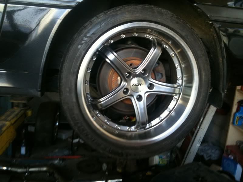

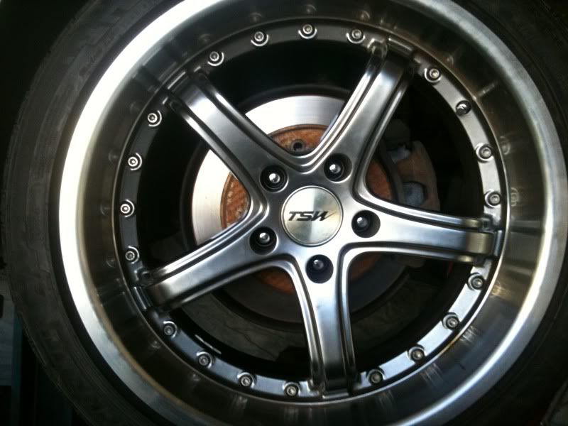

I finally got around to trying to view the pictures I have to say that I really like what I see. What sizes and offsets are your new TSWs? Also, what's your plan right now currently for your fuel mods (mainly the injectors/fuel rail), and where are you sourcing your harness from?

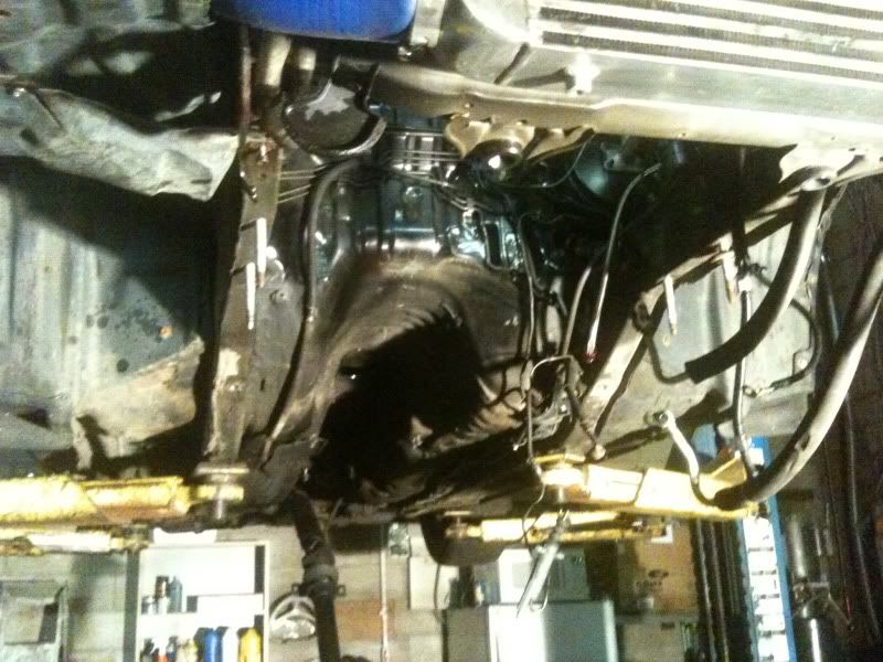

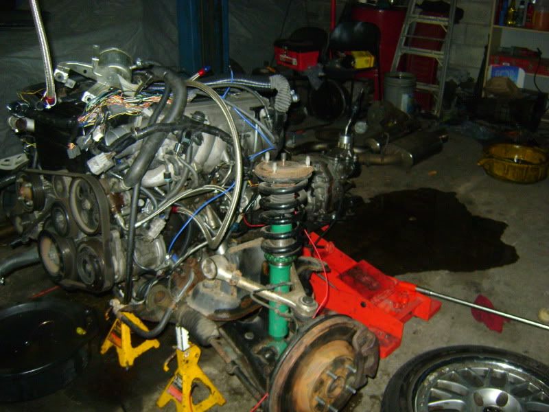

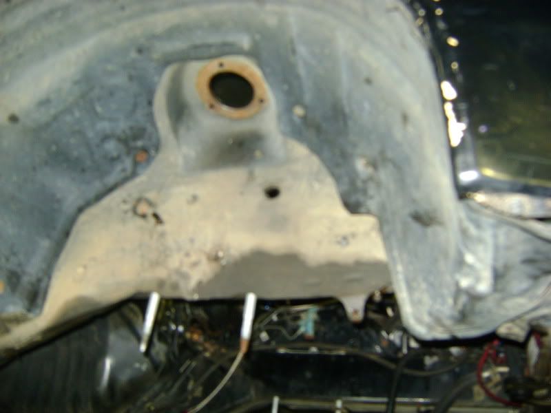

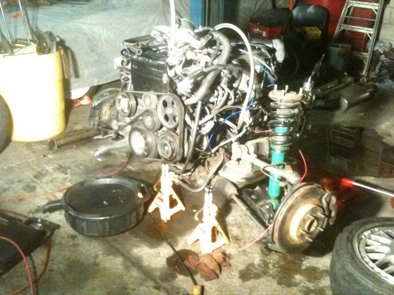

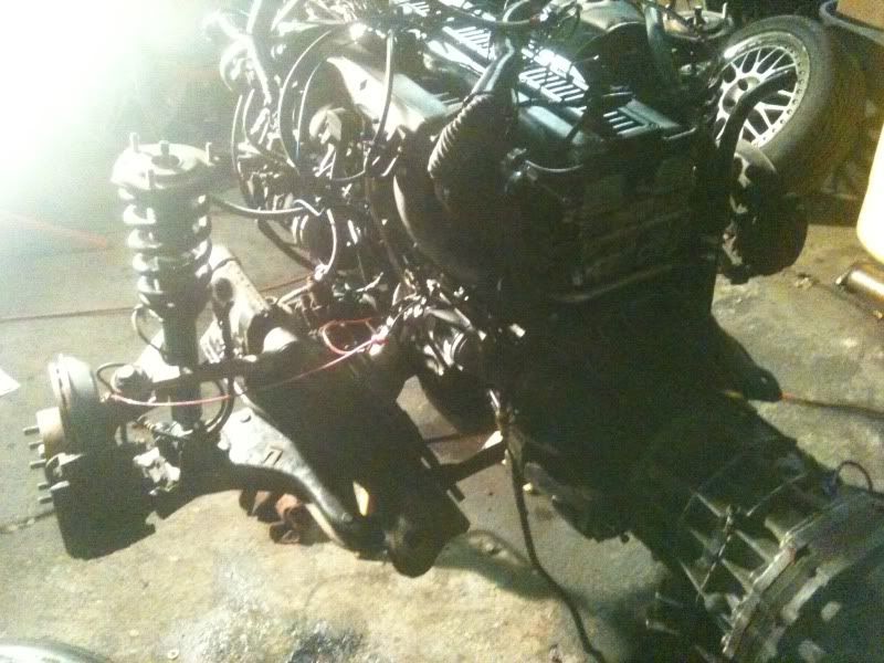

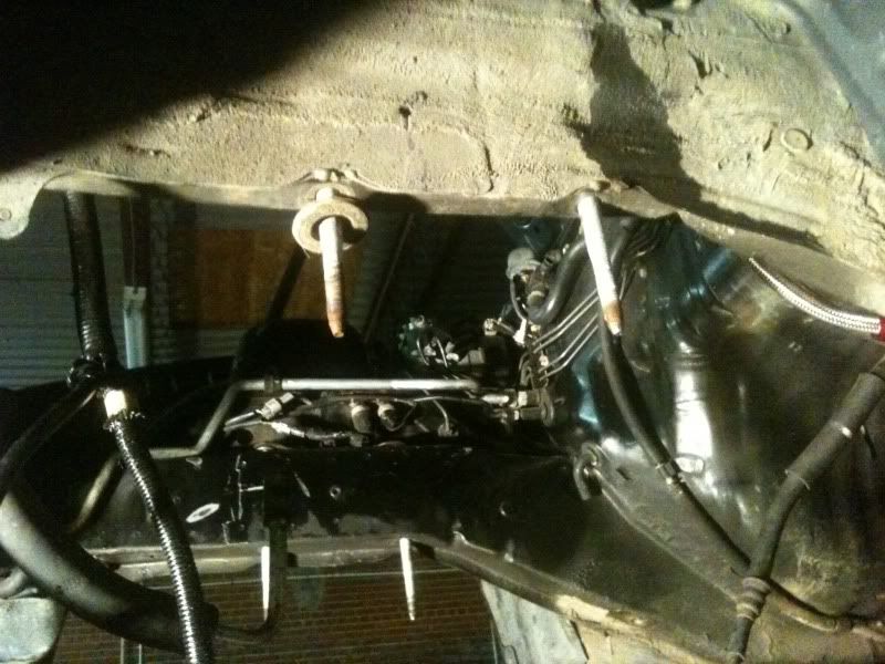

As of right now I'm trying to "fix my base". The car is completely apart. Motor/trans dropped with the sub frame. Took the motor/trans off the sub frame and put it on a dolly so I can move it around. Going to take of the control arms, coilovers and steering rack and take the sub frame itself to get powder coated by a local shop. Then I plan on taking off the under body coating and fixing all the big rust issues in the floor pan. Then I'll por-15 the whole bottom and do some kind of truck bedding coat for the under body. Then I'll order some new sub frame bushings. Put everything back together. Then we'll be cooking. In the middle of all that I'll work on the motor. Right now no real updates. I've busy with stupid bull shit around the house and garage. Once I get some work done I'll post it and get some pics! Right now I'm wondering how to get the under coating off. I heard of some people using a needle scaler and comes right off. Went out and bought a needle scaler but didn't really do anything. Other people were saying to use a wire wheel but it could mess up other parts that I don't want to mess up. Then other people were using Paint remover that sprays on. That gets really messy. Looks like its time to get really dirty! Unless anyone has other ideas or experiences that were useful. anyone? anyone?

Could you try a heat gun--type used for removing paint-and a painters flat scraper? Might be able to get the bulk off with that then use M1 remover to take the residue down to bare metal.
