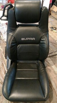

First time I had ever installed new seat covers too but I was very pleased how the came out and they still look great today. The hardest part was getting the seat back top side wings on either side of the head rest track to fit right. It took a while to stretch and fit it over to make it look good. The headrests have a hidden zipper to remove the old and install the new. Use zip ties to seat frame back sections frame wires instead of hog rings so you can pull them up gradually to adjust the fit.
You probably already know but the seat back has to be separated from the seat bottom to replace covers and than the 4 side bolts have to be re-installed and the seat material gets hog ringed and wrapped back around and re-connected to those 2 black rubber bungee cord attachments with hog rings.
Don't cut the holes for shoulder belt guide screw mounting for a couple days till the material settles, same for butt cushion side cut outs.

Zip ties were easier to use in X
How they look today. I did both front seats in July 2018
