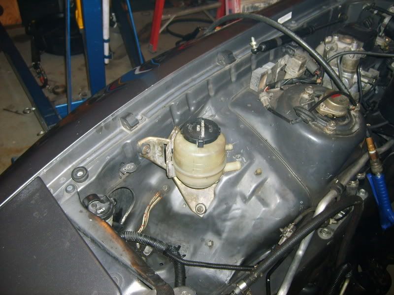

A pic. of the N/A power steering reservoir installed on my turbo. This way its off the engine and a straighter path for the air to get ito the turbo.
Intercooler removed. Any one know what this wire connection is for? Not horn, and i dont see anywhere for it to go.

Nope not overflow, it is smaller, and on the driver side. This is in the middle with the horn harness. I am thinking something to do with the pre 89 head light washer option????

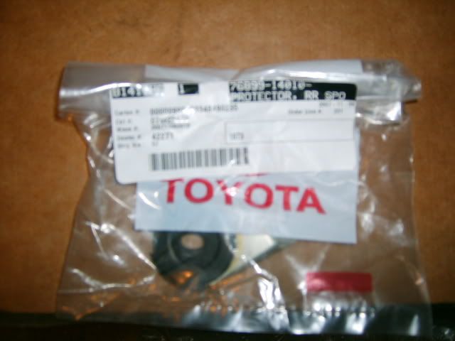

A new OEM gasket for the spoiler, where the antenna passes throu. No leaks, or cracks and only $10, well worth it.

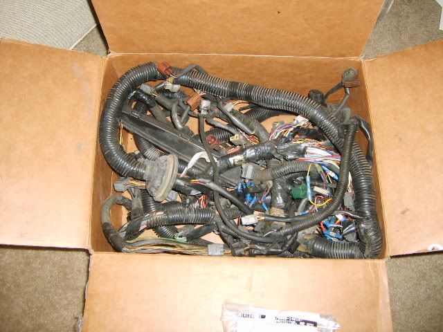

2 full wire harness. Between the 2 I should be able to replace the missing clips on mine or maybe just install one of these. O ya only $50 shipped for both of them:aigo: how do you like them apples.

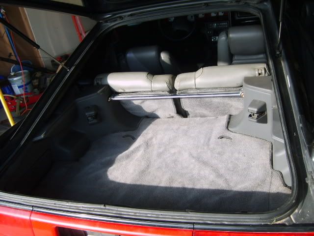

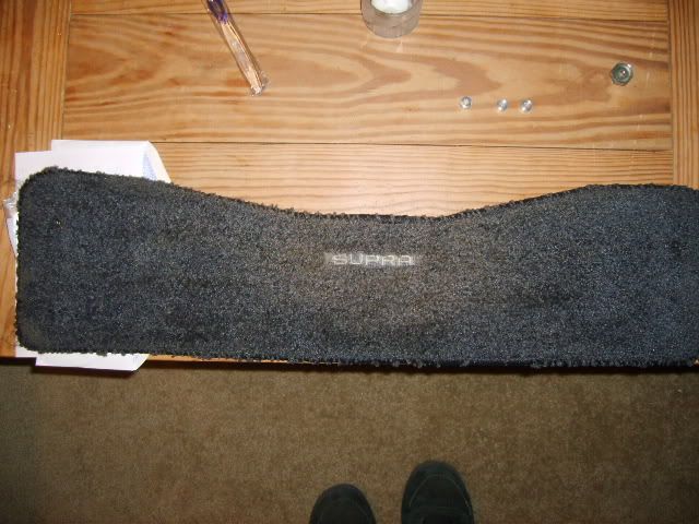

Lets see what came today, a floor mat for the rear hump. It's dark gray, not med. gray like my carpet, but it will look ok. will give it some contrast. Were these available in the US? I had this one shipped over form New Zealand,
