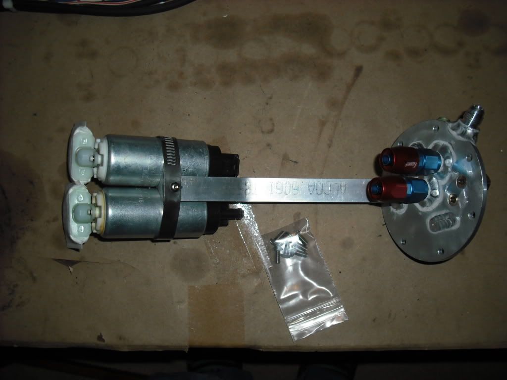

Got the dual pump hanger back so i can ste it up and plumb it in.

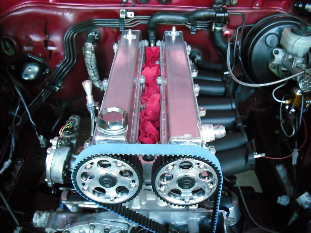

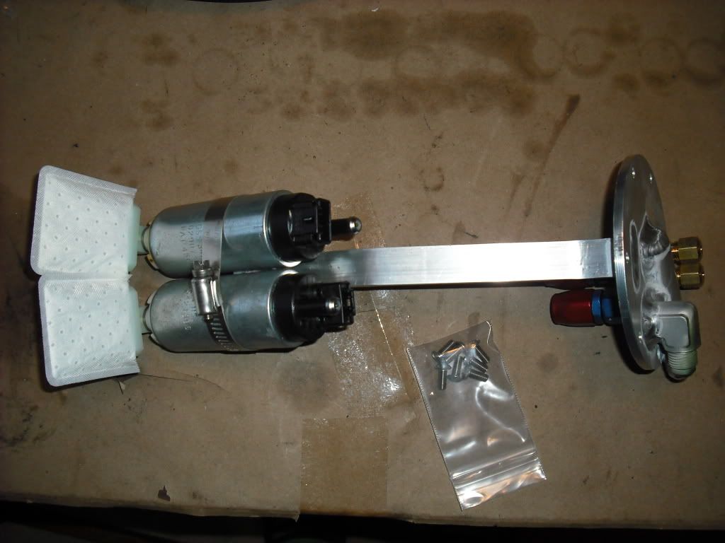

I didnt get to much done today. Valve covers are on.
And the dual pump hanger is all toghter i just need some fuel line to plumb it up then in the tank it goes.

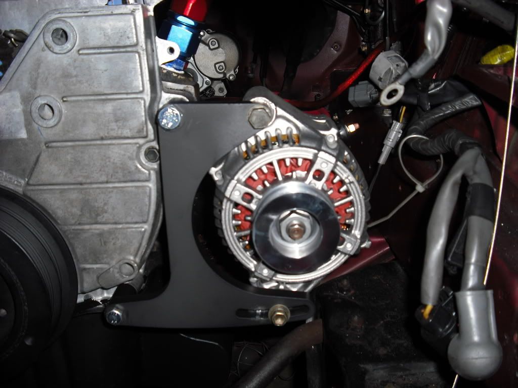

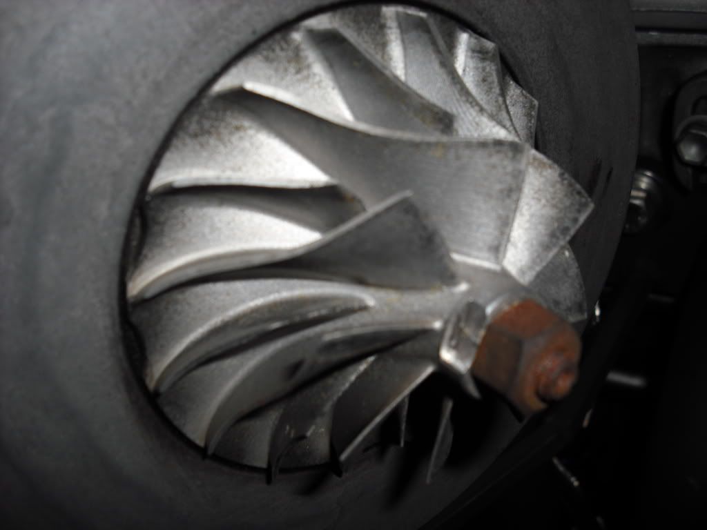

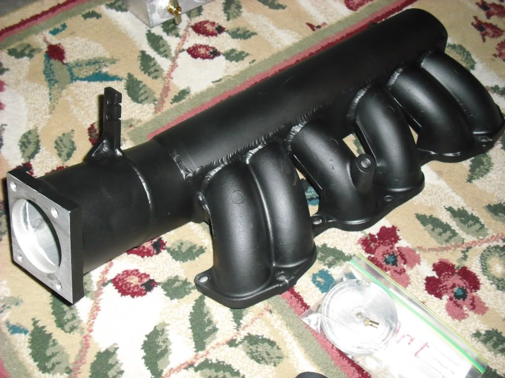

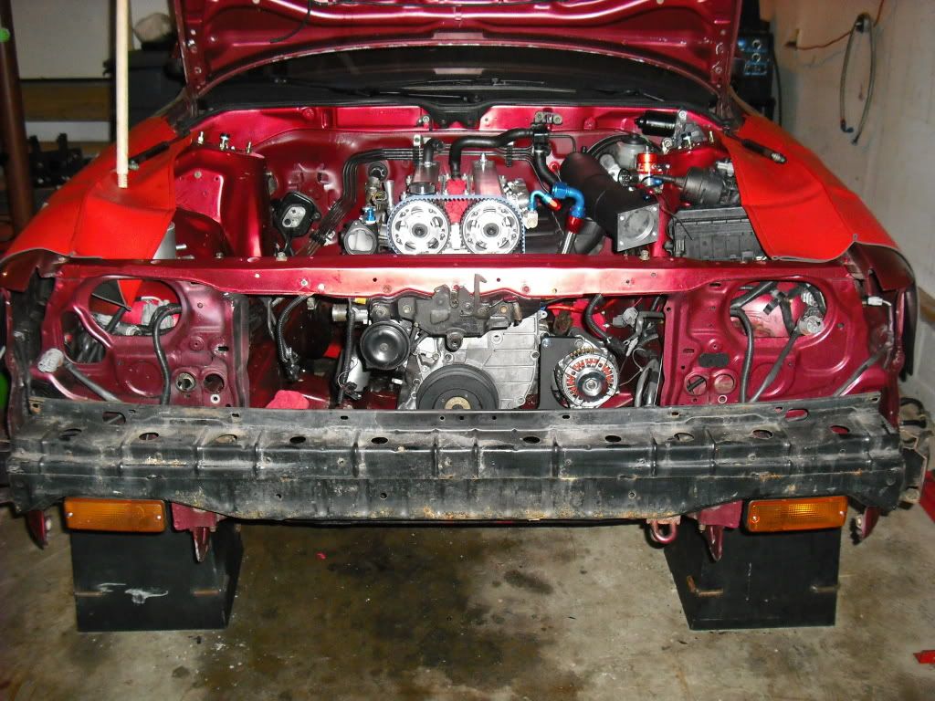

Got a decent amount done today. Finaly got the hot side side off the turbo so i can ceramic coat it. Got the slave cyilnder on and lines ran. Fixed and bolted up the intake put the alternator on. And took the front bumper and headlights off.

what size fitting did u use for that #3 vent hose to the block? i need to do this.

It is nice to see another FFIM also keeping cruise control, but yet your ditching the A/C system :dunno: Your motor is looking good so far.

I cant keep the ac with the fmic.

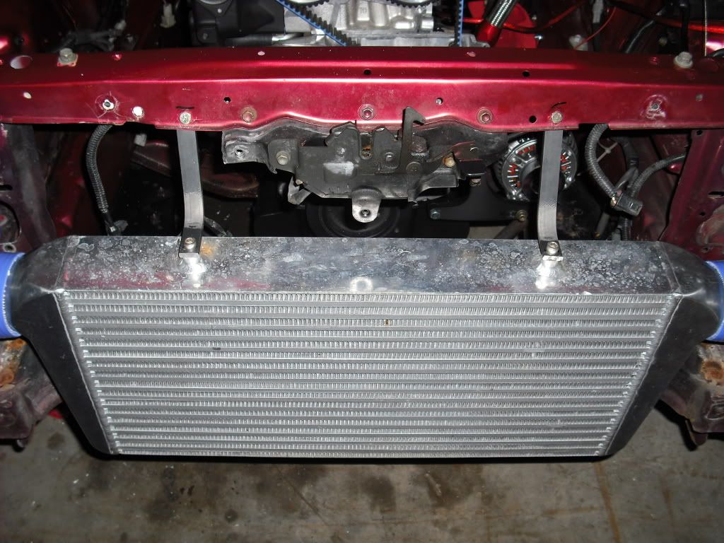

highly recommend supporting the hood latch with something. mine cracked at the base (where it mounts to the rad support) because the original bracket has been removed. i later put in aluminum supports to hold the latch sturdy.
Yea thanks im gonna build a steel one from the latch to the bottome of the core support cuz i noticed how flimmsy it is.

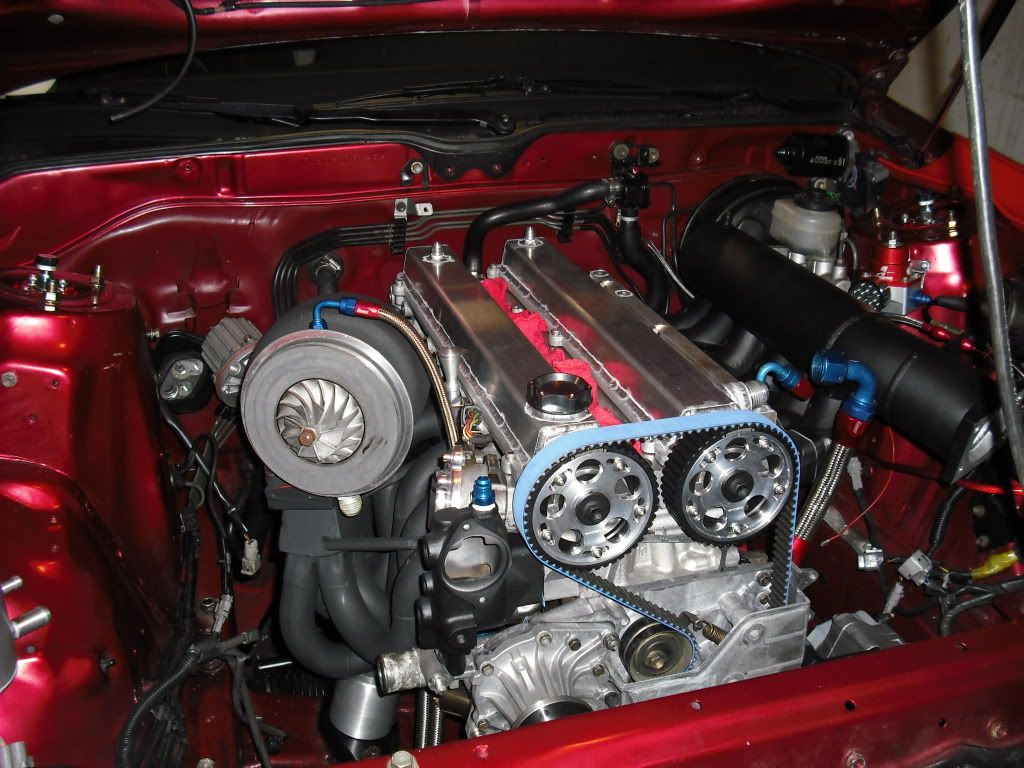

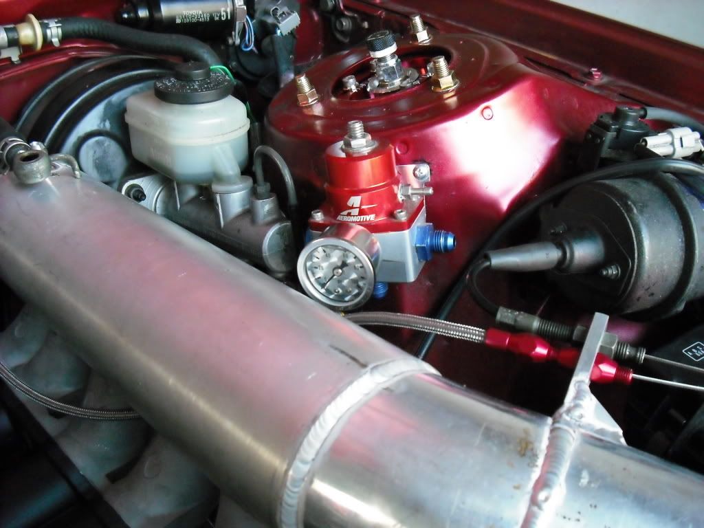

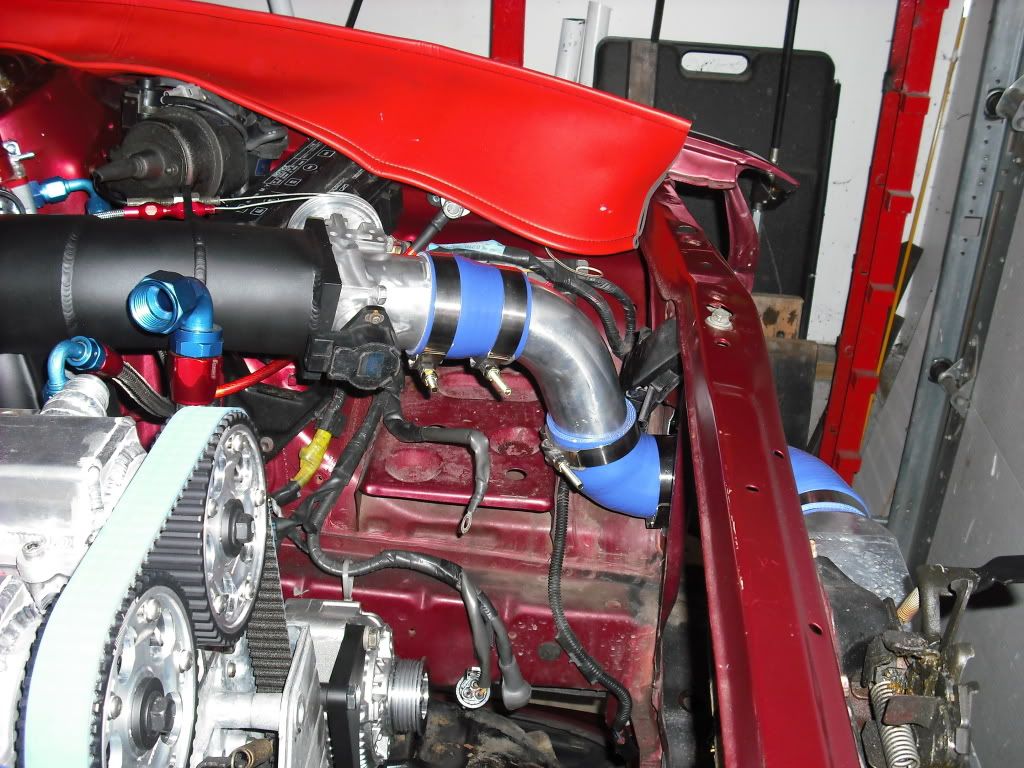

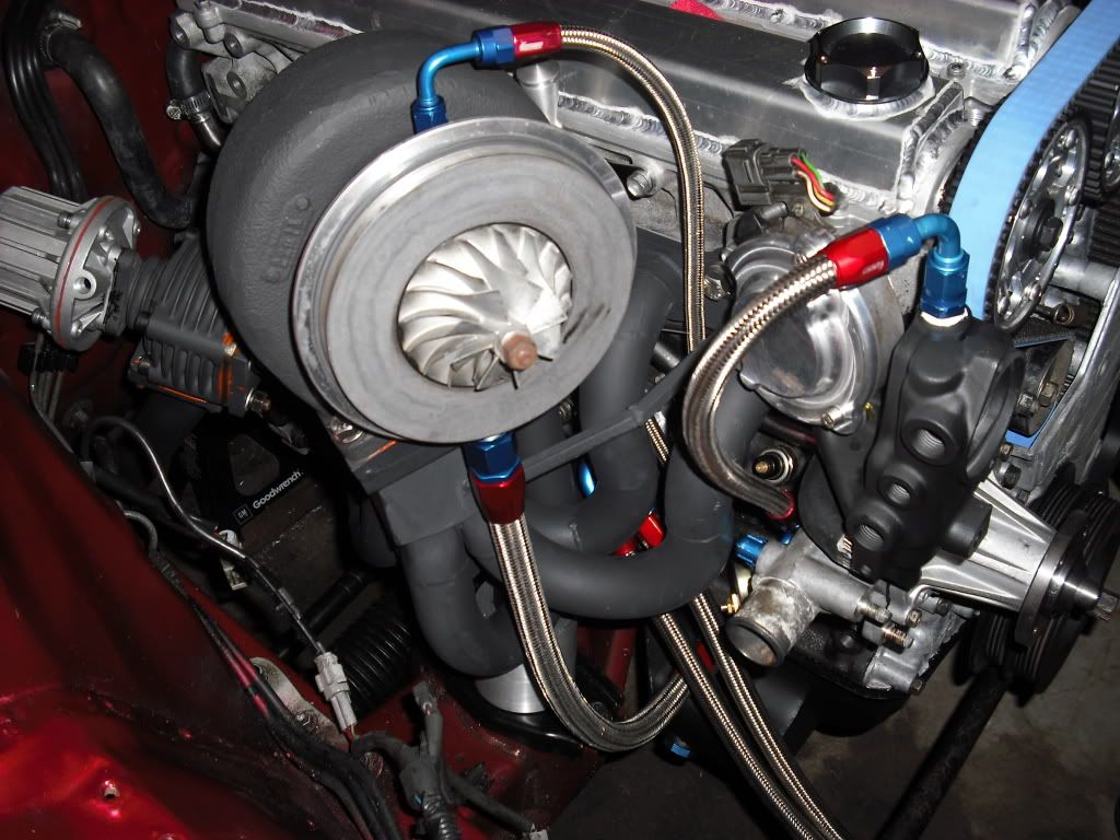

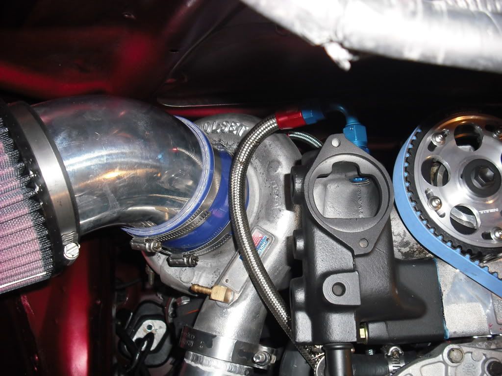

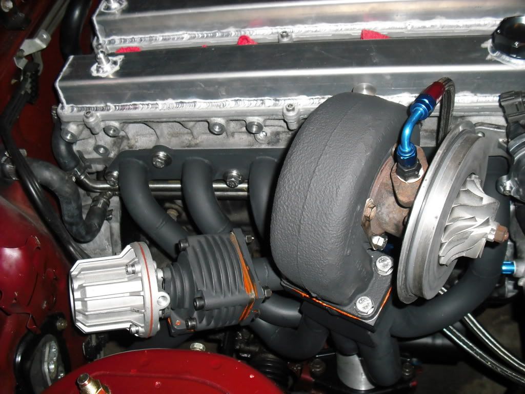

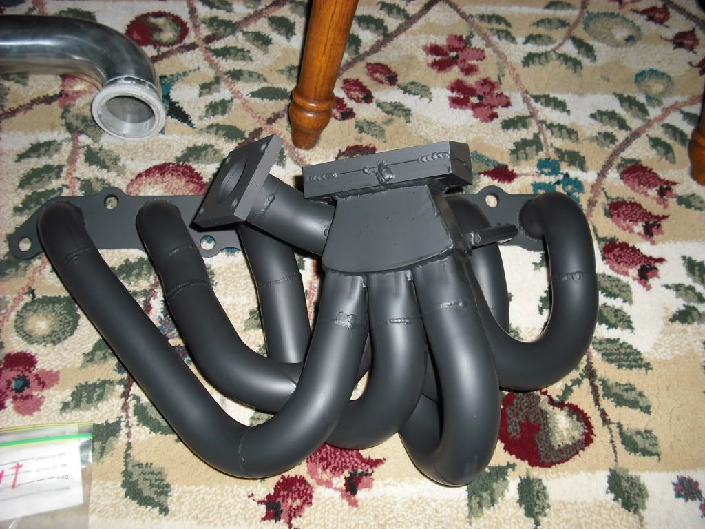

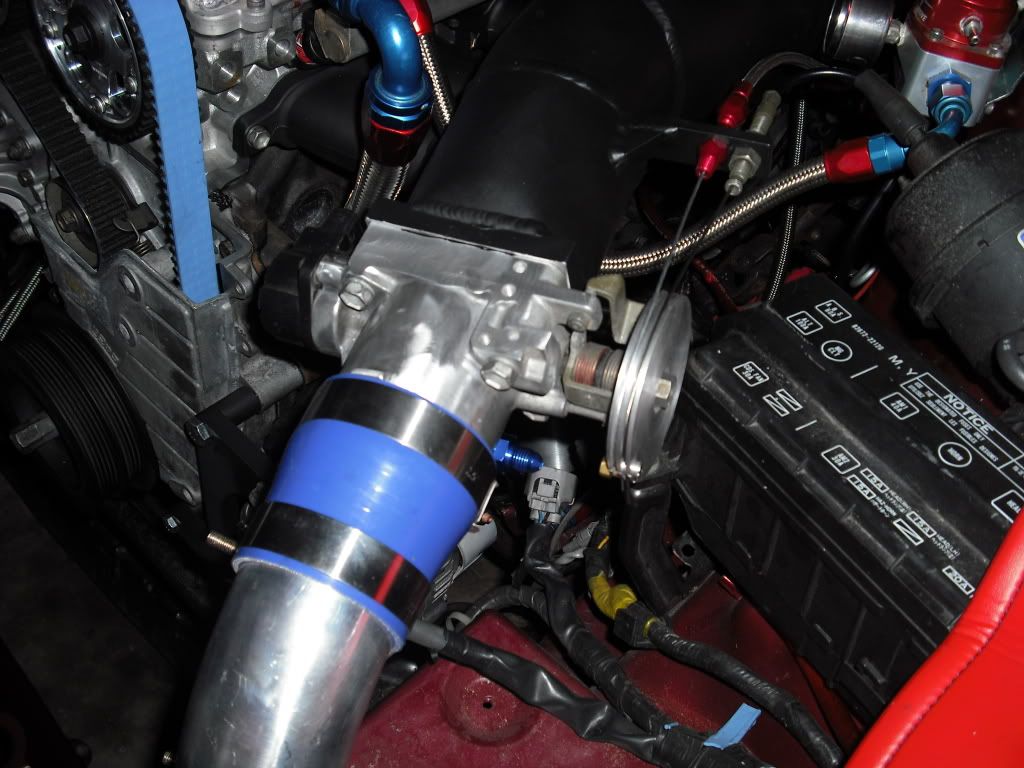

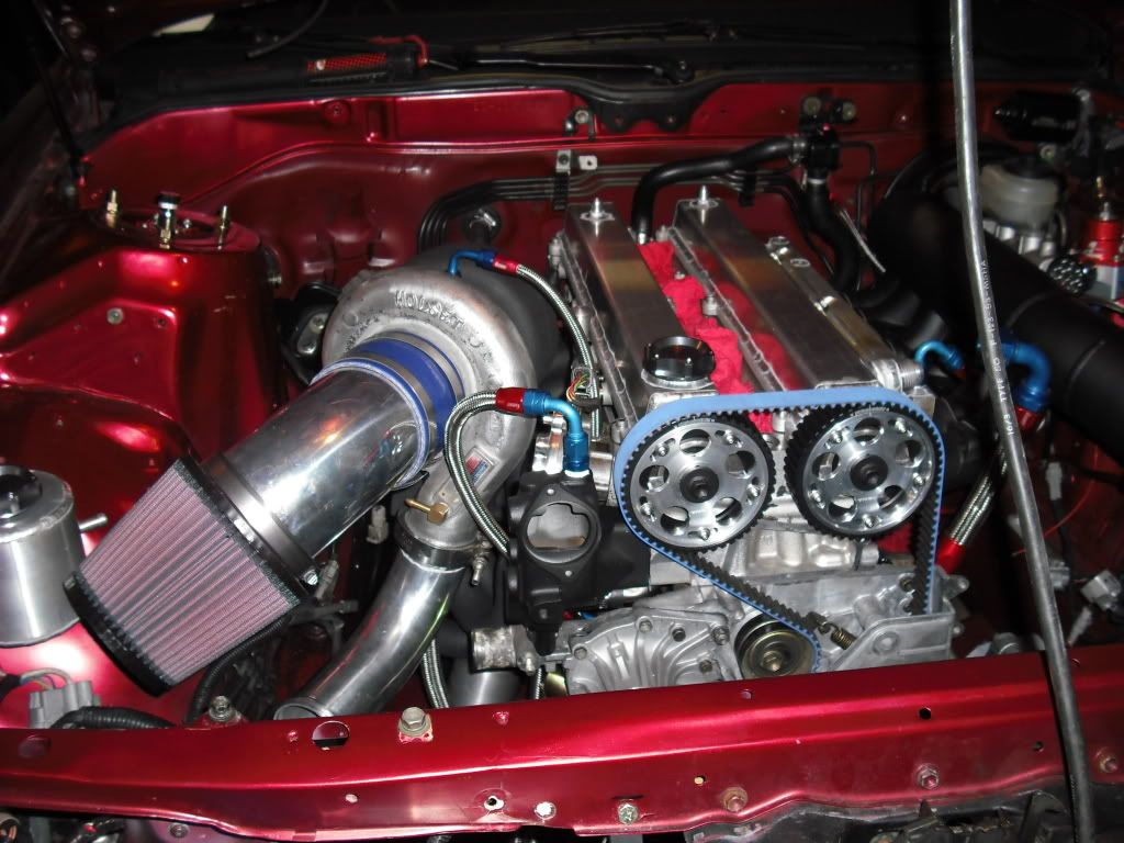

Well i got a bit done today. The turbo manifold is on and re ceramic coated. The wg and dump are on the turbo is on there are all plumbed except the boost controller. And a bunch of little things.
And i final checked hood clearance the cloest thing to it is the turbo oil feed line and it has 1/2" of clearance.

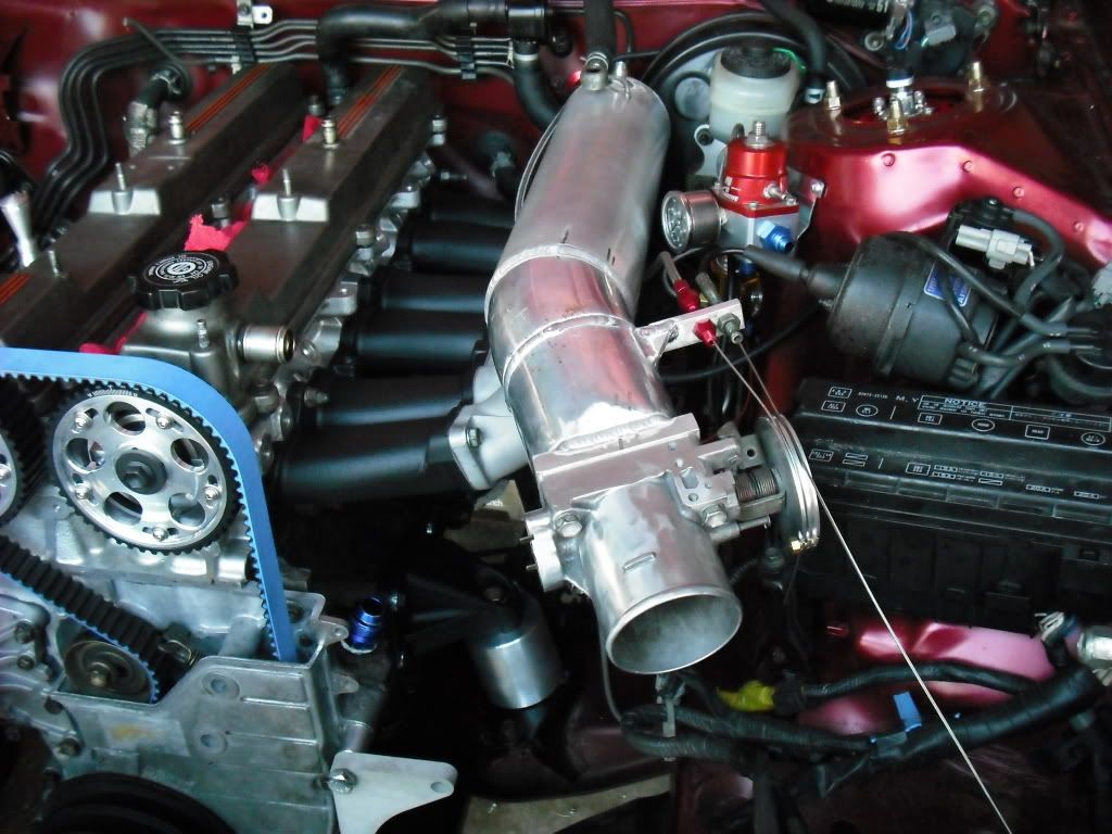

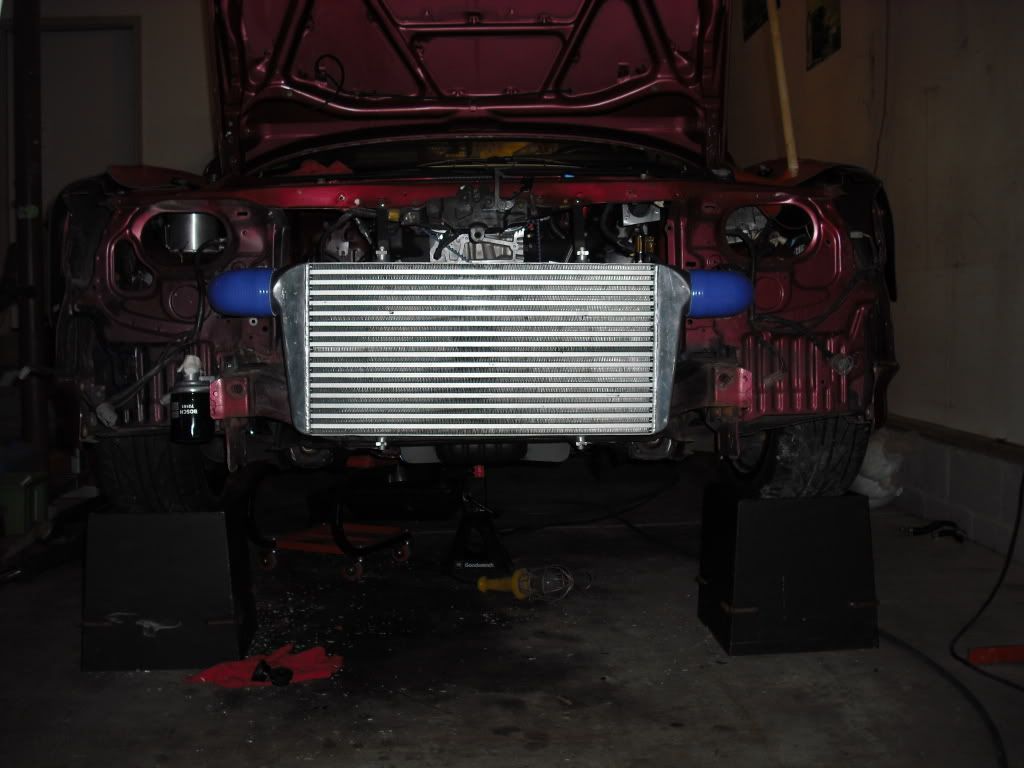

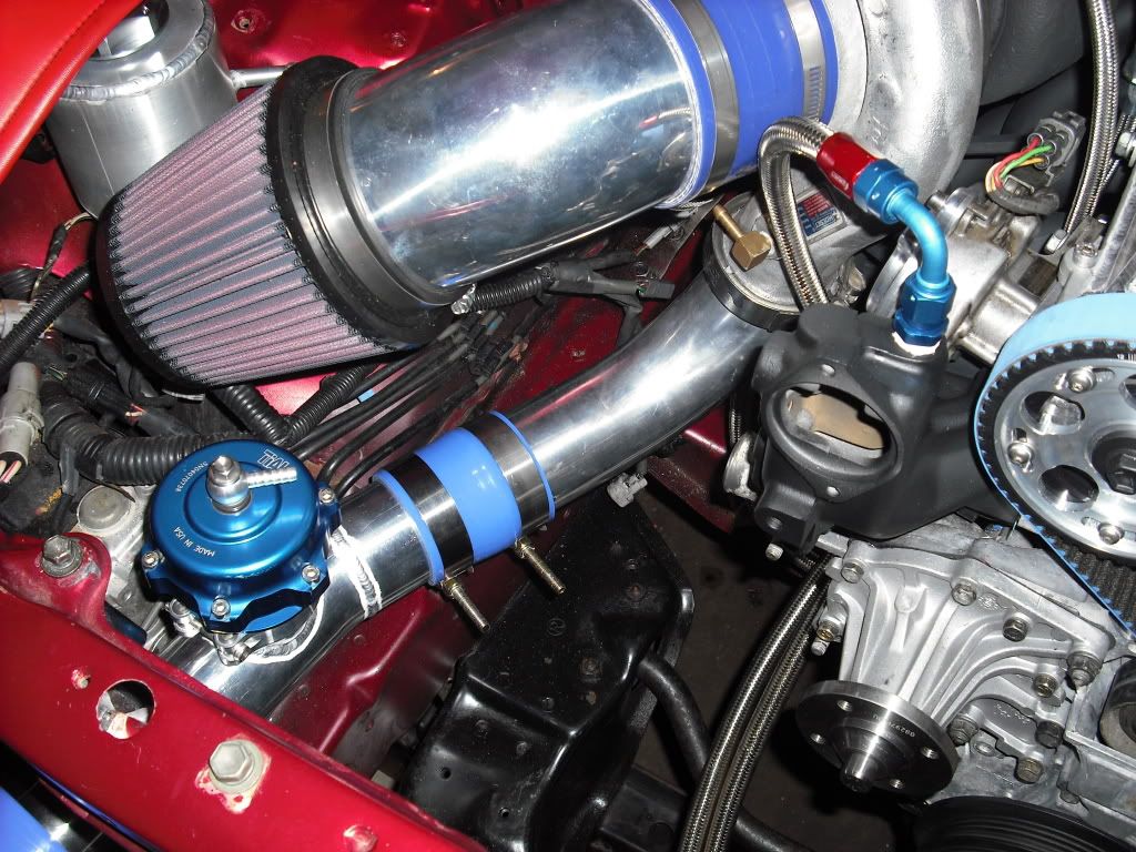

Well today i made all the intercooler pipes so all i have left on them is the intake air temp sensor bung and the meth nozle bung.
