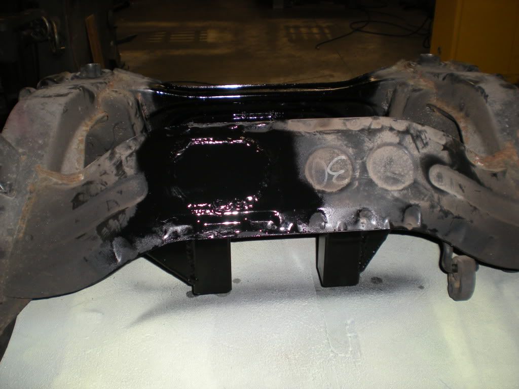

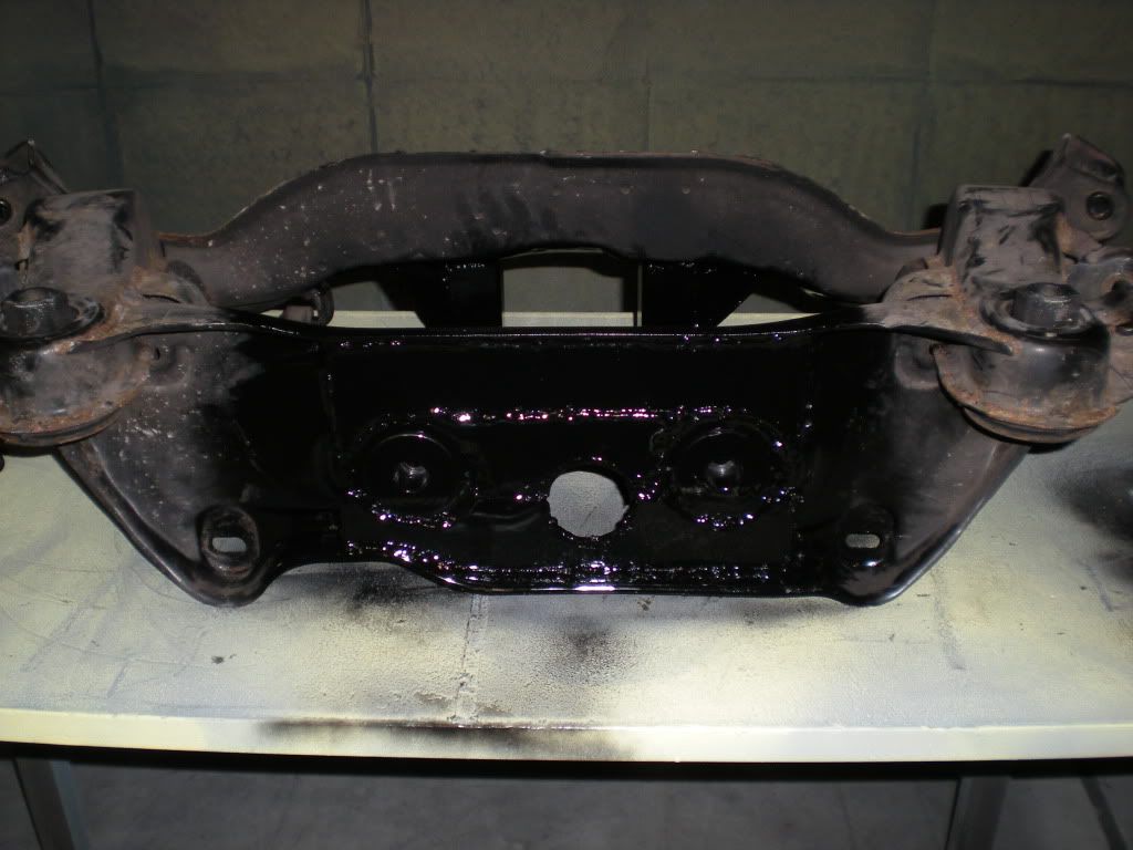

Well today i droped the tank and rear subframe. Its time to upgraded the fuel system and do the mk3 diff swap. Also im gonna beef up the subframe before i bust it.

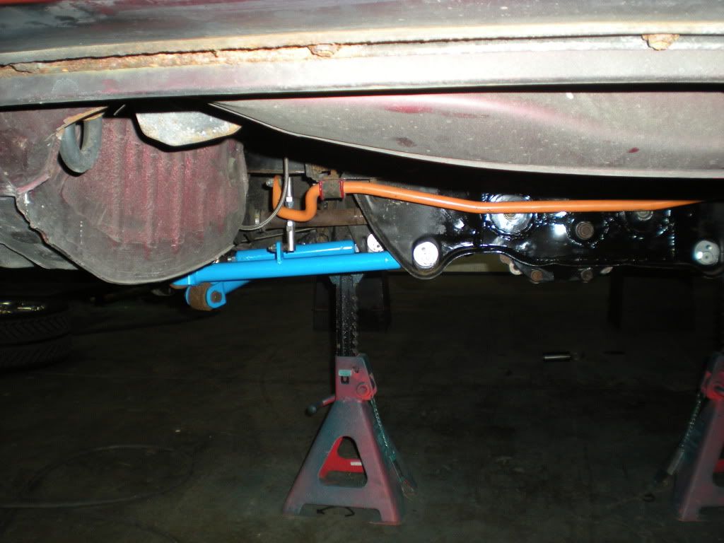

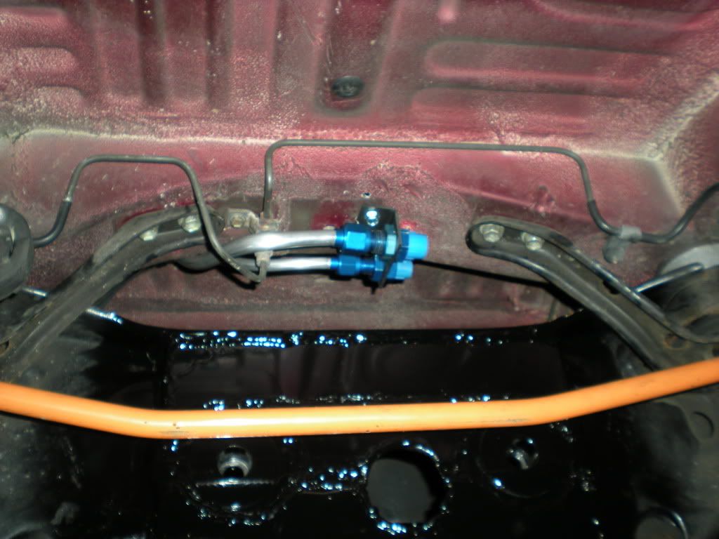

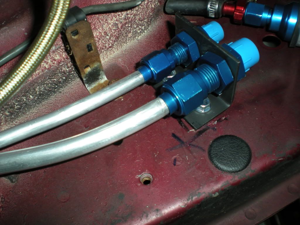

Well i finshed up my subframe and got it all painted up.
Ran all new hard fuel lines. -8 feed and a -6 return.
Im getting the -8 bungs welded on the rail and pump hanger today. Next weekend i have to buy new braided line rated for e85. And put the RC 1000CC injectors in.

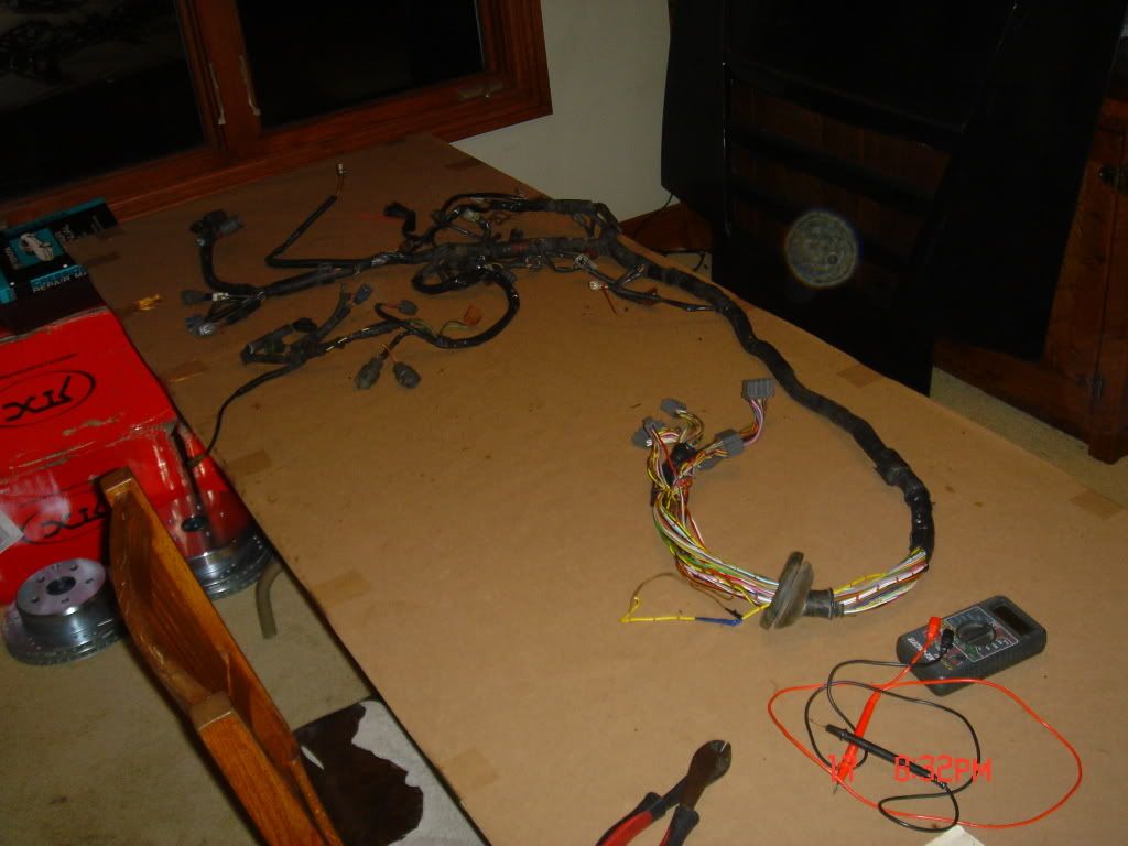

So i can do this pain in my ass wiring for the swap.
You must have spent at least $30.00 on that meter. ;)

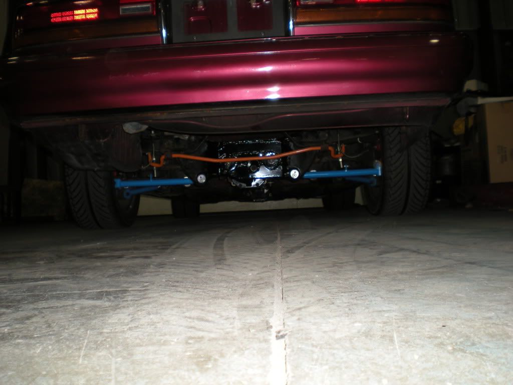

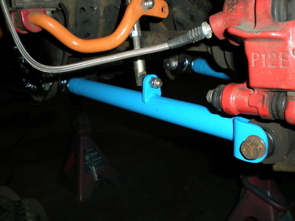

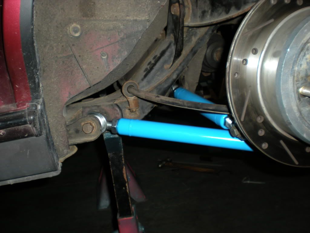

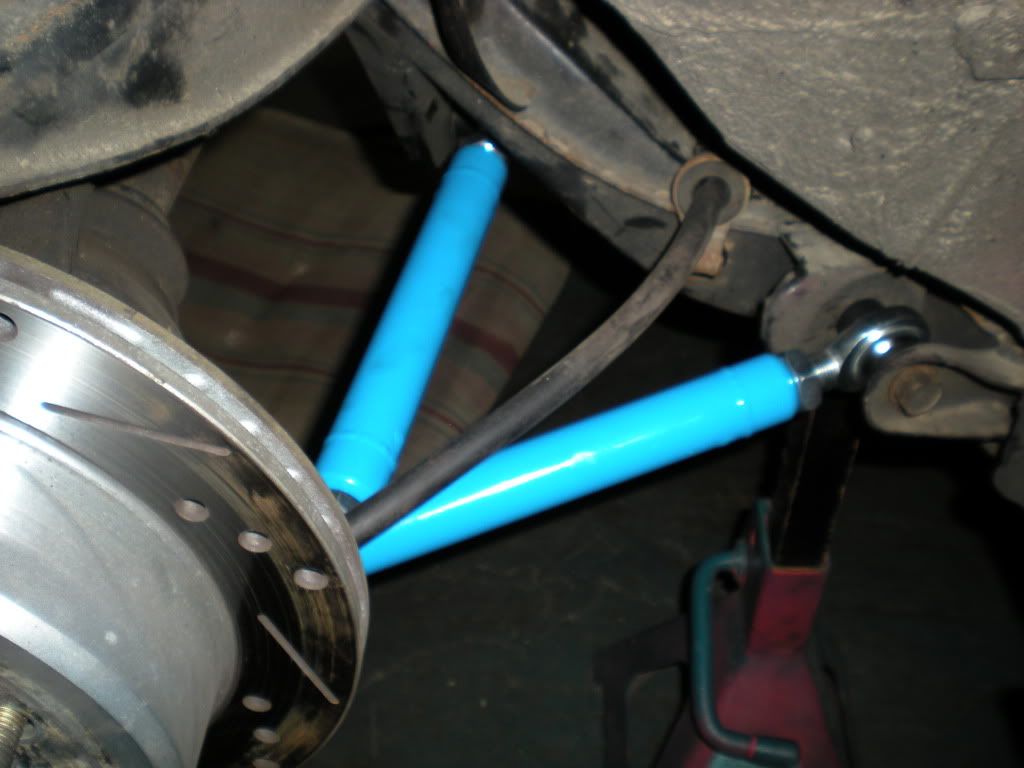

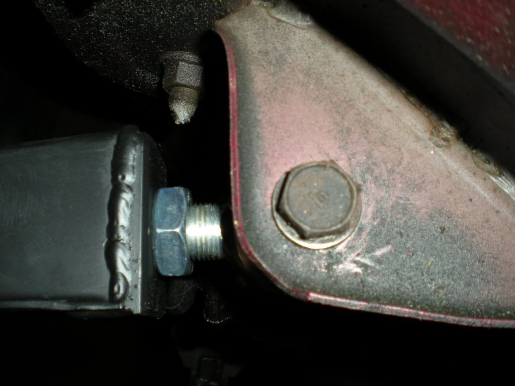

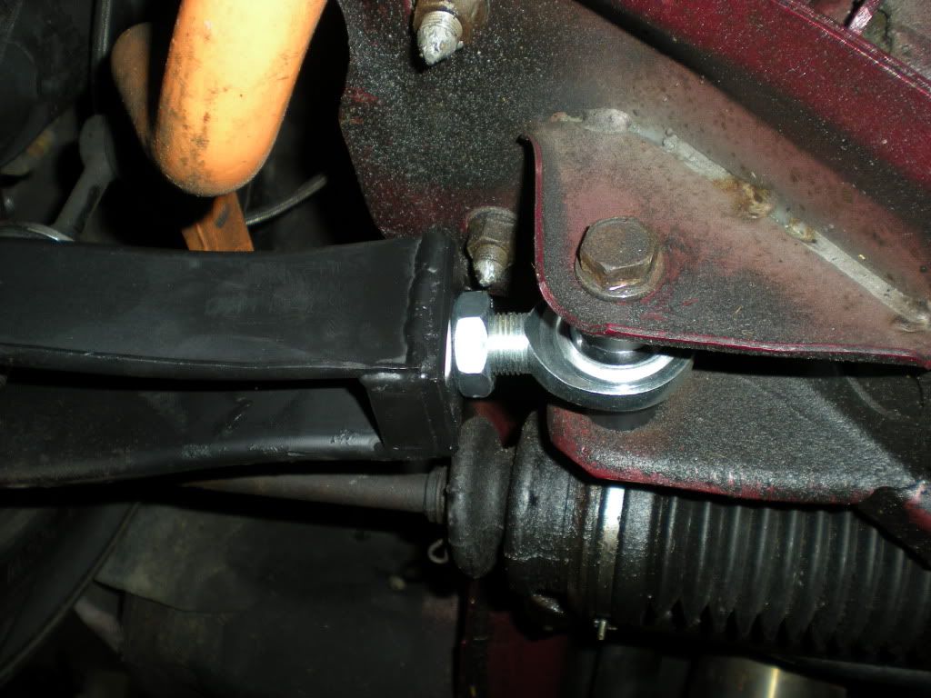

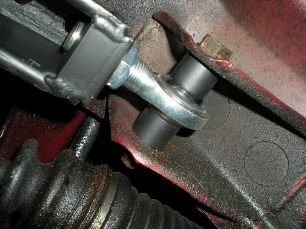

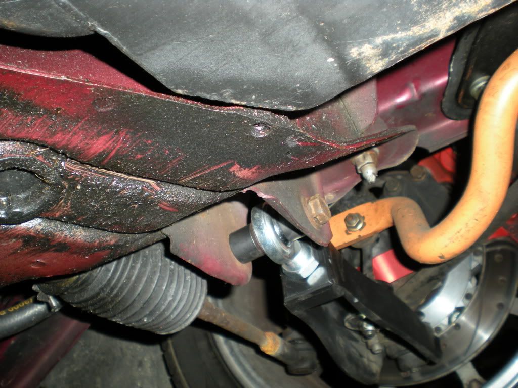

Well i some how never posted the pics of my adjustiable front control arms and the rear tube arms i make. So here they are.
FRONT
REAR
What do you guys think?

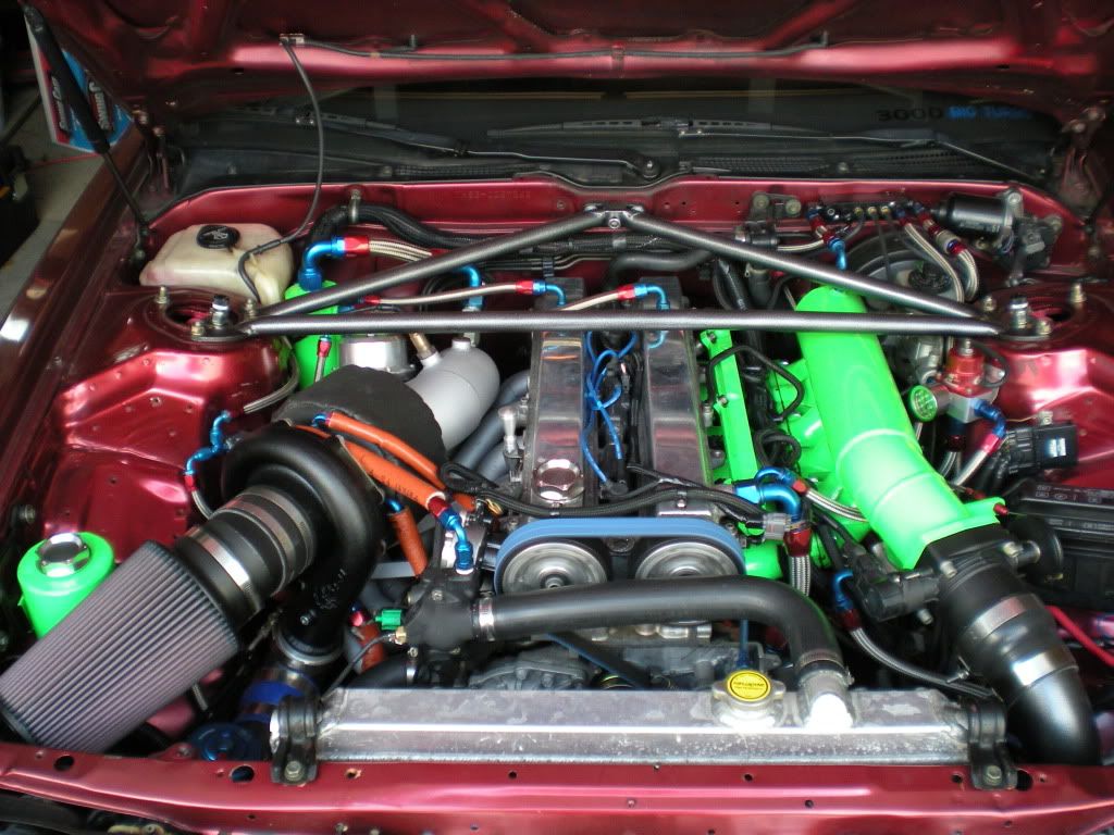

Well i know its been a while since i have posted in here but ill thorw up a few pics of the new setup which is about to change.
The turbo is a ITS GT74X Dual ceramic ball bearing.
The car made 668 HP at the wheels on the dyno at 28 psi On the street it makes 34psi so were thinking over 700 hp easyly.

Looking good Wes. I kinda like the black compressor housing. Is that horsepower on race gas or pump + meth?
Think you would be able to make a triangular brace like that for the Supra? If so I may be interested down the road.

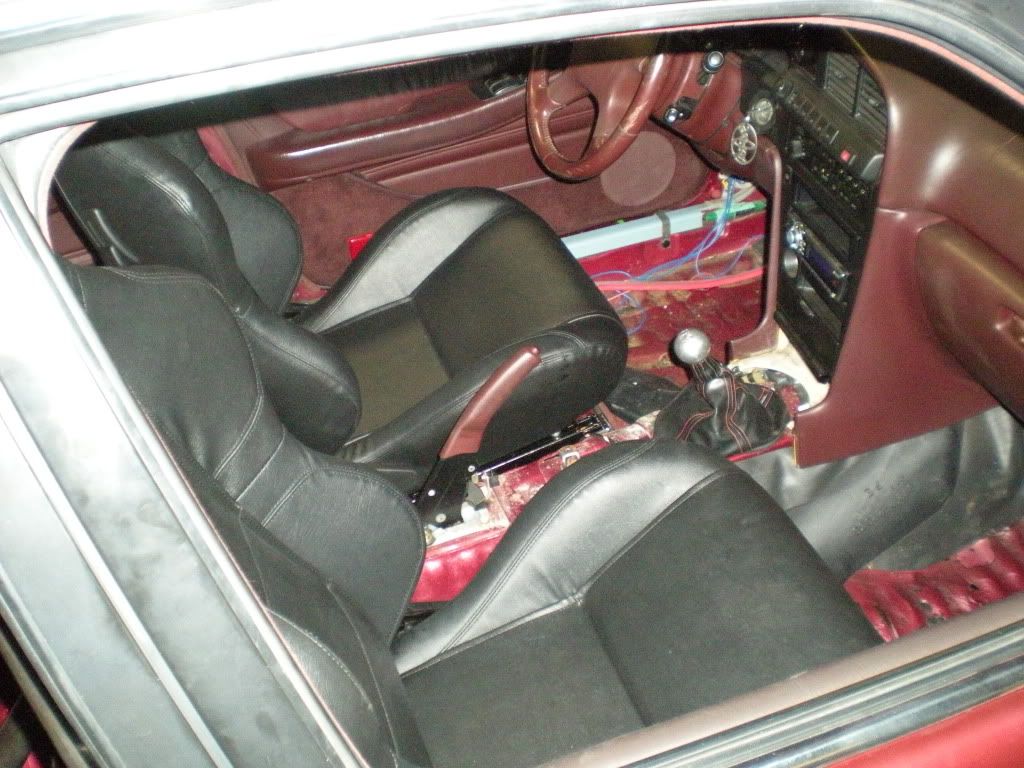

airhead04;1794381 said:

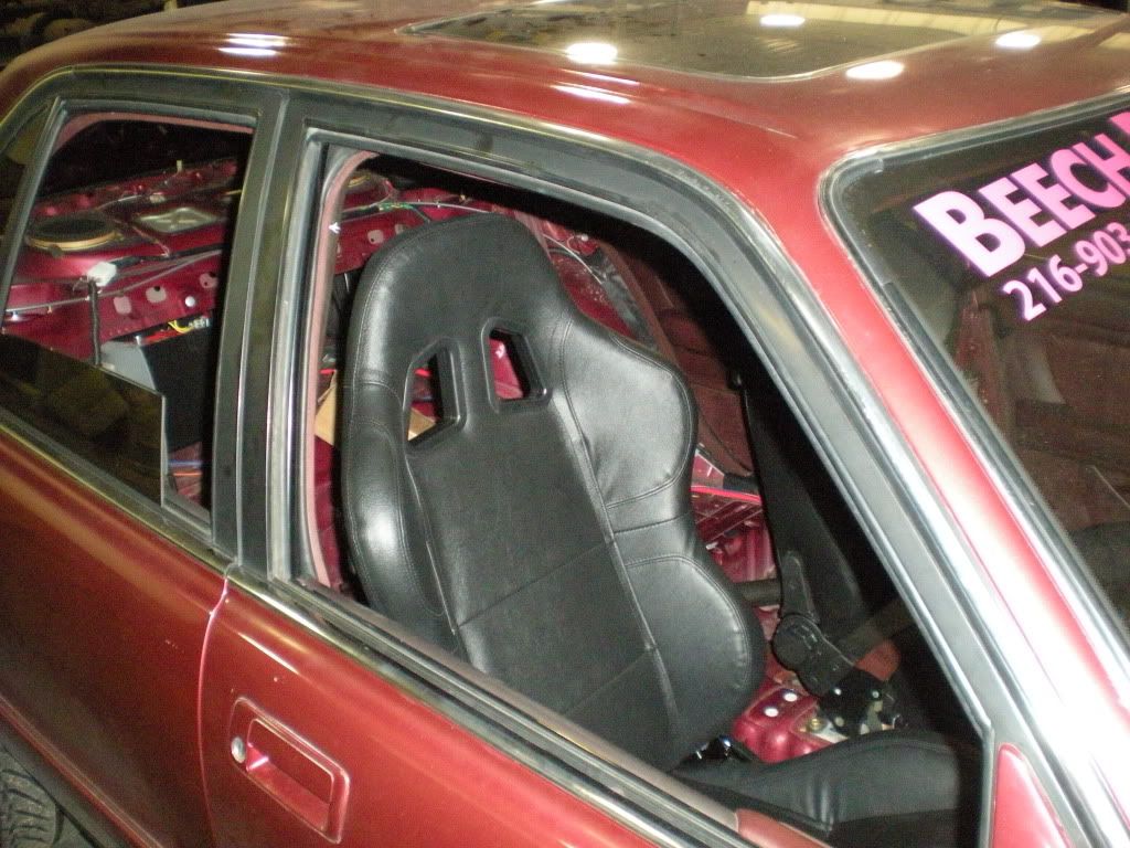

Hey wes I know it's been a while but could you give me the name of those seats you put in the Cressida and the company you bought them from?? Please sir. Thanks man!!!
They are from summit racing and they are summit brand.
I'll have to look into it but I don't see why I could not be able To make a triangulated strut bar for the supra.
