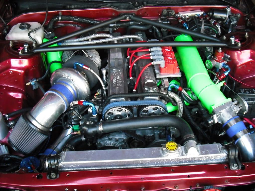

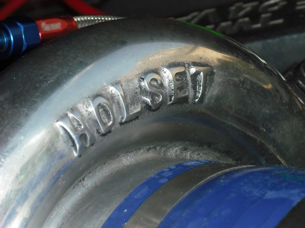

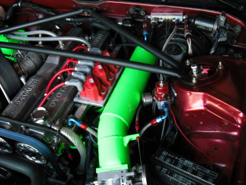

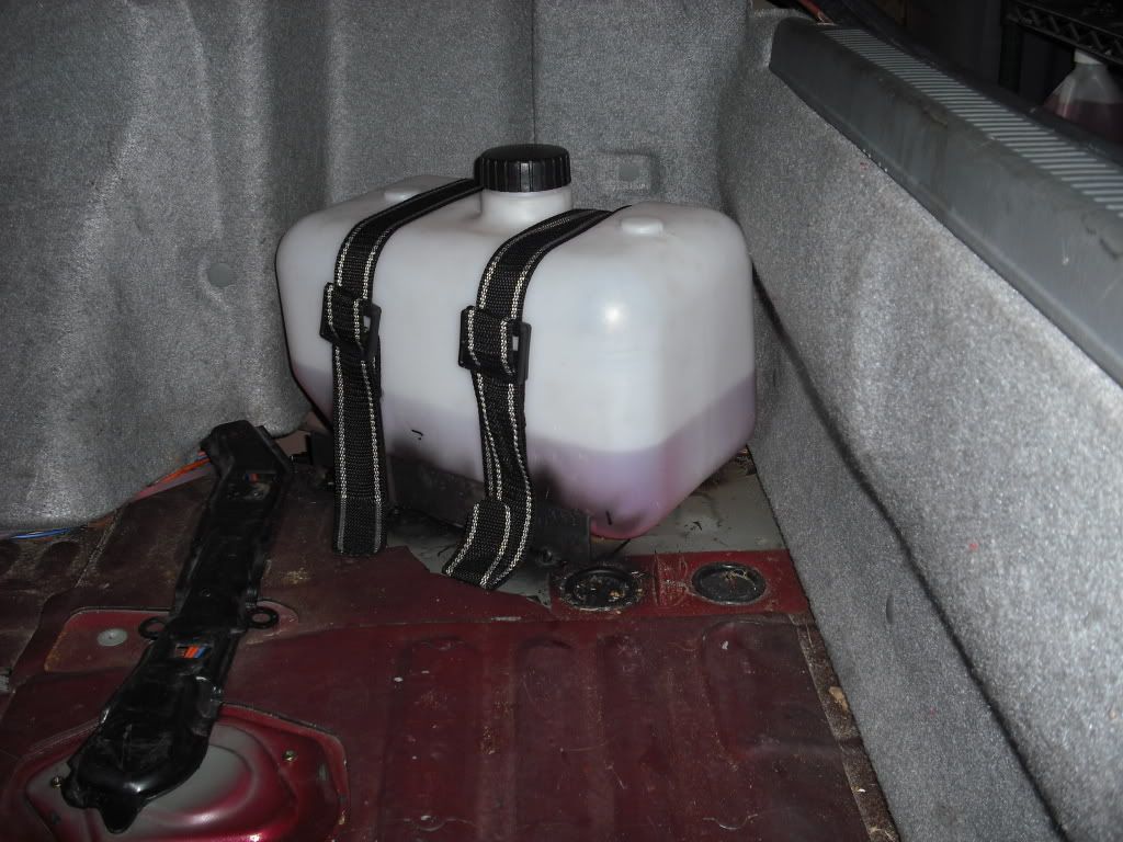

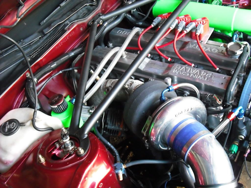

Ok well i have not posted much latley or any pics so here they are.
