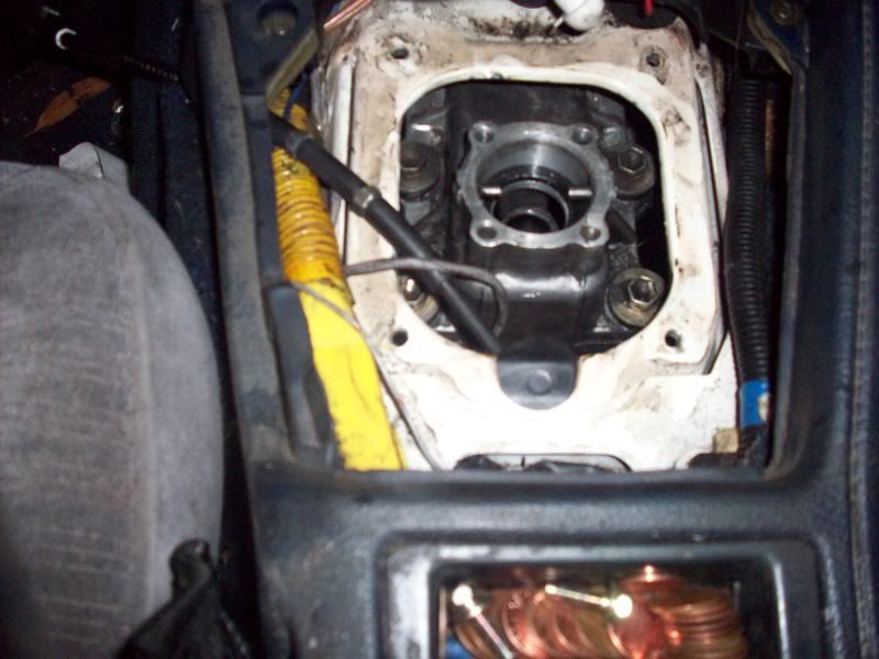

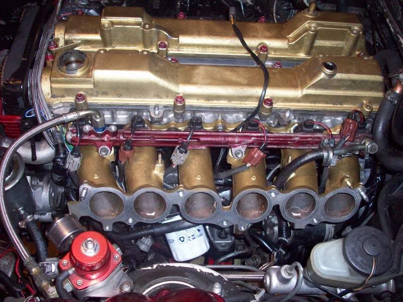

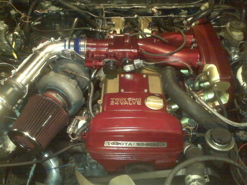

mini update... basically done with wiring. all sensors installed except o2 and cps. all mounts on, driveshaft in. upper plenum on. etc... now for pics.
jeff working on the o2 sensor wiring.
how the wiring looks around the lower plenum.
upper plenum on.
shifter location.

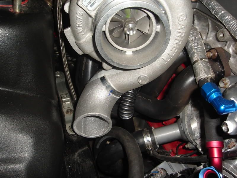

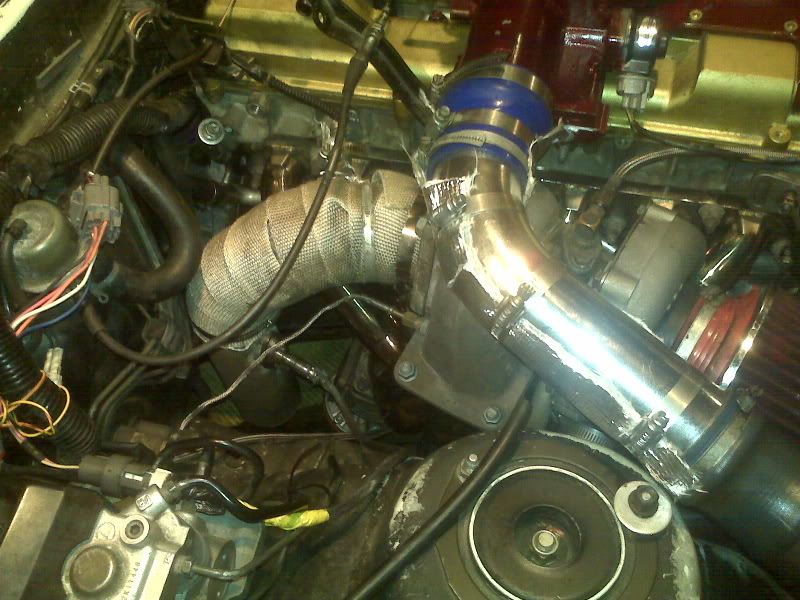

god i hope so, sorry for no update pics for today... i'm friggen tired working on this thing. i'm re routing all the intercooler piping. i took some cool pics, but i'll need to upload them. i finished the wastegate clock and the downpipe. so, i'm closer.
tsuper92
supra addict
Apr 7, 2005
1,376
mass
how's the manifold and turbo fit with the motor in the car?you going to have clearance with the turbo clocked like that?i'm just wondering because both my single's(1j and 2j)needed an elbow welded on because of being close to the frame

I needed the turbo elbow also
i got around that for now :icon_bigg

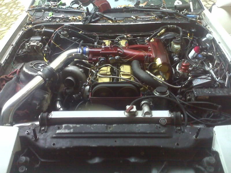

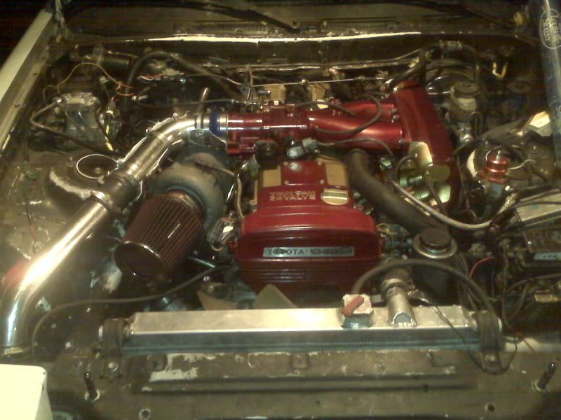

so, after getting to drive the car with this engine in it. i must say, it feels like it almost has more torque than the 7m. the engine runs quite a bit smoother, power delivery is nice and smooth also. plus at 4-5k rpm it sounds awesome! i'm currently at 7-8psi and it feels nice for this amount of boost. i'm having a problem with an oil leak at the cps. hopefully tomorrow i'll get that taken care of. other than that... no issues. it starts instantly, revs well, at idle even with an open downpipe its about as loud as a stock supra. so far, this engine is badass. after i installed the engine, it took about 3 cranks for the car to fire up the first time. videos are coming tomorrow.
pics...
downpipe/manifold area

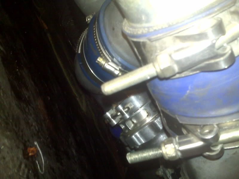

i routed the intercooler pipes under the radiator, and there's about 4" of ground clearance. this pic shows its kinda busy under there.
