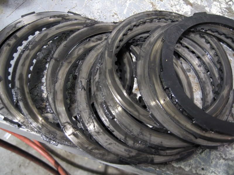

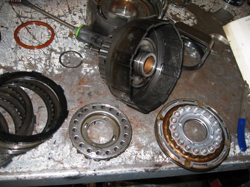

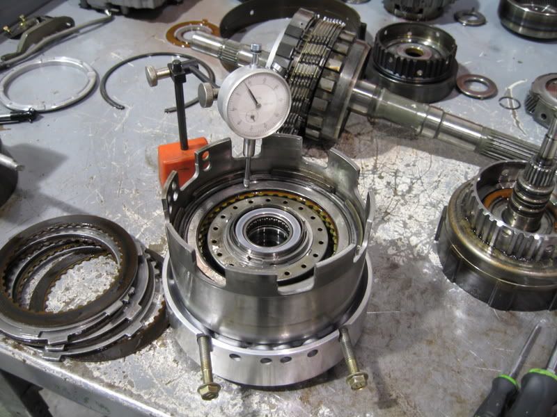

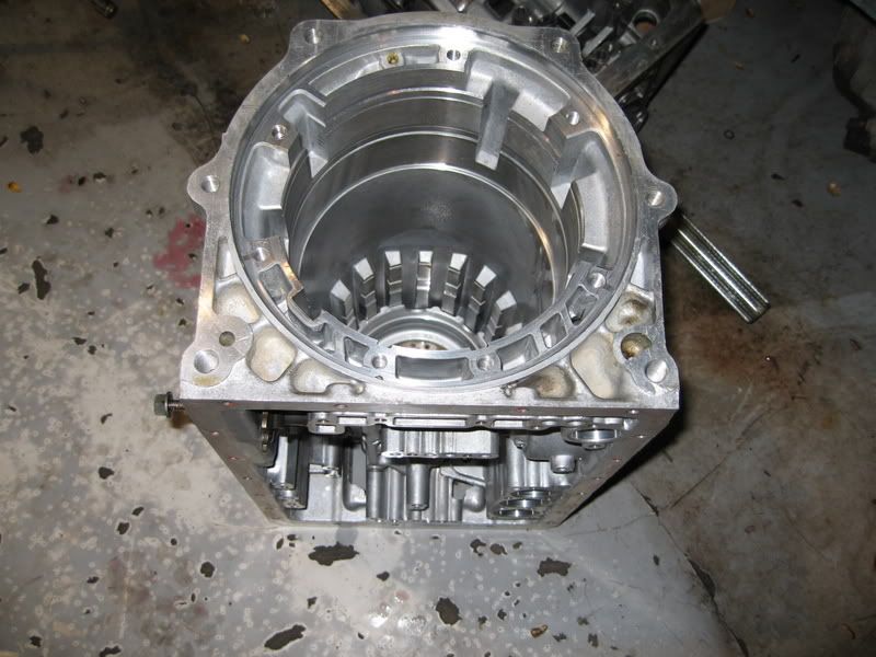

Almost back together with the trans, pics for those who give a rats ass about rebuilding an auto.
Nice cleaned up gutted out shell
A picture of "NO FUN", heres all the guts!
Checking the rebuilt forward clutch
Nasty stuff in direct clutch housing
THE CULPRIT.....Direct clutch pack cashed, metal to metal....no friction material left on friction plates!!

Wow!!! So thats what the inside of my transmission looks like. Thanks tookwik I can die happy now...........................lol :biglaugh:
You are a much more smarterer man than I cause I would have no clue how to put that back together!!! :icon_bigg

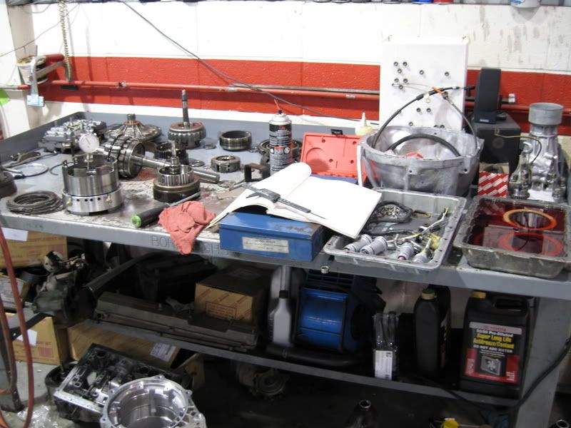

LOL...Notice the very detailed and informative a340e overhaul manual on my bench? Im no genius, just very mechanically inclined.
