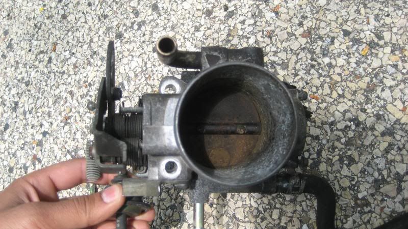

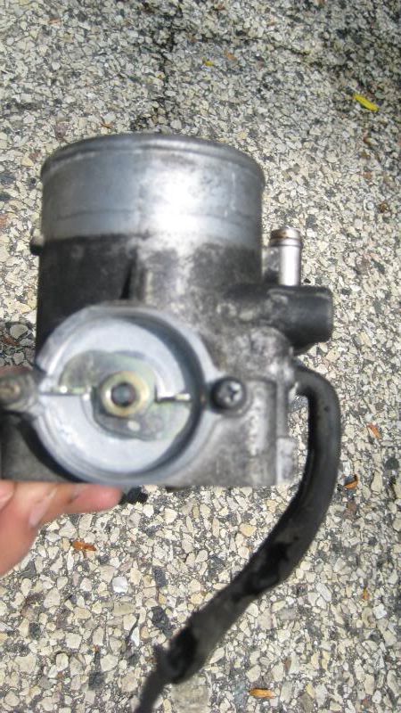

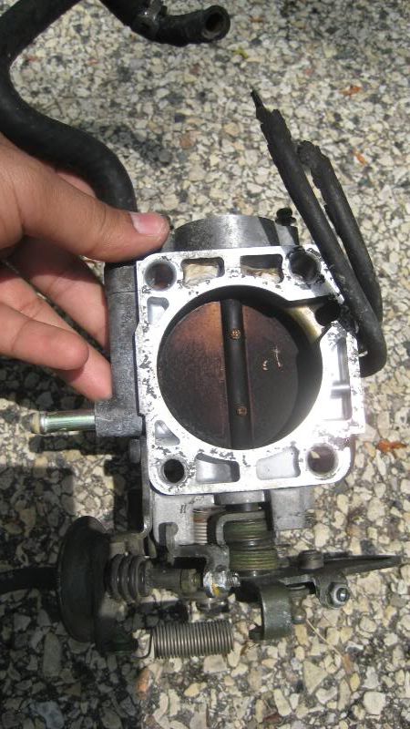

I have one lying around somewhere. I got the honey comb out and one of the tems cover out! :) i had couple of mins of free time before i had to go to the CUBS game.

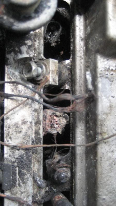

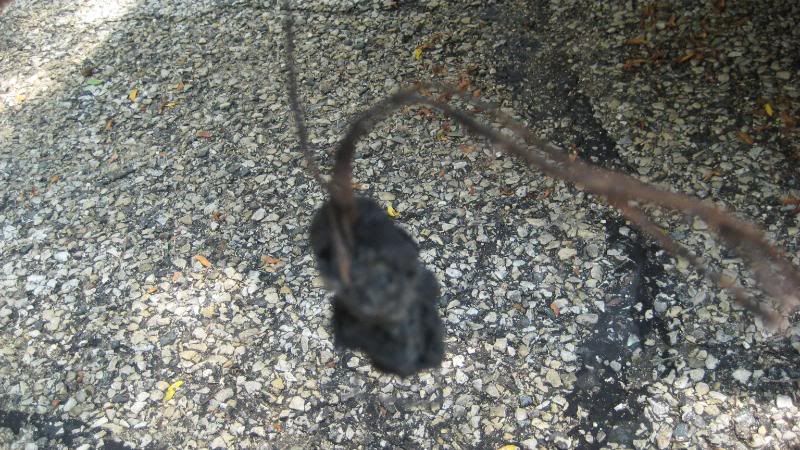

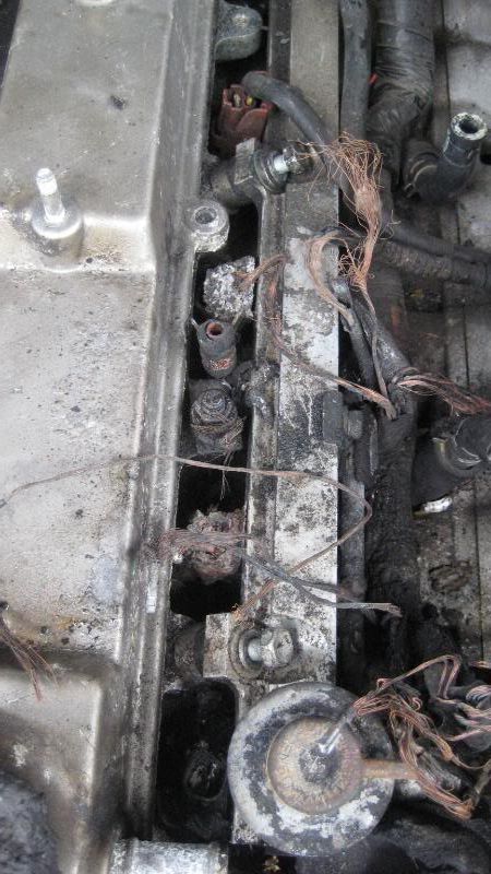

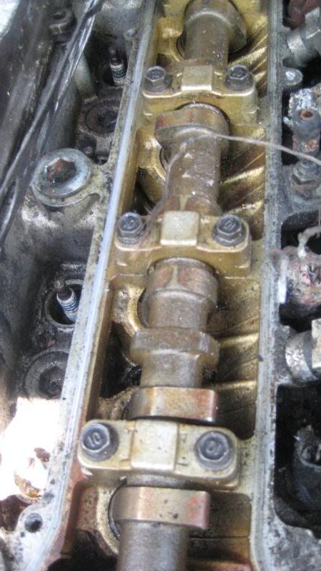

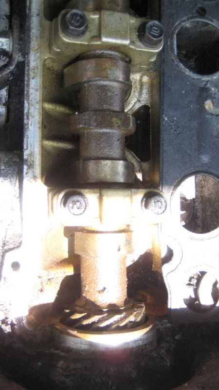

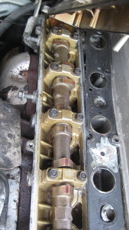

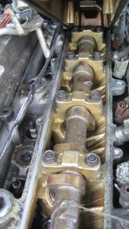

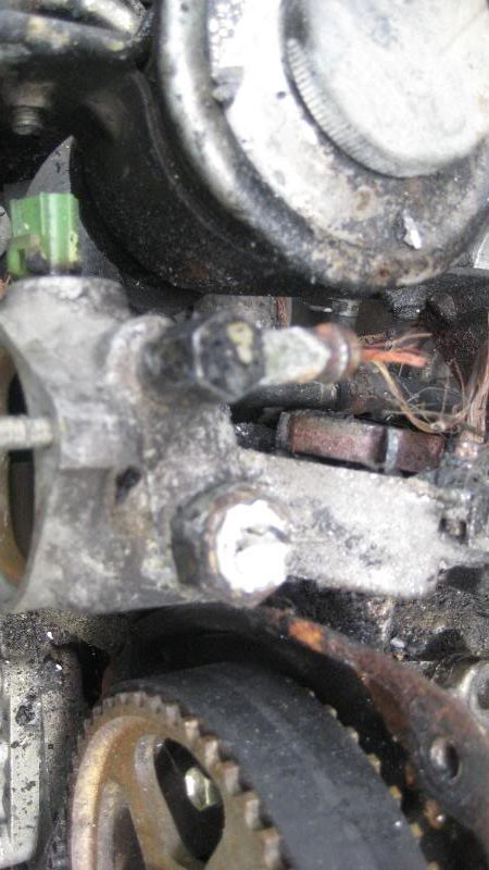

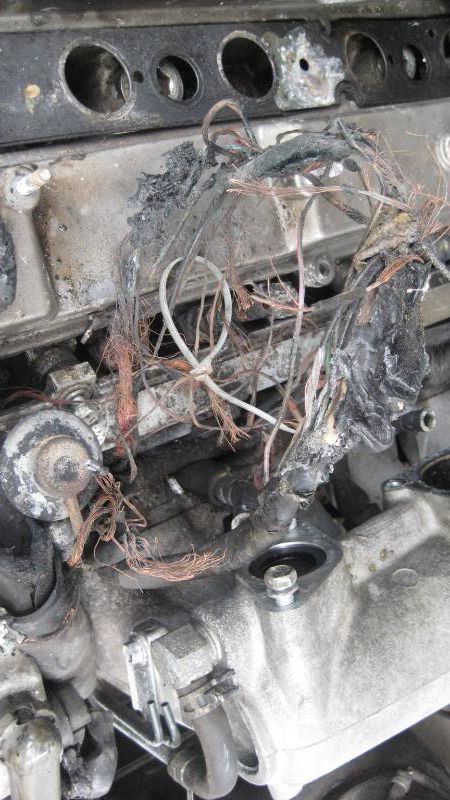

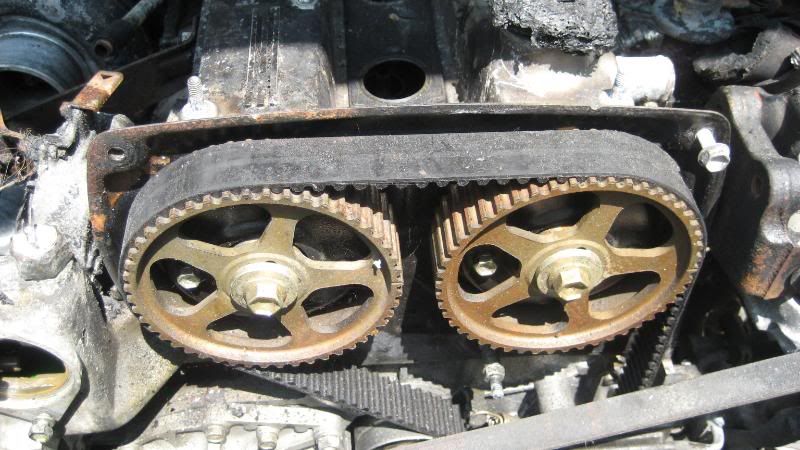

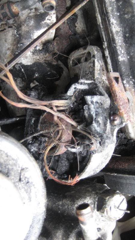

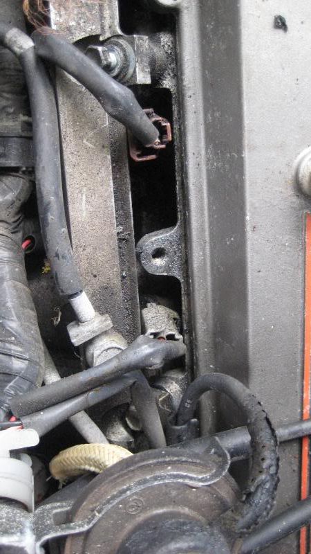

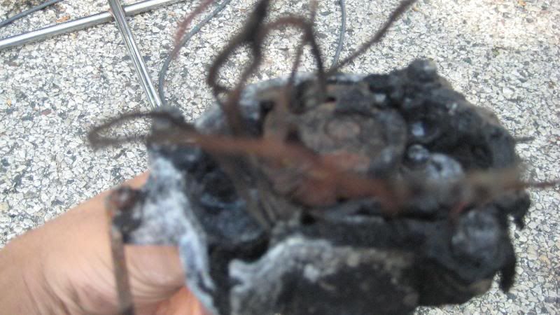

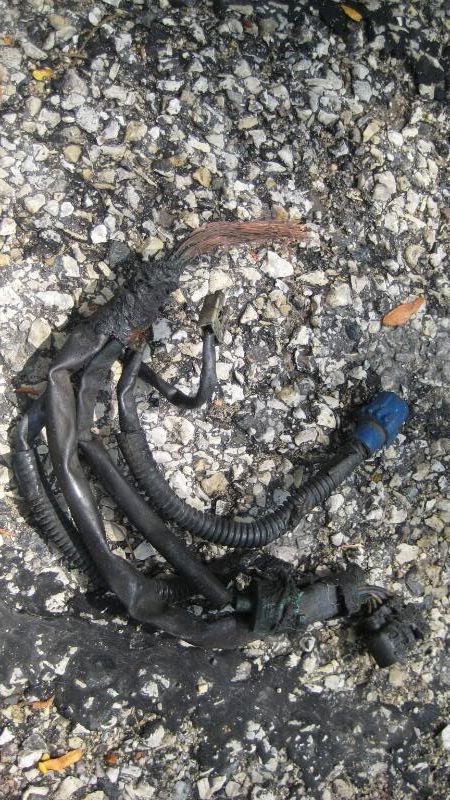

Little Updated! i got the valve covers out and everything under looks good. Wiring Harness is gone, 3 injectors are gone, the clips are gone. Some of the electronics are gone. Alot of stuff are gone!. So i m ganna need to start buying parts and start replacing them.

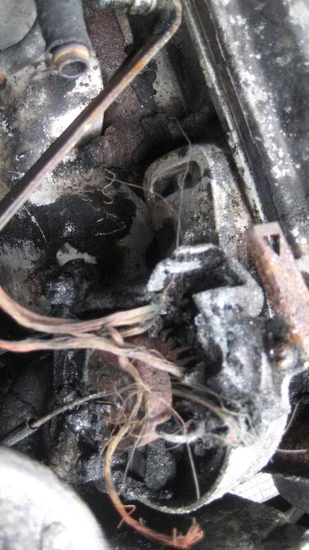

Here are pics.
part of the wiring harness which i cut of!

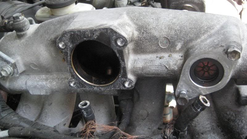

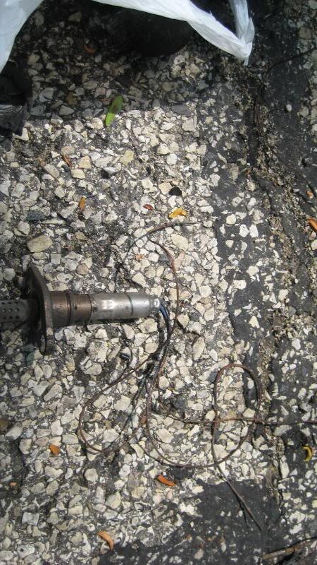

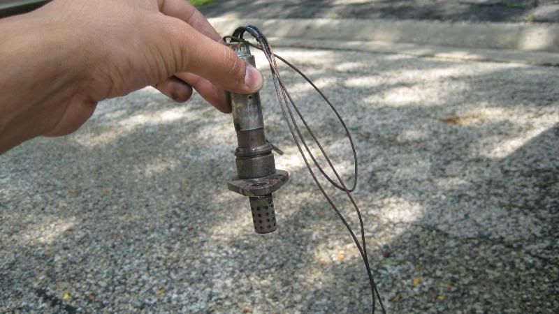

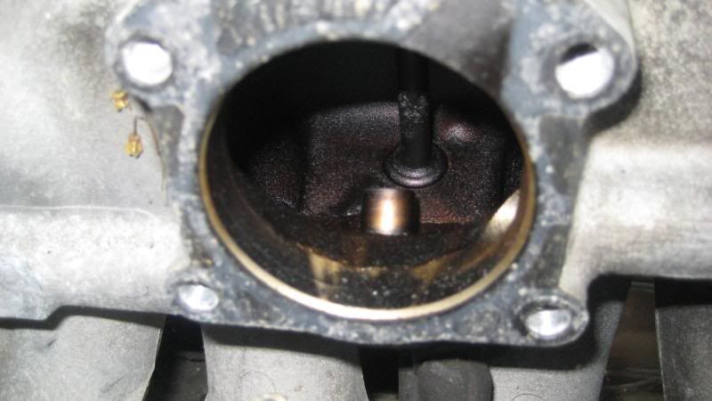

So i need parts! A lot of parts! :) If anyone here has the idle air control thing, that weird thing i was holding, that connects to the intake manifold, i need one of those, I need a distributor. I m thinking about replace the thermostat housing cause all of the clips are burned off. I still need Wiring Harness! if anyone has 89+ wiring harness, turbo 5 speed. I need it! thank you. I also need a 02 sensor.
So far i already purchase, Coilpack, Fuel rail and Injectors.
thanks for looking

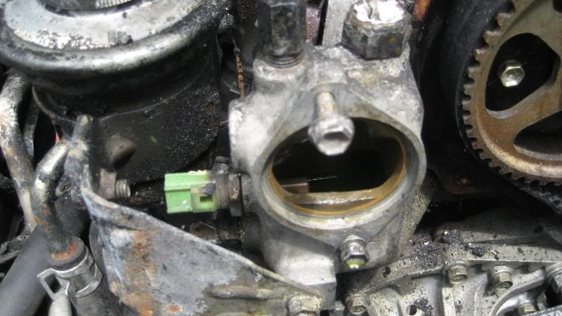

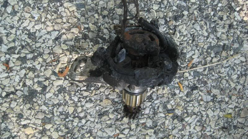

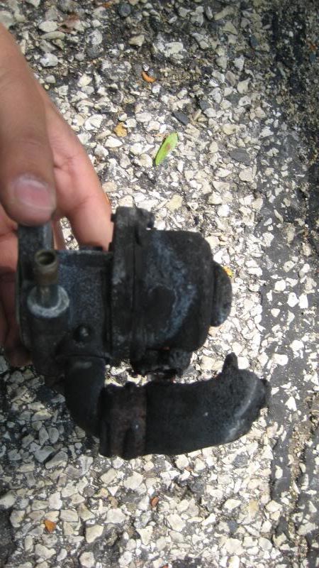

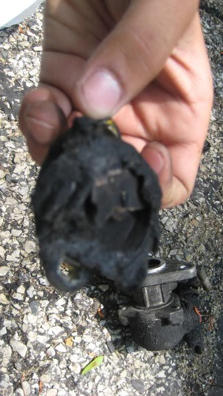

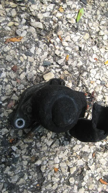

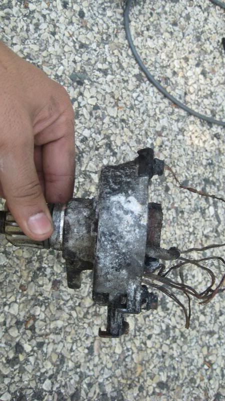

Updates!

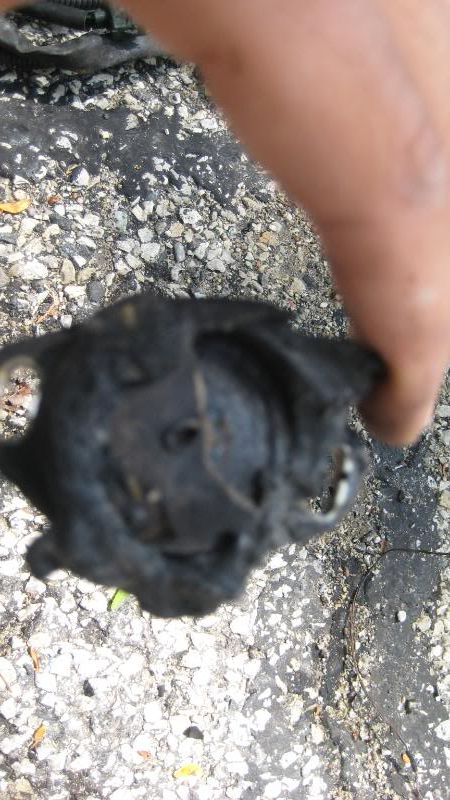

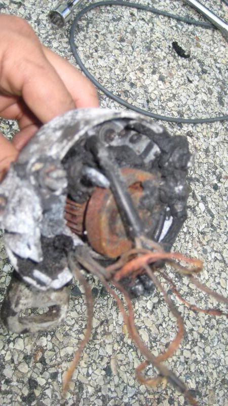

I don't know what this is called besides a sensor, but it only has one clip ?? just wondering, does it suppose to have one clip or 2 ??
This one was just melted off, found one on driftmotion

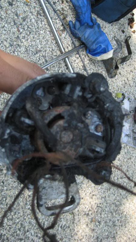

Anyone want a Distributor for their supra ?? :)

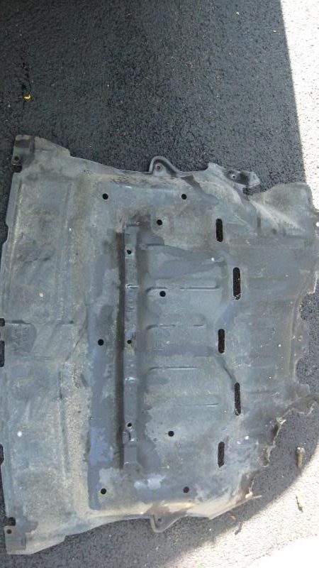

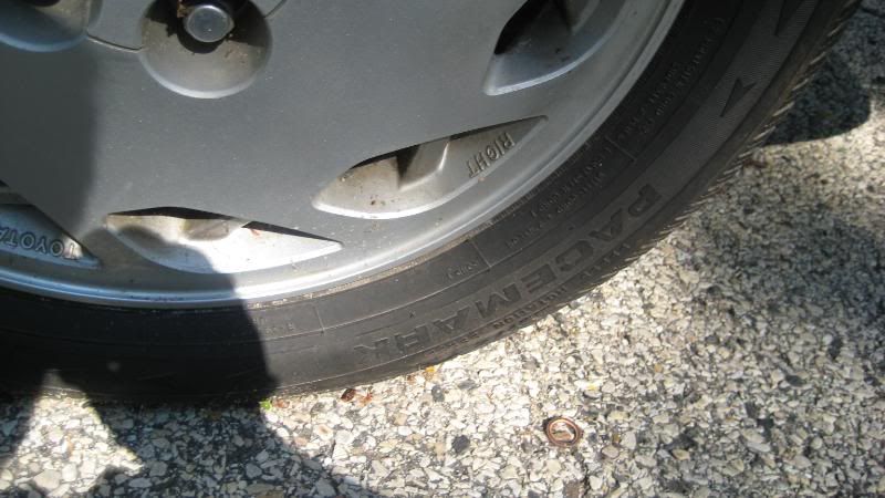

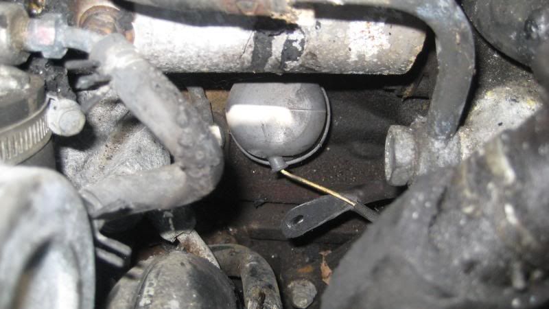

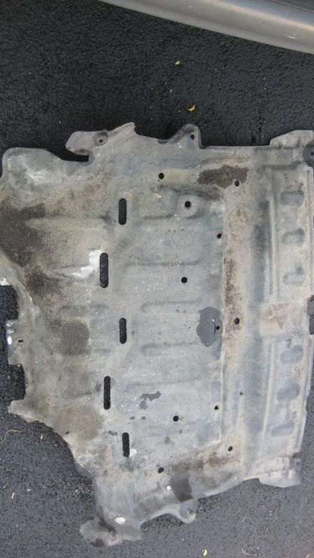

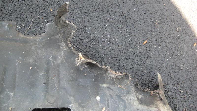

Question for everyone ?? Are these tires the original supra tires that came of the lot ??? Some brand name PaceMaker or something.

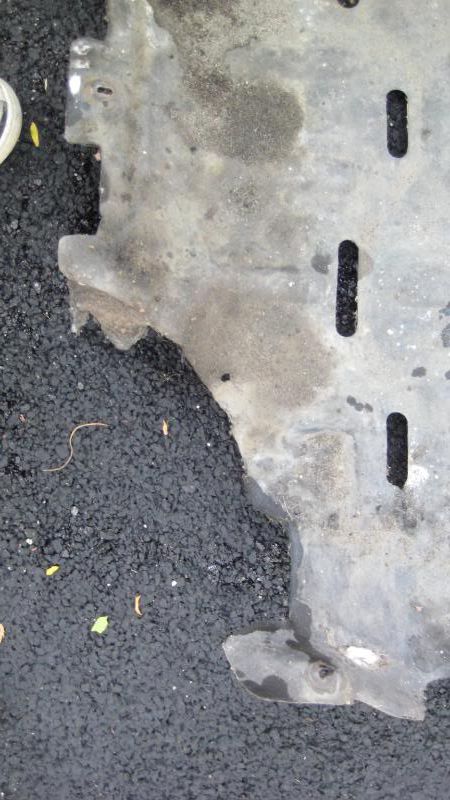

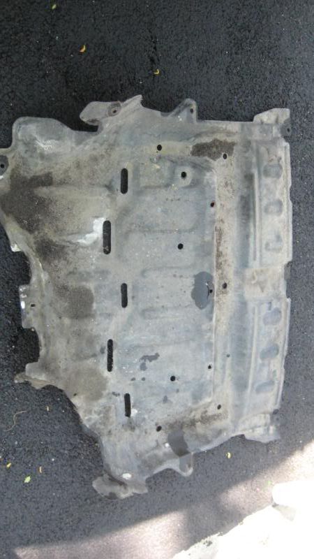

Look for i found under my car!!! :)
Except, it's torn a little on one part

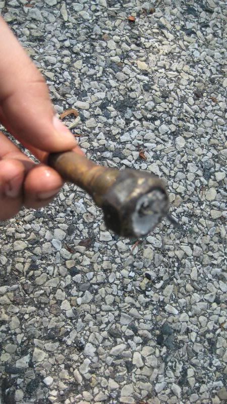

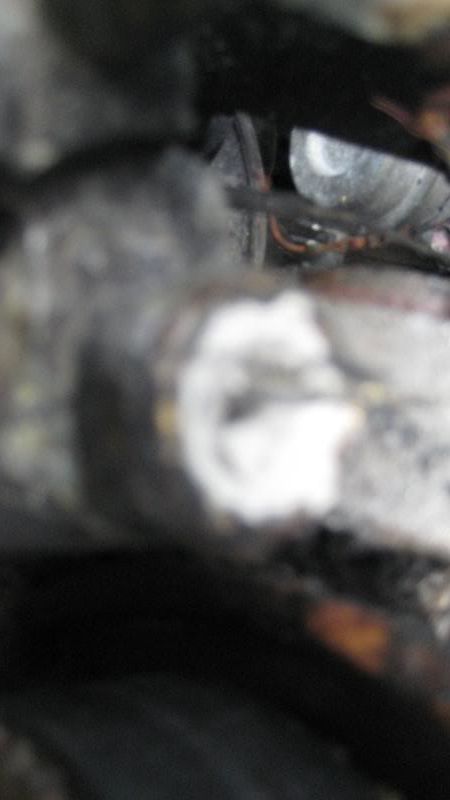

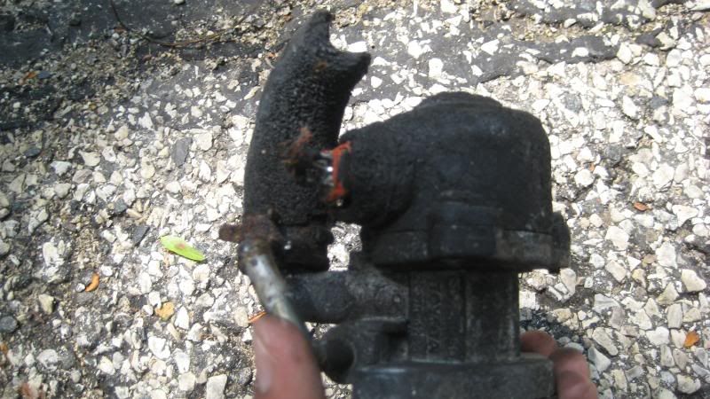

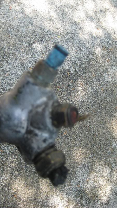

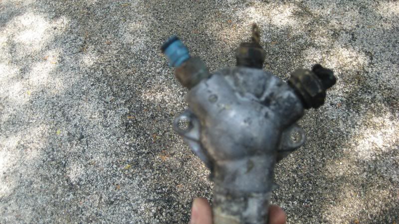

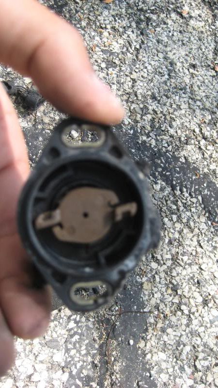

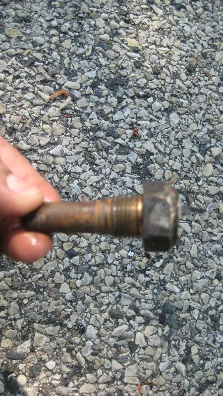

Anyone know what part this is ?? The wires was burned off that little part ?
This..
wire connected to this i think under the thermostat housing.
Thanks for looking, I m hoping to have the fuel rail, injectors and wiring harness. Three Things that need to be taken out before new or used parts go in.
This..
Pretty sure that is your oil pressure sensor (sending unit).
I have a thermostat housing with sensors if you need one. $20 shipped.
