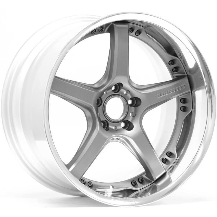

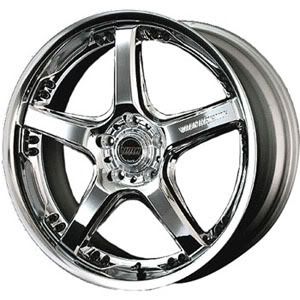

I just checked out the GT-S Wheels. I gotta say they're pretty sharp. The Gunmetal with a polished lip is sick. This is what they look like:
Fronts will be 18x8 +33 w/ a 49mm lip (They also have +27 & a 55mm lip)
Rears will be 18x10 +23 w/ a 113mm lip (They also have +23 & +38 w/ a 100mm Lip)
What do you guys recommend?

Here's a pic of the GTS in Chrome:
shaeff
Kurt is FTMFW x2!!!!
10,592
11
Around
I approve, but no chrome except the lip. (or polished)

Yeah I did a lot of searching through BorHor's Wheel Thread. I looked through tons of pictures of different wheel set-ups. +35 seems to fit pretty well.
I'm under the impression that lower the offset, the more flush the wheels will be. Therefore I'm assuming a rear offset of +23 should be pretty damn flush on a 18X10 wheel. Please correct me if I'm wrong. I'd hate to buy the wrong wheels :(. Maybe BorHor will stop by and comment.

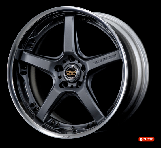

Just for reference, here's a pic of the SF Challenges. It basically comes down to these two unless you guys have some other suggestions.
Negative. Not aggressive enough, especially the front.
Roll and flare the front/rear fenders, then go with
Front: from 9.5" low 20s offset to 10" high 20s offset
Rear: from 10.5" mid teens offset to 11" low 20s offset

ForcedTorque;1209753 said:
I like the middle picture........A LOT!!!!!!
And, I believe we are supposed to stay pretty close to a +38 offset
The top and middle rims are the same color.
Yes, +38 offset for:'
- unmodified fenders
- wheels 8.5 front and 9.5 rear
More people ought to step out of the comfort sizing zone by:
- modifying fenders
- wheels 9.5 and bigger front, 10.5 and bigger rear
- modifying fenders
So you're saying a 18x10 wheel with a +23 offset and a 113mm (4 1/2 inches) lip isn't aggressive enough? My main concern is having everything flush, or as close as possible. I really don't care about "aggressive". I hear what you're saying and there's no doubt in my mind it will look great, but I don't know if I wanna go that route. Plus I don't have any experience with rolling fenders.
Unfortunately Volk doesn't offer an 10.5" wheel. It's either 10 or 11 inch. An 18X11 wheel either comes with a +15, +25, or +38 offset. You can see the combinations they have here:
http://www.upgrademotoring.com/wheels/volk_racing/gt-s.htm
I appreciate the advice. Please keep it coming.
Mo
Most MKIII owners are conservative when it comes to wheel fitment. "Aggressive" is relative and so is "flush." Some people will consider a wheel setup agressive and some will think it's weak. Some may call a setup "flush" and others may consider it "sunk in." Why don't you post a picture of what you consider flush, so that others could help with pinpointing width and offset? As far as rolling fenders, for best results, you'll need someone to roll your fender with a fender roller; don't use the baseball bat method.
I don't have any add-on fender flares. Just rolled and flared fenders. I run
9.5+23 front (235/35/19)
10.5+18 rear (265/30/19)
I think the setup above is still relatively conservative, after the rolling and flaring.
I have 5 more pieces of advice for you :naughty:
1. Volk Racing comes in 10.5" sizes
2. In today's fitment game, depending on how you want your setup, you make the car fit the wheels, instead of the other way around.

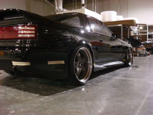

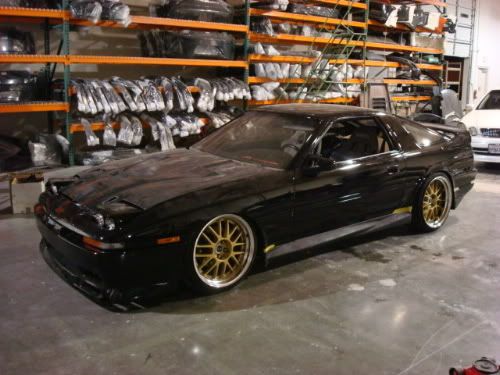

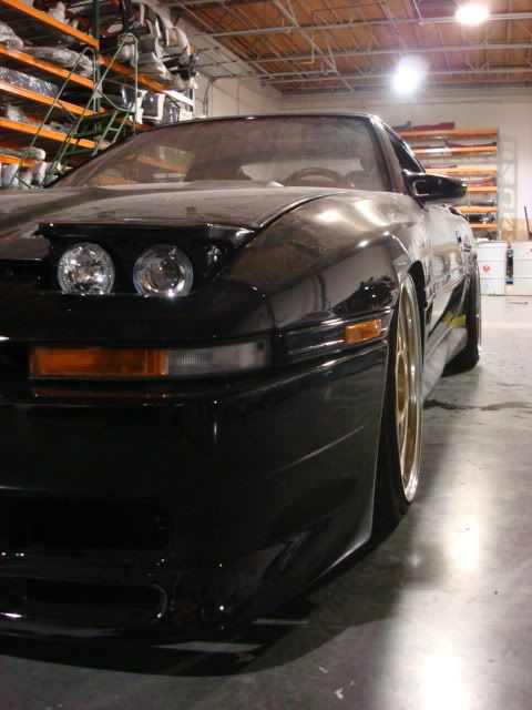

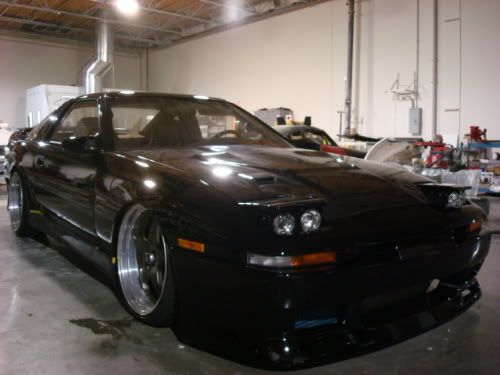

Here's a friend's car with fender rolling, but no flaring. Work Meister S1 Matte Black: 19x9.5 +24 /19x10.5 +23
Here's my car with fender rolling, then flared about 1", so I'm able have a lower ride height.
19x10+30 all around
Front are 9.5+24, rears are 10.5+18. I actually was able to fit fit 19x11+18 easily at the rear (no pic though)
