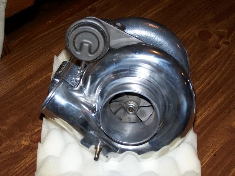

-Frankenstein 5 Greddy TD06-20g (Garret E60 Compressor Wheel, flows 750 cfm--Polished Compressor Housing, Ceramic Coated Exhaust Housing)

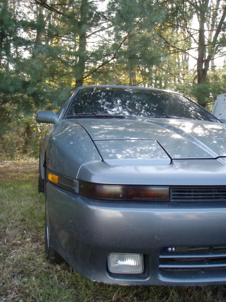

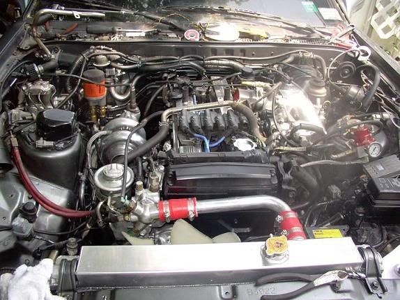

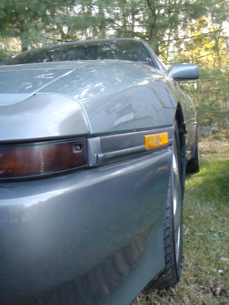

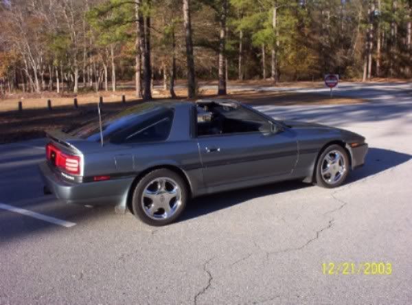

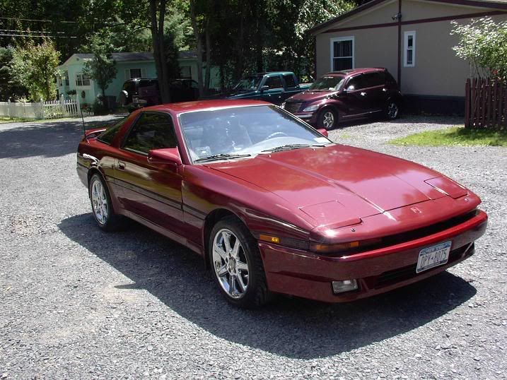

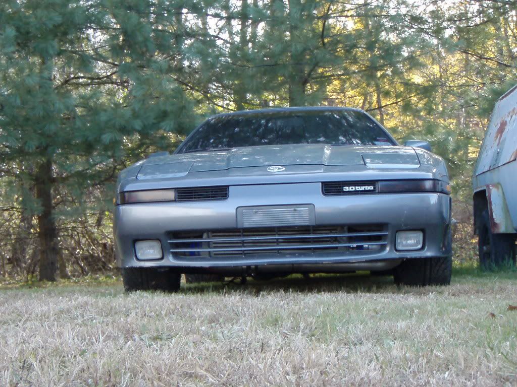

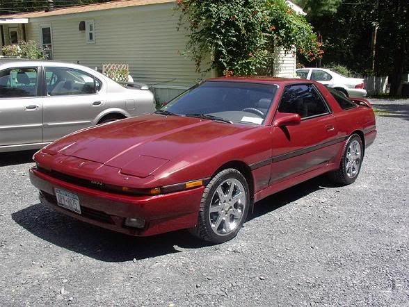

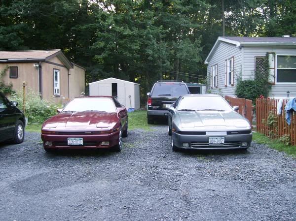

Here are a few pics. I finally opened a photobucked account so it might take me a while to get all my pictures uploaded. Hope you enjoy them.

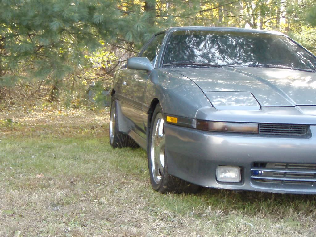

Update: 3/20/09
The car is finally done getting painted. You can see the new pics of Pgs. 6,7, & 20. It's dusty, but overall it came out well. I didn't pay top dollar, however, I paid enough to know how I wanted it to turn out.

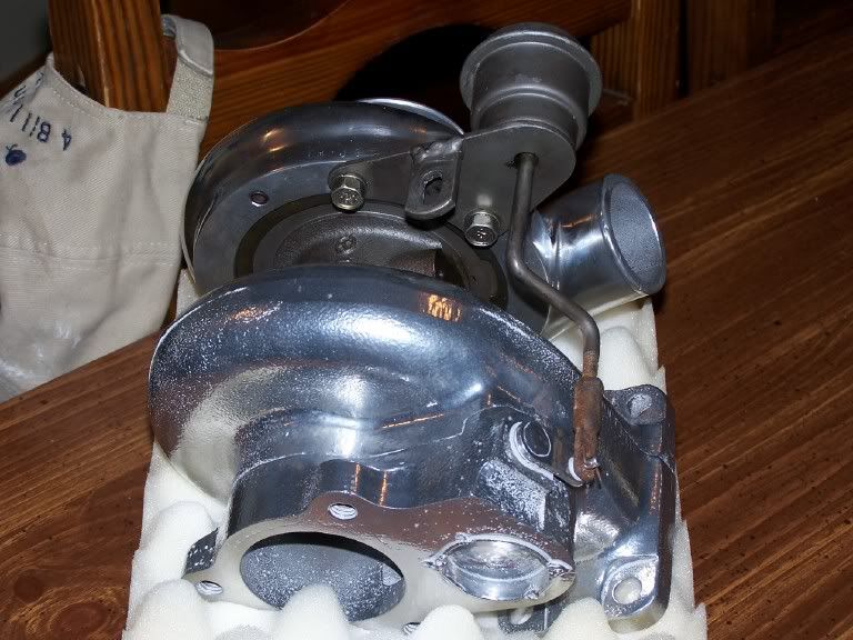

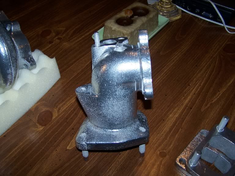

I also just purchased an HKS T3 Tubular Manifold so I can finally get rid of the restrictive stock manifold. I'm also going to be purchasing a set of electric fans from Adrenaline in the next week or so. All that is left is to plumb my oil system and get her tuned. I am picking it up tomorrow (3/21/09) and will begin work immediately. Stay tuned.....
Pics of the manifold. It will hopefully get getting ceramic coated very shorty :biglaugh:

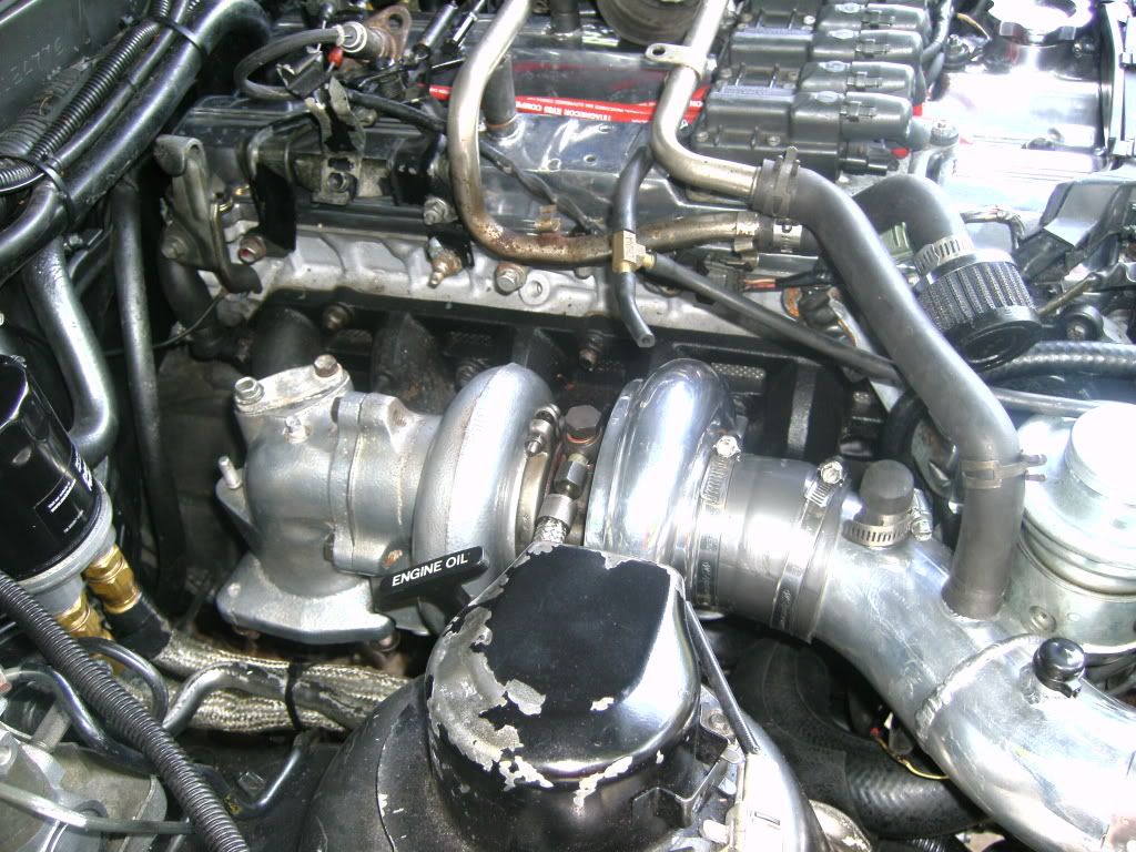

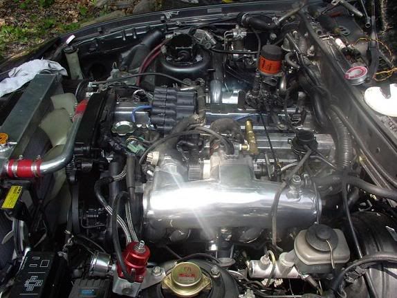

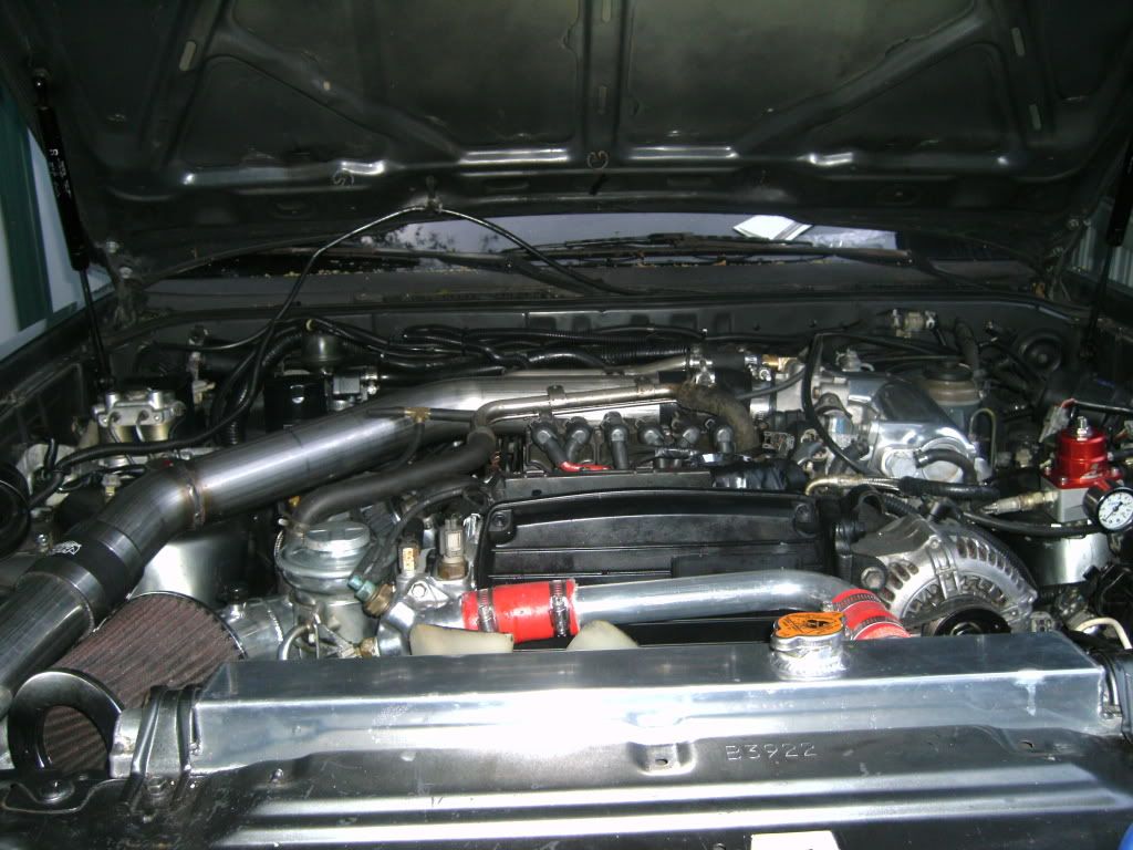

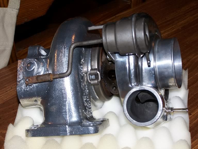

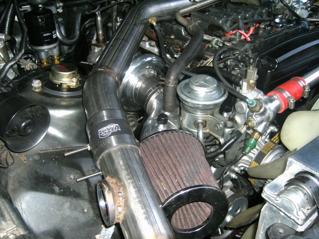

Here's another old pic of some of my parts. I sold the safc2 for the maft-pro. I also sold the authentic Bomex lip for the Do-luck front bumer.
JDMMA70
Dec 4, 2006
2,550
Houston
Man that turbo looks sweet im running on a standard 20G any videos of your car doing some pulls. Car looks great. Nice job!
Mo87NA
1987 7M-GE & 1991 7M-GTE
778
8
Upstate NY
Thanks Emp. I've got to take some more recent pictures. These are mostly old. I want to do a lot of cleaning to the engine bay. Get rid of most of the wires and make it much more "clean" looking.
I can't wait to see how its going to look with a new paint job.
