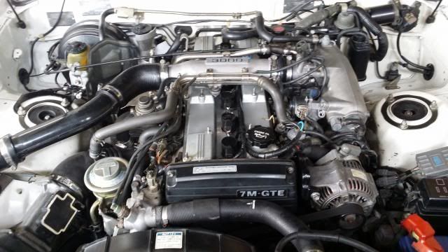

Coil number 4 had to be rotated to the exhaust side 120 degrees to clear the inlet cross over pipe. The alloy plate is 3mm.

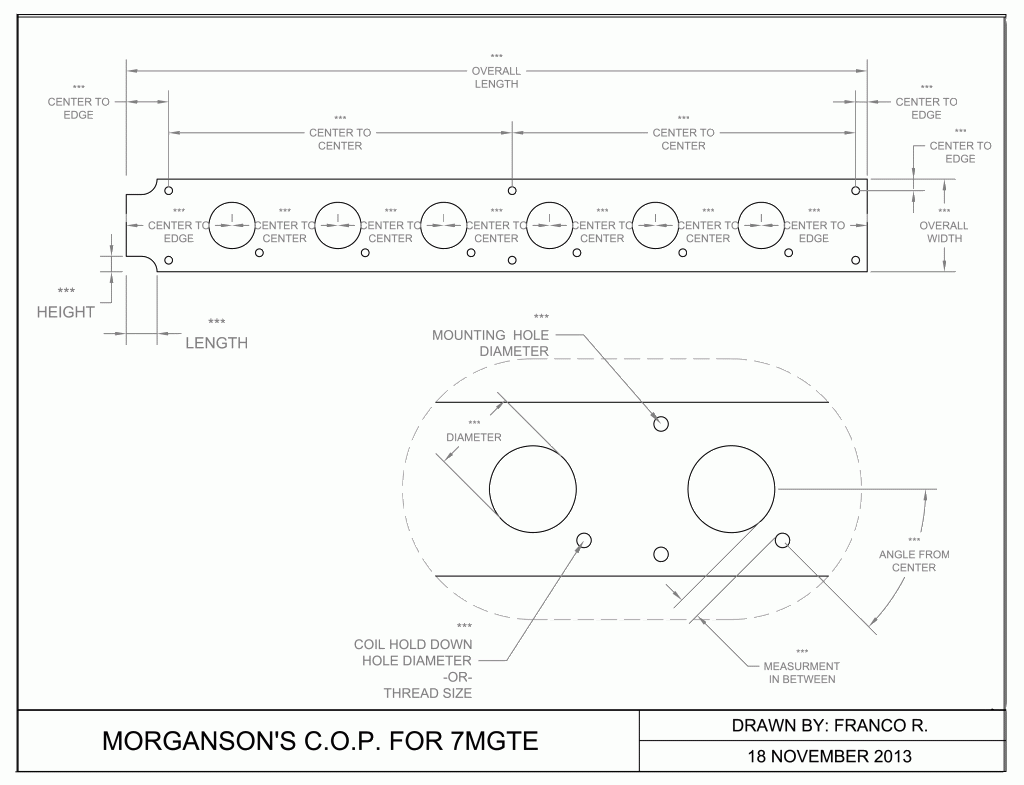

Well the company finally sent me the quote for the plates. $6200 for 20! Soooo unless nobody has a problem with paying 300 for just the plate. We are going to need some more options.
Do you have a drawing of the center piece that you need? There are multiple machine shops around me with water jets so I could get some quotes to get some center plates made for u.
morganson
Jan 19, 2012
274
Columbia, SC
Don't have a drawing. The whole thing was done free hand. But I can send you a picture of the unit. I need to make another so I can have one to send off.

morganson;1976029 said:
4140HT is what the estimate said. This was one sided i didnt get to choose anything or talk to anyone. Just emails.
lol.. Cute. They want to use a tool steel for a simple cover plate.
7075 or 6061 T6 aluminum would work fine. Not to mention a machine shop won't charge as much to machine 6061 as 4140 PHT. It's so much easier to machine so the machine time is less, cost is less.
If you take a few measurements I'd be happy to create a CAD file most shops could use for a CNC or water jet.
I would need you to fill in all the spots with the 3 stars.
