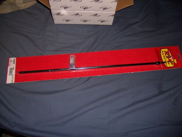

first is the big block chevy dipstick i bought. i dont like the 2 piece 7mgte design and this is long enough i can bend it and mount it behind the power steering reservoir bracket to make checking the oil easy. once mounted ill make a new notch on it with my dremel so i know where full is.

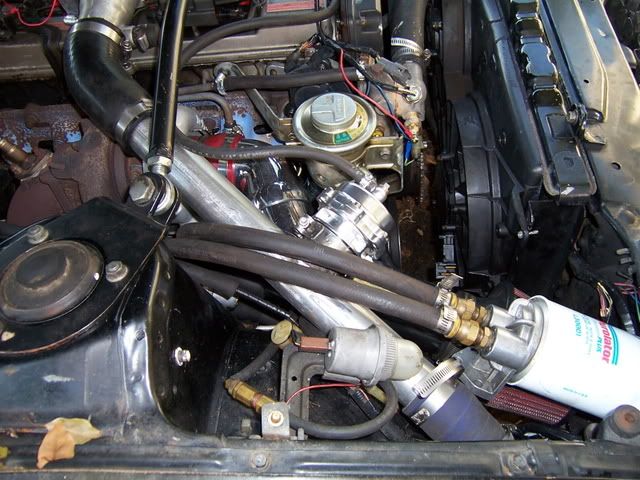

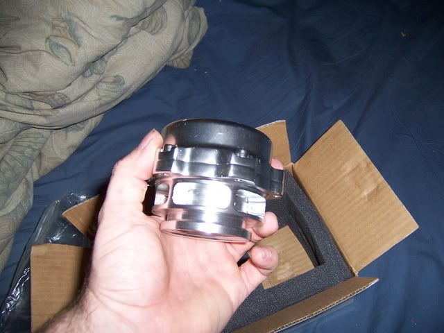

next is the polished 50mm tial knockoff bov. i took it apart and greased the center rod that slides into the upper piece to be sure its going to work nice and smooth. got the flange welded to the pipe now but havent had a chance to put it in yet. was busy working on my friends 75 celica all weekend.

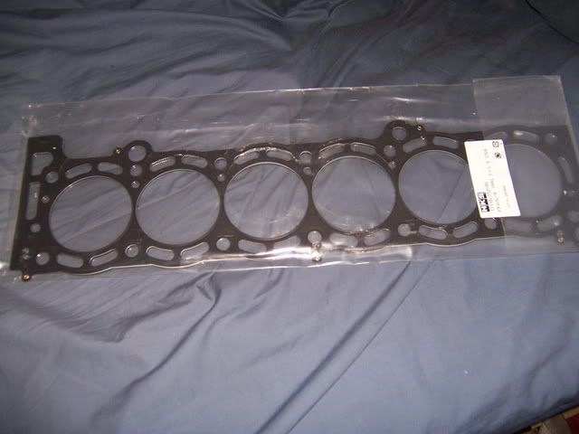

also ordered a summit fan switch, 185 on, 170 off. dont have a pic of it but it came in thursday. still waiting on my new turbo manifold, hks 1.2mm mhg for the engine im rebuilding and the aluminum radiator as well.

pics of my new blow off valve installed. still need to pull it off again and paint the pipe black.

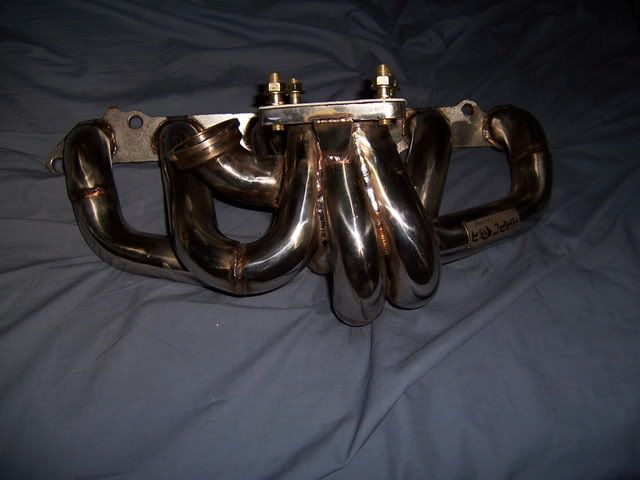

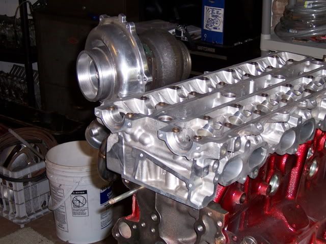

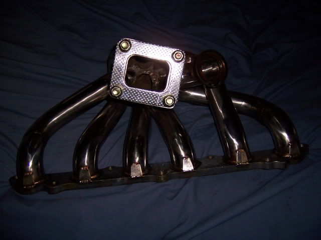

and my new turbo manifold that came in today.

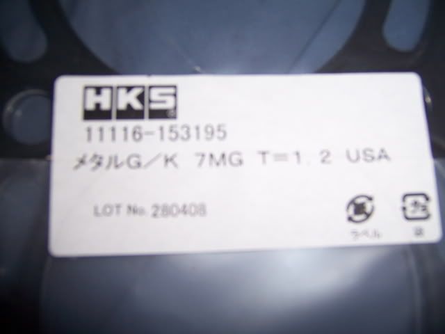

and my hks 1.2mm mhg that came in today.

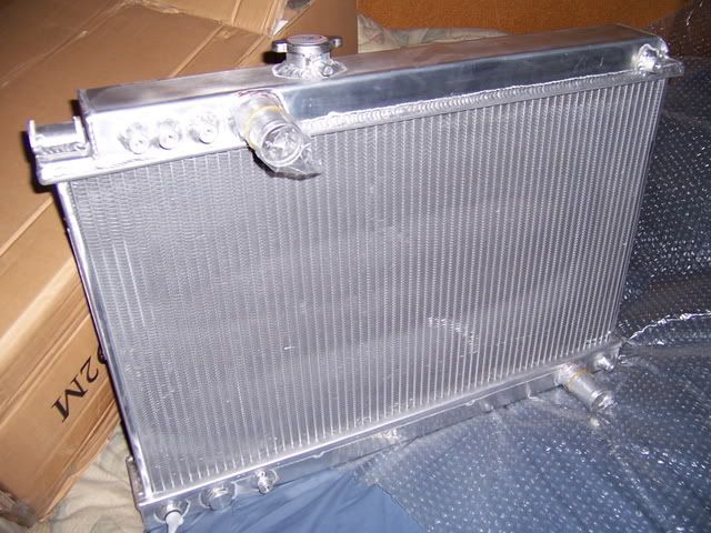

still waiting on my aluminum radiator.

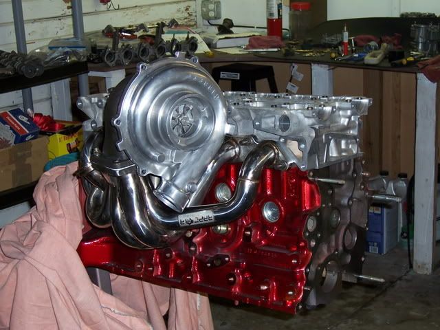

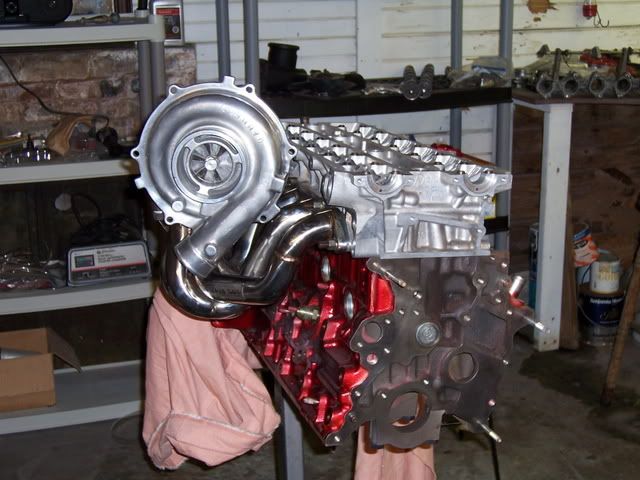

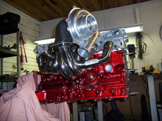

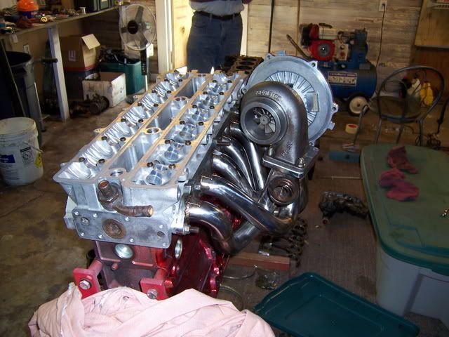

the t3d
P B4 A
Sep 30, 2006
839
Titusville, FL
that turbo is MASSIVE!
what kind of oil relocation kit is that?
i love your MS setup. i was actually thinking of going that route, but i'm still not sure
-t3d
williamb82
Apr 24, 2005
906
4
Tampa, Fl.
turbo isnt massive. prolly the best street turbo for me though honestly. its a garrett gt4082 with 0.68 a/r turbine housing.
as for the oil filter relocation kit. its one for a 5.0 mustang, bought it at automotive engineering on us19. lol. i didnt mount it where i want as i plan to replace those push lock hoses with ss braided lines and reusable fittings. that way i can plumb in my rx7 oil cooler as well. once i have all the lines and stuff to do it i will. hopefully soon. trying to get the fittings and stuff to do the oil lines for the new turbo first so i can route the relocation hoses so they wont interfere.

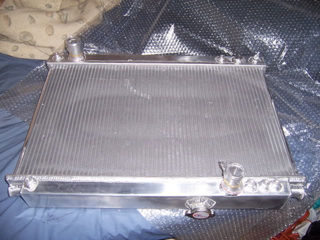

got my radiator in finally. was supposed to be in yesterday. now i need to dig out the mk3 mounts and lower rubber grommets. its a mk3 radiator and i have the lower radiator mount that dave did a group buy for like a year or 2 ago. lol
