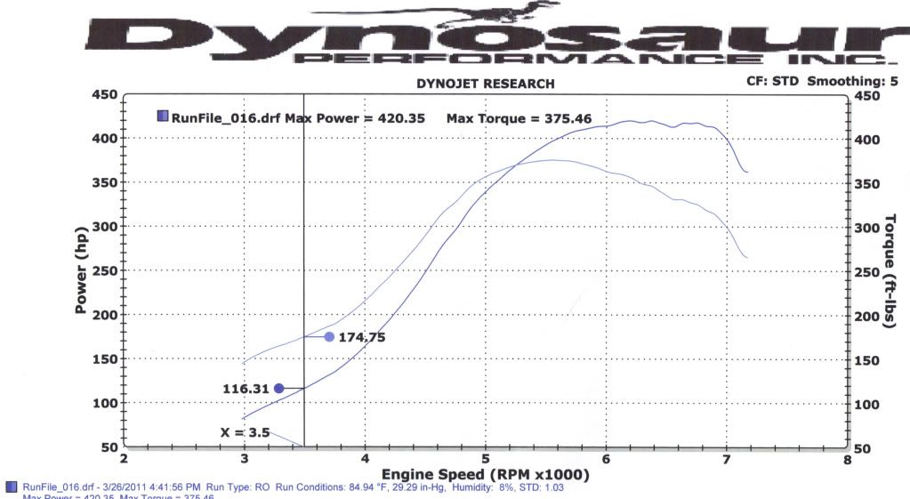

Made 420WHP at 23PSI ran out of fuel. Was on 92 octane pump gas. Got to start looking at how to break 500. Tuner said with a Bosch 044 Pump and Race gas i could Defiantly break 500 but i don't want to mess with race gas. Im am looking in to my options. Car is currently running at 385WHP at 14psi but getting the boost controller installed and will crank it back up.
Mods: Garret 67MM Turbo, AEM EMS, HKS EVC-S, AEM Wideband, PTE 1000s, Top Feed Rail, Walbro 255, Aeromotive AFPR, AN-6 Feed, 4" Intercooler, 3" Intercooler piping, Full 3in Exhaust, Tial MVS 38mm wastegate, Tial Q 50mm Blow off Valve, Flex-a-lite 220 electric fans, ACT HD 2600lb pressure plate, ACT Street Disc, Light weight flywheel, Driftmotion Polished Aluminum Pulley Kit and some other little things

Good numbers for pump gas, you will need another fuel pump for sure, also ensure that your coils are in good shape because if they are in bad shape it will cause spark issues. I just went through all this with my tuner, I just ditched the stock coils and went with the 1zz coils and currently I am installing dual fuel pumps, I have similar mods but I an running a stinger ecm and BC264's with a T66. I myself can't wait to get back on the dyno and I plan on running E-85 fuel.

you should be able to make better numbers than those.. a lot of folks manage ~450whp @ 18-20psi on a decent tune. that's with stock head..
also, I'm not sure why he told you race gas is needed (-more like preferred for safety).. 500whp is possible on pump (93 here), but it takes an aggressive tune, and a tuner that really knows what he's doing. In all fairness, my buddy did 506whp w/ PowerFC, but any more than that would have required race gas. The only thing I keep wondering is how hot the timing and AFRs were when he managed that power, they might have been a little too close for comfort.
In any case, the car ran fine at those power levels on that tune for quite some time before he had to sell it. Then again, it was also rebuilt right before that particular setup.

Update .....Yes i should have made 420hp at 18psi instead of 23psi. My compression is shit 125-110 range on all 6 cylinders. motor came out the car last night and the head is coming off to day. Its rebuild time.
