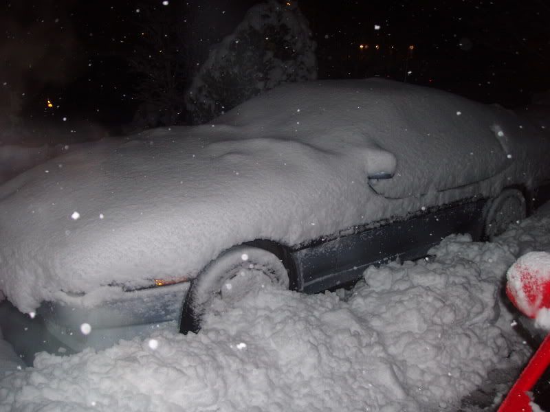

Can't do anything to my supra for a while.

DAMN YO!
park that thing in the garage.
You guys got a lot of snow out there.
